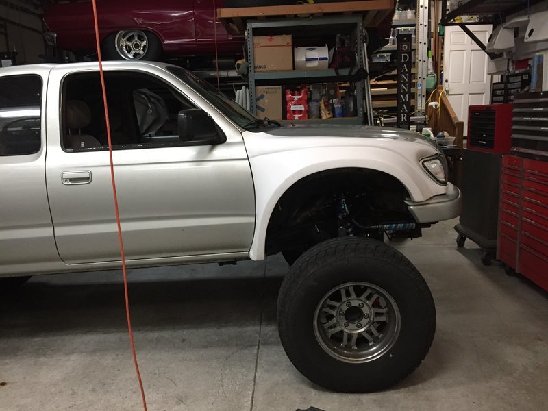

    Damn she's tall :laugh:

    What size coilovers are you using? Also it looks like its really high. How much does it take to jack the front tires off the ground?

    Coilovers are just 8s.
    Takes a standard floor jack +8" to get tires off
    Ya she sits way too high, hence the fitting change so I can pull rude height out

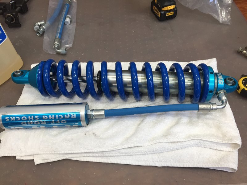

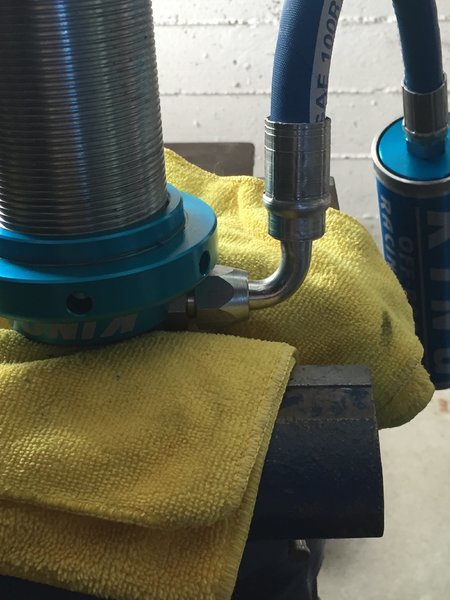

    Time to get this back together. Finally fixed the fitting that hits the coil nut

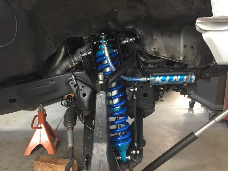

    One side ready for reinstall. This is way easier than I thought it would be

    Side one done

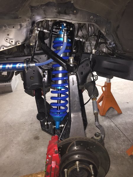

    And side two
    Hoping I set preload correct so it sits even

    Little lower, without going to a lighter spring I don't think it's coming down any further as there's no preload

    What Springs are you running

    300-18-600
    EDIT: If they dont settle down a bit I might look into getting some 550lb coils

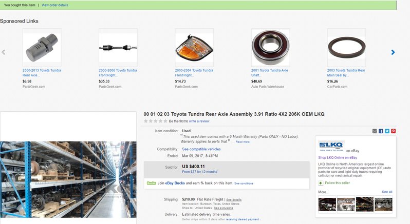

    Yes, but a wider axle is needed to install it and I havent been able to track one down cheaper than about $750, but might be worth getting sooner than later

    That's what I'll be going with; as drunk me ordered a tundra rear end last night
