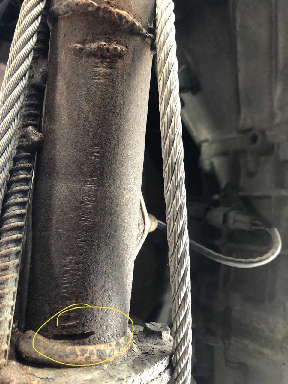

    I couldnt tell if this cut was clean though the exhaust pipe.. I am attempting to test it using some High Heat JB Weld.. i hope that isn't a mistake ?

    Ah air compressor! I like that idea! I dont have one available. I am hoping that little slice just before the cat is the culprit.

    There’s usually some black soot around leaks. It’s hard to tell with that one, but you could just run the truck and hold your hand near it and see if you feel anything. The larger leaks are easy to find.

    i put the high heat jb weld over that little gash.

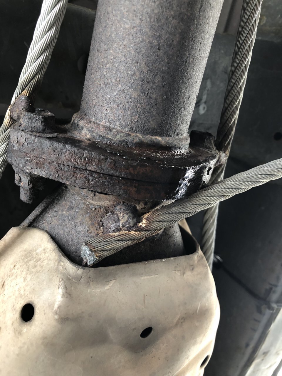

    I did notice (not sure why i didnt have it on saturday) this leak coming from gasket I presume.
    It isn't supposed to be wet like this is it?

    Yes, it does look like that gasket is bad.
    The thing with the sensors, is that they can test ok, but might not work. I know the sensors are expensive, but replacing them with Denso/OEM (these sensors are brand / quality critical, cheaper ones don't work) would be the next step once you've ensured that the exhaust isn't leaking.

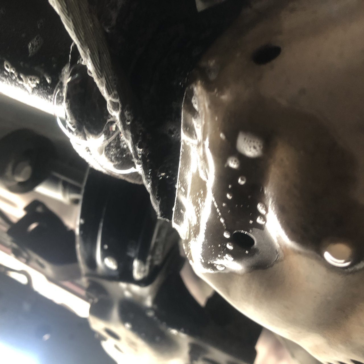

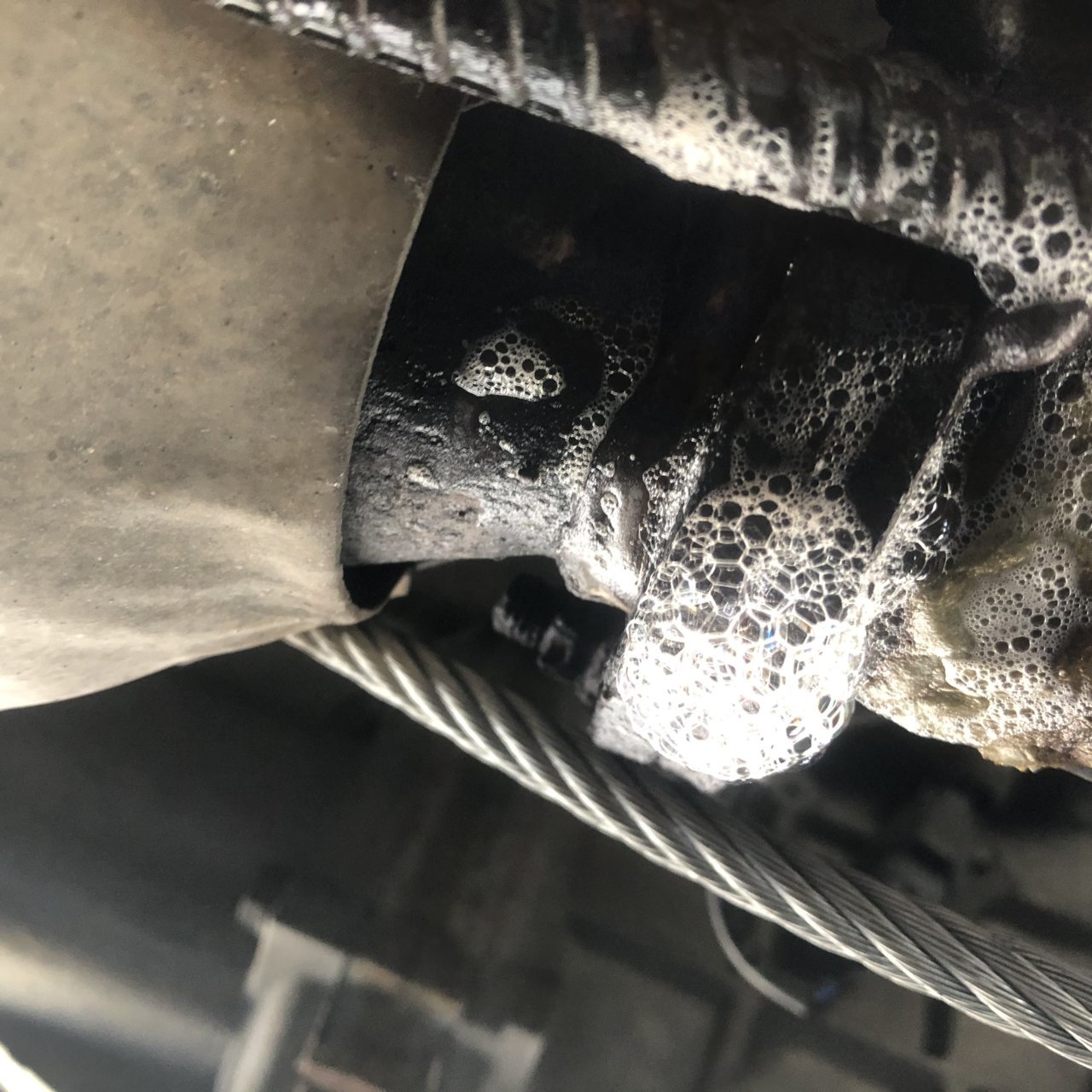

    I put high heat jb welt over that cut.. but from the looks of the photos i took using a shop vac and soapy water..there are alot of bubble around that jbweld "patch"
    I also sprayed soapy water on the gaskets and they blew some big bubbles!! really big! i didn't have much room to get a better shot..the curb was in my way so I and to really squeeze underneath .

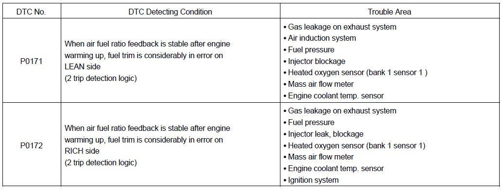

    The EGR valve can get stuck, especially with all the oily gunk that makes its way through the PCV valve. Did the EGR get replaced? If not, that is probably the cause of your problem. Sometimes you can just clean them, but at that point and the age of it, it might be worth it to replace it. There are also a bunch of vacuum lines that run to it, and at about 15-20 years of age they start to break down and fail. Leaks on these can actually cause the EGR valve to not function, so it could be as simple as replacing those vacuum lines. This is why your mechanic said they are hard to diagnose.
    This is most likely where your problem is. Small leaks on the exhaust pipe will not typically cause P0170. Are you sure that was the code? It wasn't P0171 was it? The Factory Service Manual actually doesn't list P0170 as a fault code, just P0171 (system too lean) and P0172 (system too rich).
    P0170 is for fuel trim malfunction. There are many things to check, not just exhaust. Have you checked your MAF? I know you are responding to this code because of the theft attempt, but it could be a coincidence. You still want to solve your exhaust leaks, but it could just be one part of the problem and sent the fuel trims over the edge that threw the code.
