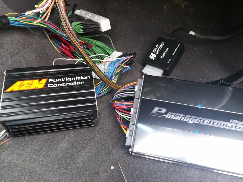

    Enter the EMU, why? Being a EMS geek following a lot on the interwebz, saw a Canadian tuner post up very strong evidence how the EMU seemed to have more accurate timing control over the FIC-- they go about it very different ways, the FIC simpy intercepts and offsets the cam and crank signals like older piggies, but the EMU intercepts the IGTs along with cam and crank. I suppose the OE ECU does a little bit of calculated guess work on timing and so there are windows of time only using the cam and crank to affect timing is not that effective- anyhow, my 5vz being the ping whore that it is, I wanted a little more accuracy, second is you can advance timing with the EMU-- get some MPGs back from using 91 octane all the time (5vz ECU does not use knock feedback in low revs so does not optimize timing like many more modern cars) and third (but not least), the EMU has an A/T shift feature, something I was craving after getting ping during shifts and finding out Toyota ECUs advance timing during AT shifting, the EMU can retard that when properly setup.
    But a big problem, the EMU does not have built in o2 sensor feedback control, and for a little while they did make a very expensive add-on box that did, but discontinued it. But I had an EMU sitting around and finally said fug it, got a split second to take care of the o2 sensor issue and would tune around it with the EMU-- IMO a sin many tuners likely try to avoid as it adds complexity, but I wanted the EMU bad.
    First couple of custom maps didn't start it up, so I loaded a known working map for a 2jzge, cranked, it started, and I have worked from there.

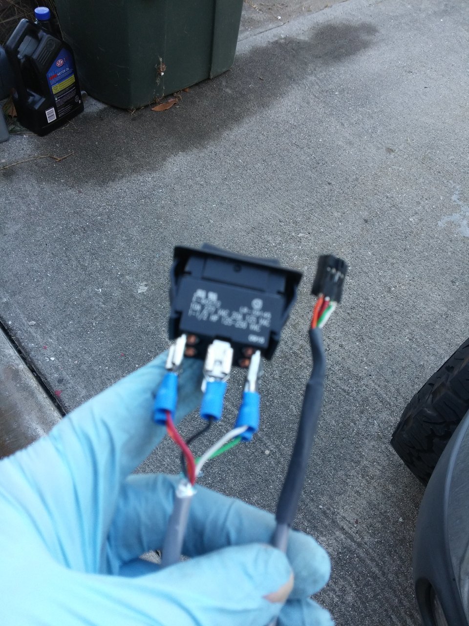

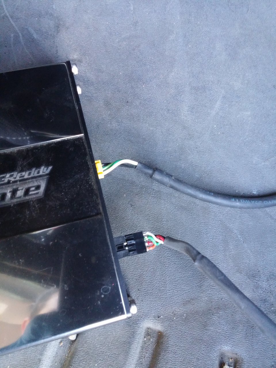

    So to shore up some of the EMU shortcomings, I de-soldered a microswitch setup on the board so that I could solder on a header and harness so that I can use a three position OEM looking rocker switch to switch between fuel and timing maps to retain a 91 and E85 switching ability.
    Initial impressions (just slapped the EMU in a few days ago, did just a little driving)
    - EMU cranks/starts faster.
    - Does suck to have to play with split second settings via rheostats, not having it all in one software setup.
    - no need to add resistors, IMO the EMU is being more accurate with signals-- the truck just seems that much more smoother, tip-in is back to what it was like OEM, ping already seems less frequent even with less aggressive timing retard and fuel enrichment- but could all be placebo.
    - overall really happy because I had been meaning to do this for a very long time, finally put the foot down and did it.
    I still need to wire the a/f gauge output to the Greddy, tune the split second some, and do LOTS of logging to dial things in and hopefully get the A/T shift feature fully doing it's job.
    Its the most expensive piggy option for the 5vz as the EMU is already pricey, and you have to add to that the Split Second-- but IMO you get what you pay for, I am controlling 625cc injectors flawlessly, starts and runs great, no CEL-- it is one of THE most modern piggies out there even though there are piggies that are getting much more development now, IMO they still don't stack up to the EMU. I didn't consider the MAPECU when I saw it still tunes fuel via MAF signal manipulation, IMO to be considered a modern piggy you need to do two things:

    IMG_20171119_153031.jpg IMG_20171119_153840.jpg finally mounted the emu behind kick panel and installed the map switch mod so I can switch between e85 and 91. Oh and ran the option 2 harness so with a quick solder the emu will get aem wideband input- with the emu this isn't just good for logging, but you can enable a closed loop air fuel target map in the emu as well*
    * don't enable it in closed loop ranges, or you will have the battle of ECUs on your hands
