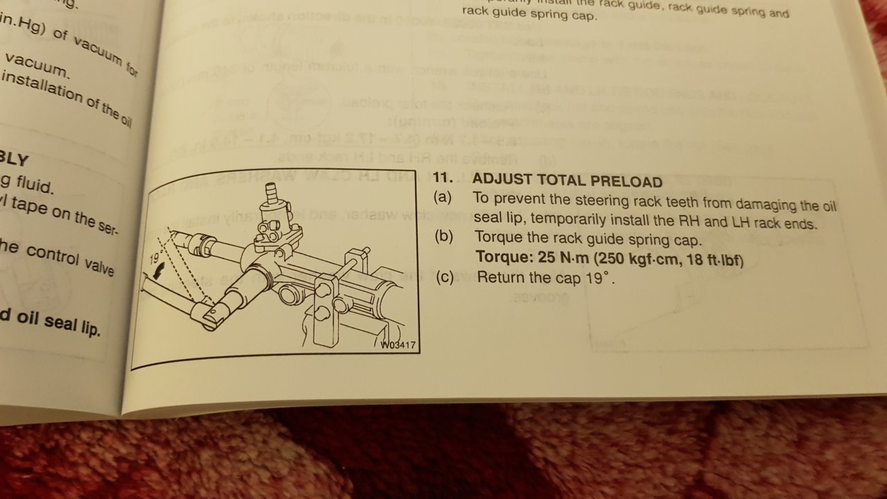

    The following thread shows how to adjust the rack guide. For your year you should have the newer style guide as shown in the thread below. Easiest way to tell is the guide cap will be a socket head hex.
    Don't know if you got a new OEM steering rack or a reman. If the latter it's possible you could have got the older style which will have a hex head cap (not socket) and is the roller style guide. No idea if the tightening procedure is the same for the old style. (For the newer style guide)

    So all I got to do is loosen the hey bolt a lil bit???

    No it doesn't work that way. You loosen the the lock nut, torque the guide cap to 18 ft/lbs, then back it off 19°, then retighten the lock nut.
    Keep in mind....1/4 of a turn is 90°, 1/8 of a turn is 45°, 1/16 of a turn is 22.5°. So slightly less than 1/16 of a turn is how much you want to back it off. Can use a protactor to make marks for 19°. If you don't have the proper tools, that's up to you if you just want to loosen it at random. Too loose & you'll have sloppy steering. Too tight you'll wear out the guide & rack prematurely as well as tight steering.
