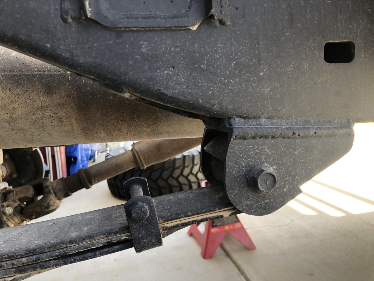

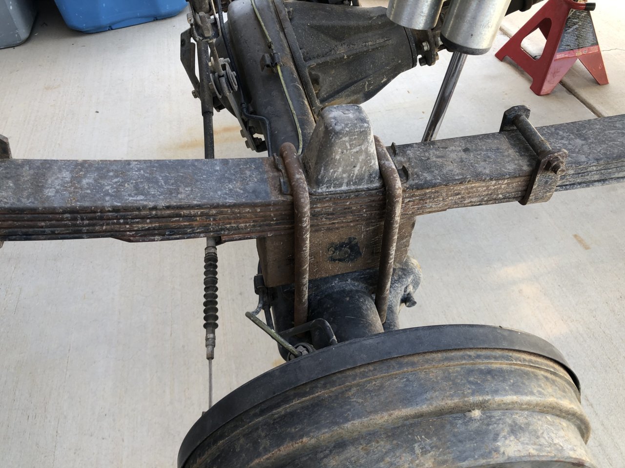

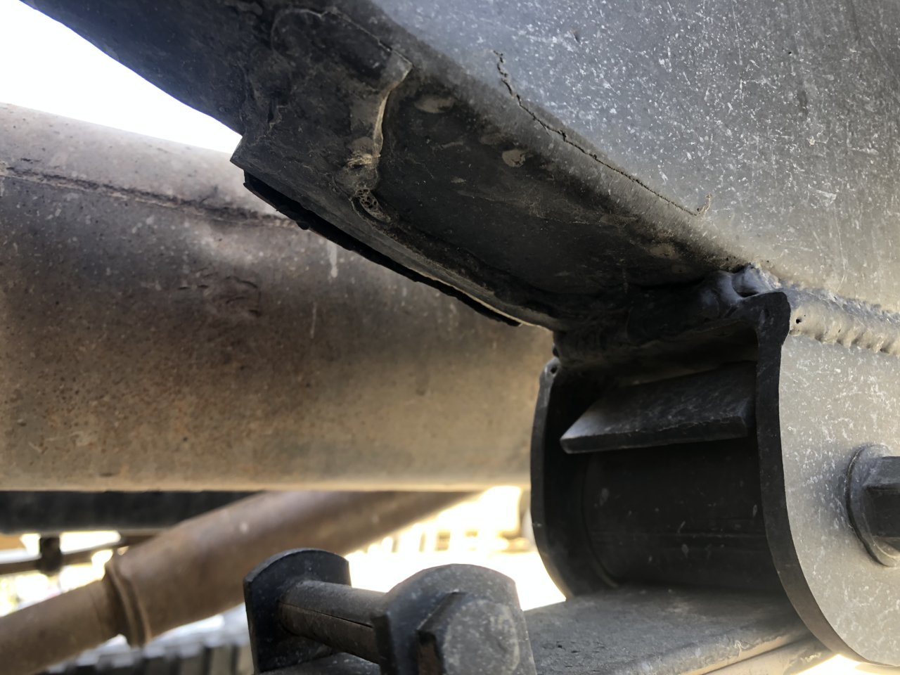

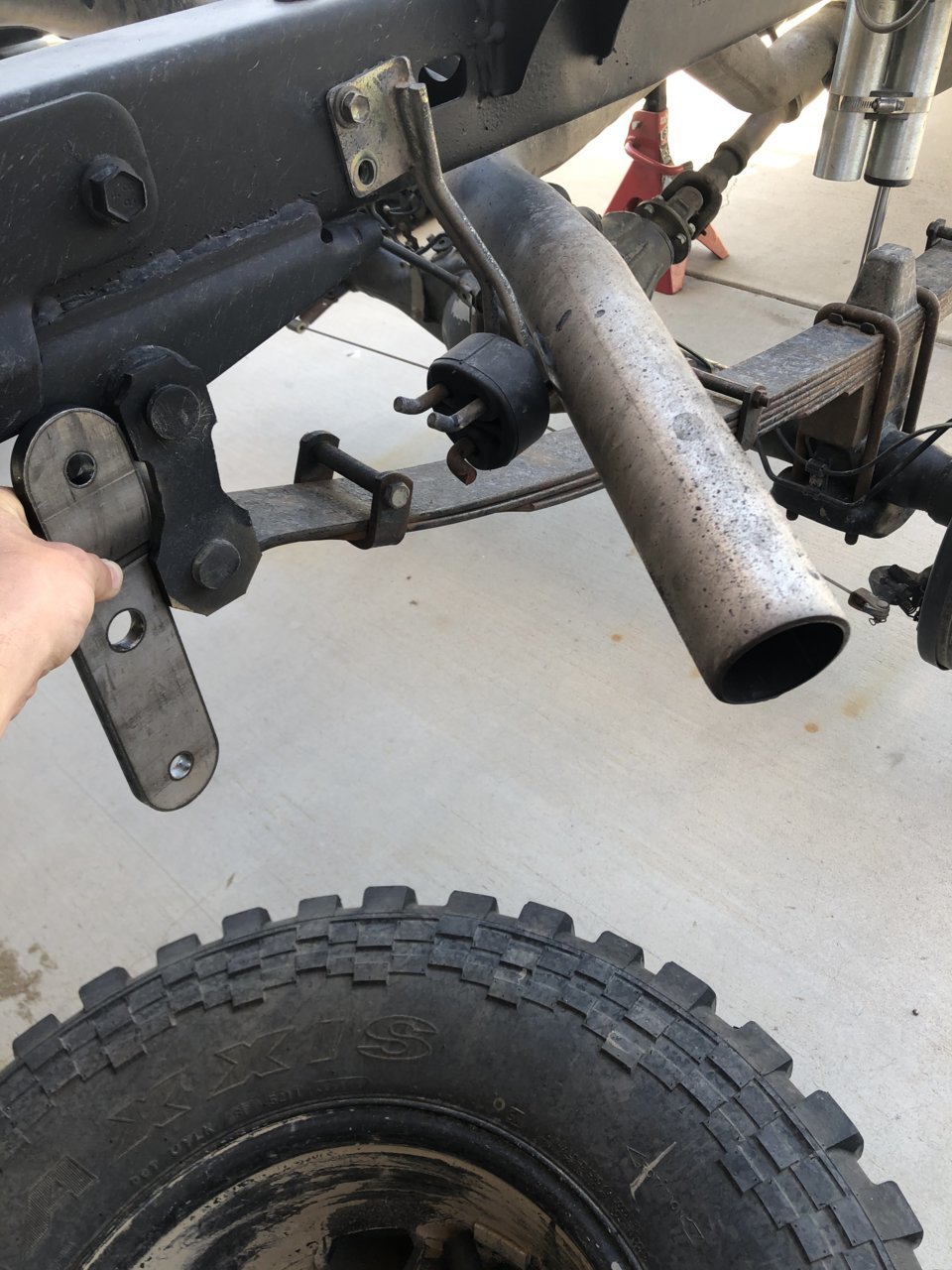

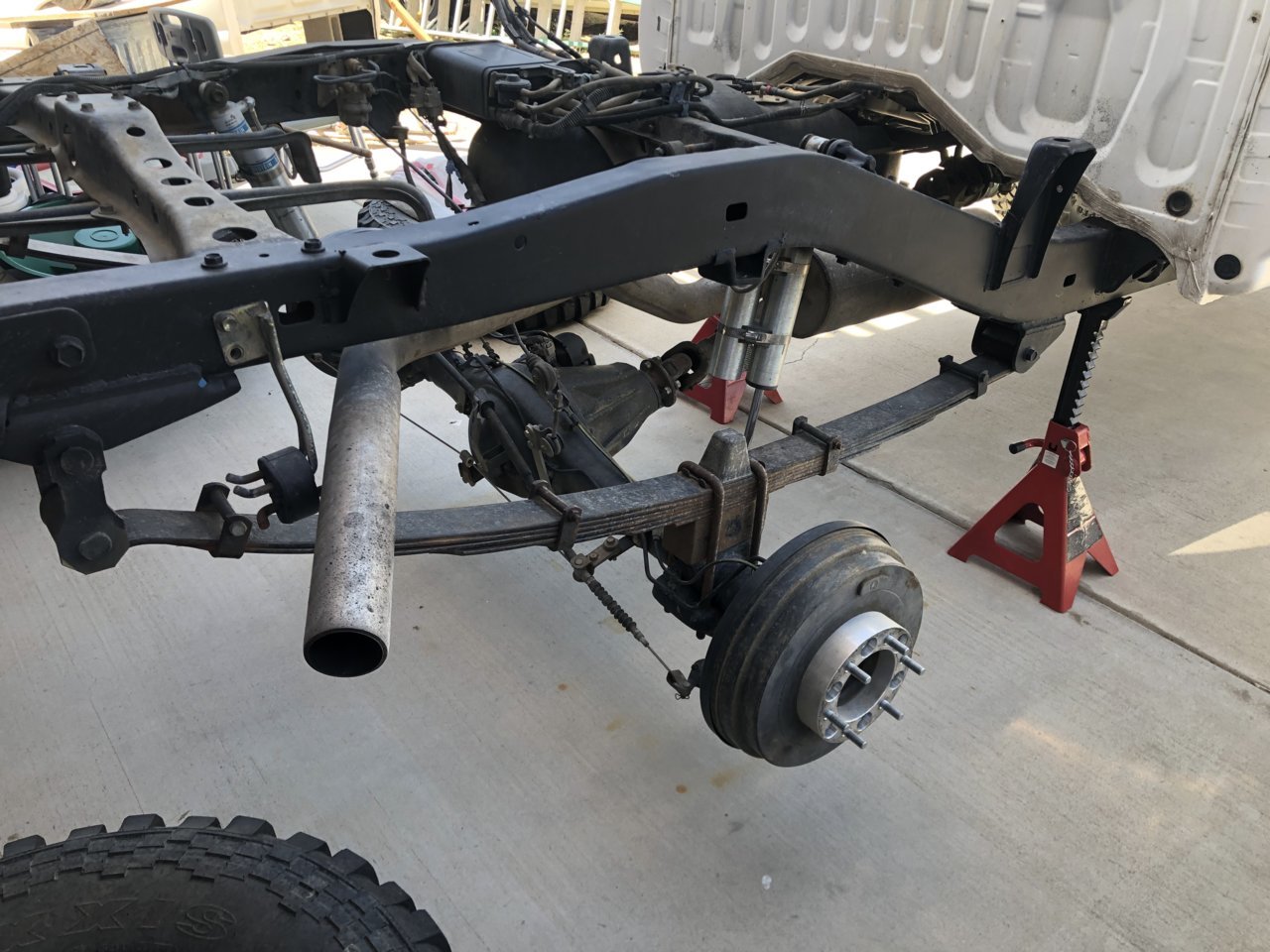

    this is my current set up, I’m not sure what the leafs are, some set of 62s, maybe deavers. Center front bolt to center rear bolt is 57inches. Stupid idea to try to just take the blocks out and put in the new shackles in the last picture? The shackles are just to find a slight improvement over the blocks until I do the new rear end. C2ABDD33-A049-4D6D-AEE9-93749C515203.jpg332C007D-E9C7-4AC0-B5F8-C9EB4A7E23FB.jpg01A67632-3121-4ACF-BE3F-12250EA01291.jpg50A0BA0E-836D-4F05-8F74-B7B428FB6E41.jpg8FEDD6F6-6946-4BF1-9E02-AF8D08E6D8E0.jpg
