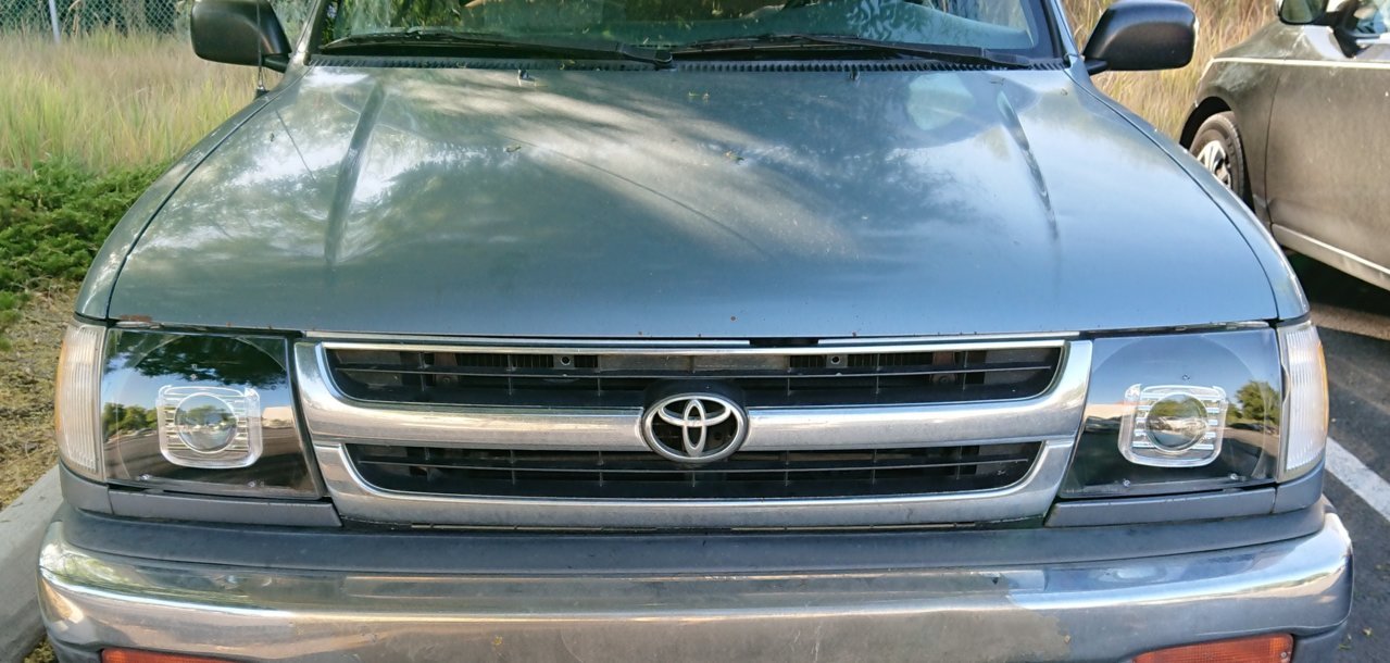

    Just don't use square shrouds. Even when the projectors are level the shroud might not be as you can see below and you end up with Forest Whitiker headlights. These were the only shrouds I had available with drl and I was on a time crunch.

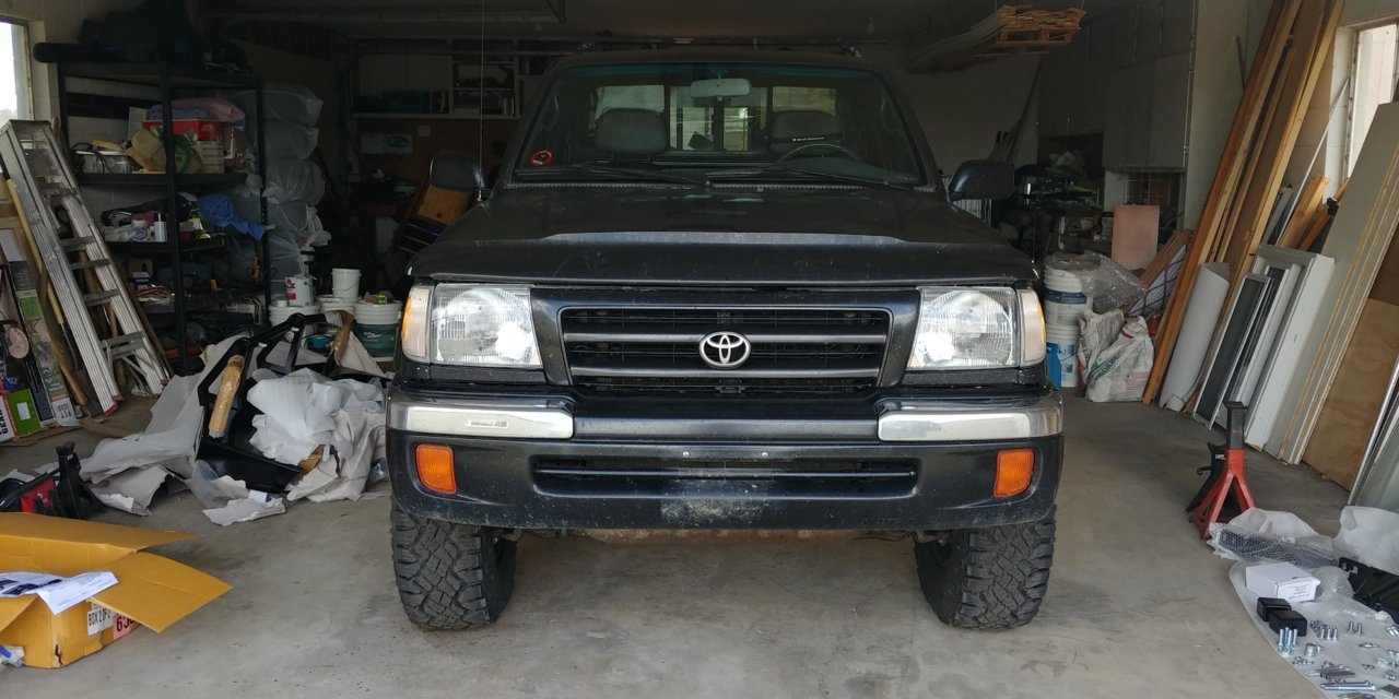

    Simply getting new clear housing it a good start, then getting new high quality bulbs will get you pretty close without a retrofit.0920191456b_HDR.jpg
