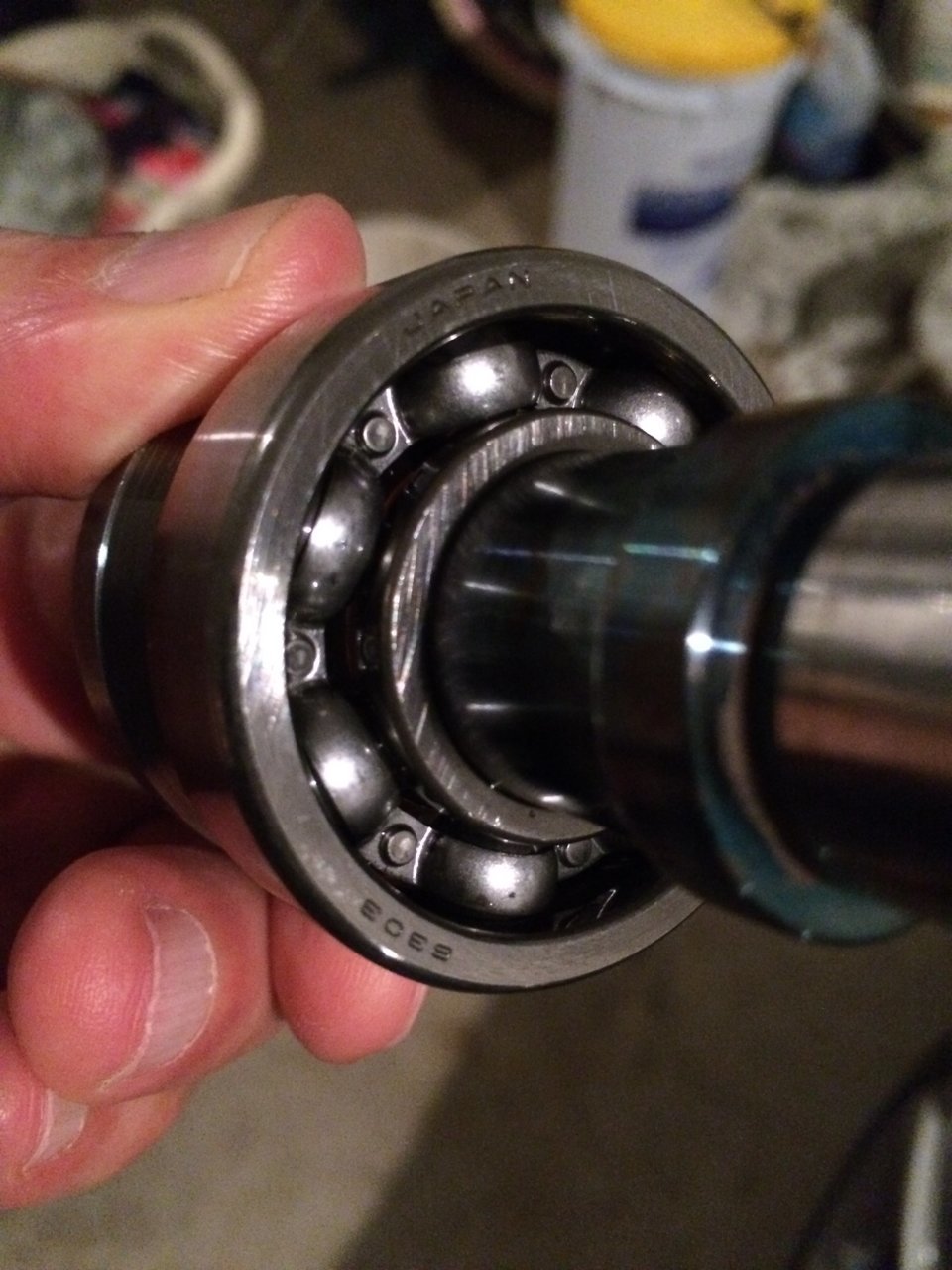

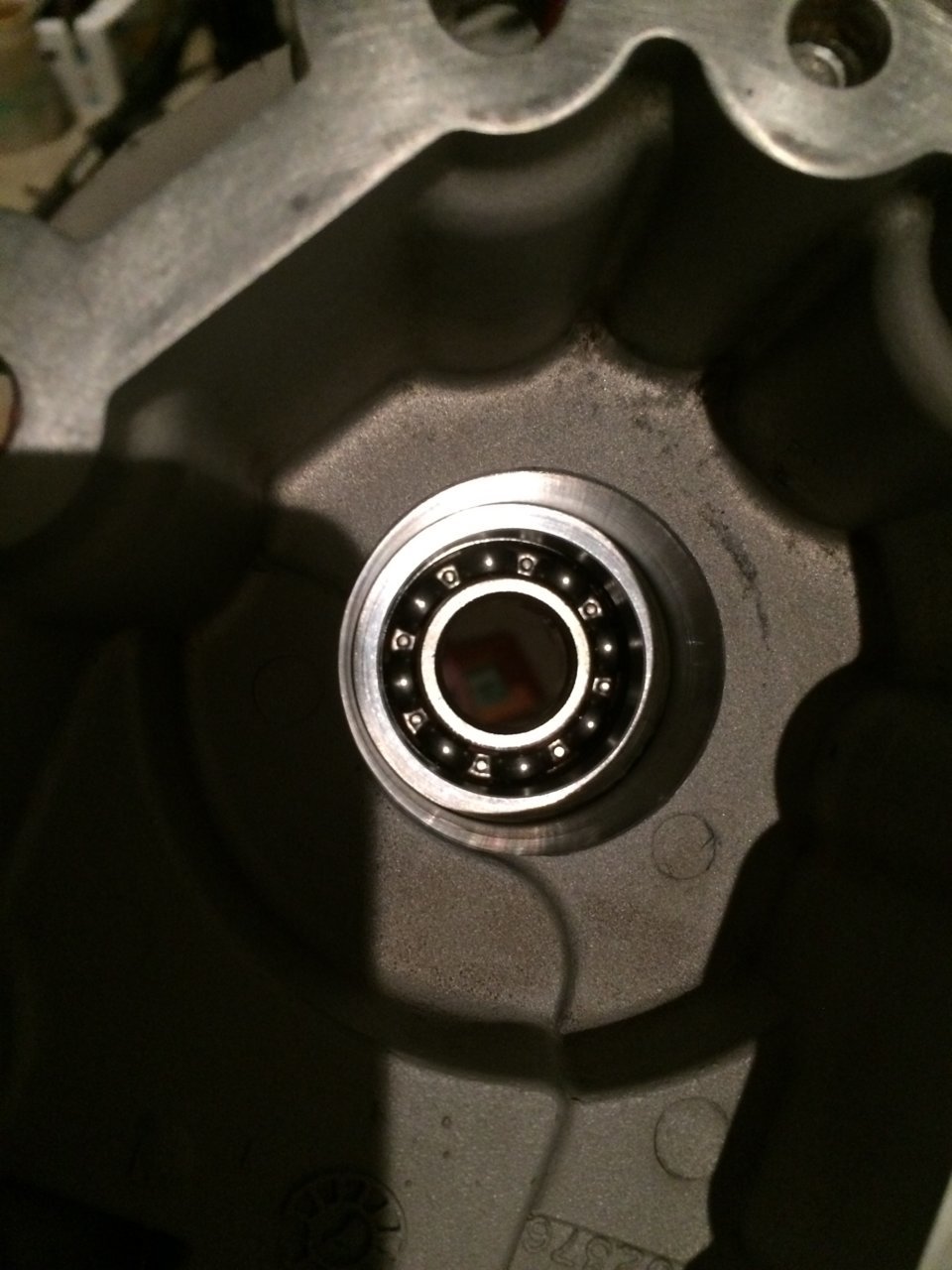

    So I searched out a local machine shop and the dude was really cool. They're industrial, widget and stuff. I think I broke up the monotony. He pressed out the shaft so I could spray the individual bearings with brake cleaner and clean the inside of the snout. I did that and applied a bit of WD40 and smooth as silk. BTW when he was pressing out the shaft I saw the outer(front) bearing drop down and fully seat. Looked like it dropped 1/8-1/4". Blew me away. It wasn't even fully seated. It is now.
    Anyway he was going to tap a plug in the top but drill was in use and he didn't want to stop production and change everything up and back. So he told me to come back Monday morning and he would take care of me.
    Yesterday I tried fishing a 1/4 tube through the original port with the snout partially attached to the rotor plate with just a small gap so I could peer in and the tubing would not go to the bottom of chamber as gears were blocking. It's obviously tight in there. So I'm happy I'm getting that port tapped. Once he does that he will press the shaft back on and I can get back to it.

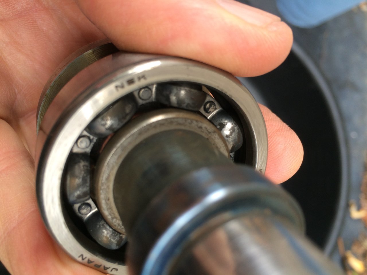

    Very good, looks like it was definitely not seated,
    since he’s going to do it Monday, should you overnight a new bearing and replace it since it’s apart? How many miles on that snout bearing?
    Usually the snout bearing goes out first. Would be easy to replace it now.

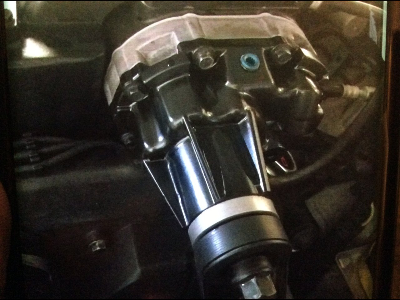

    Here is a good how to do link for the nose rebuild and fill hole mod.

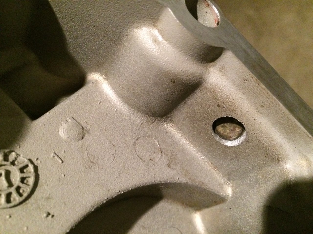

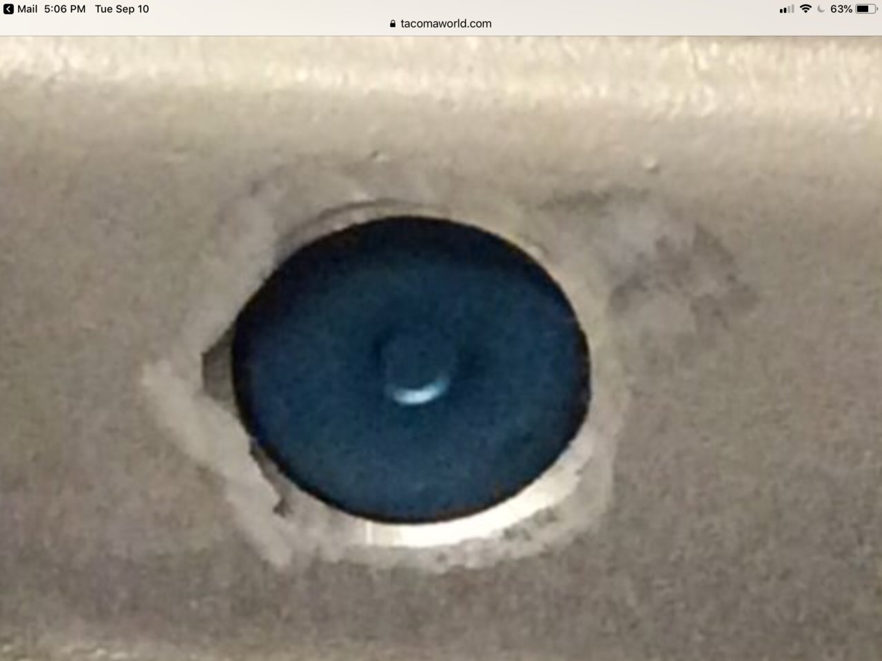

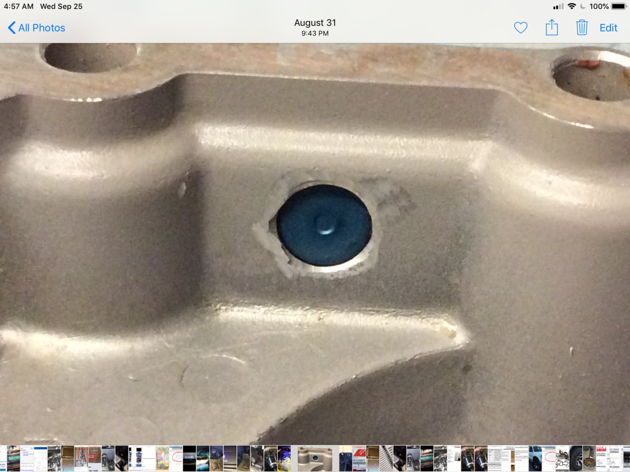

    So did the plug you had drilled go in vertical to the nose as it is set on S/C or perpendicular to surface it was drilled through? This machinist can only set it in drill press as it sits on S/C if you know what I mean and I'm concerned it will leak if not drilled at 90 degrees to surface. What is your experience?
    Basically is the top surface of your plug level and slightly offset due the pitch or slope of the drilled surface?

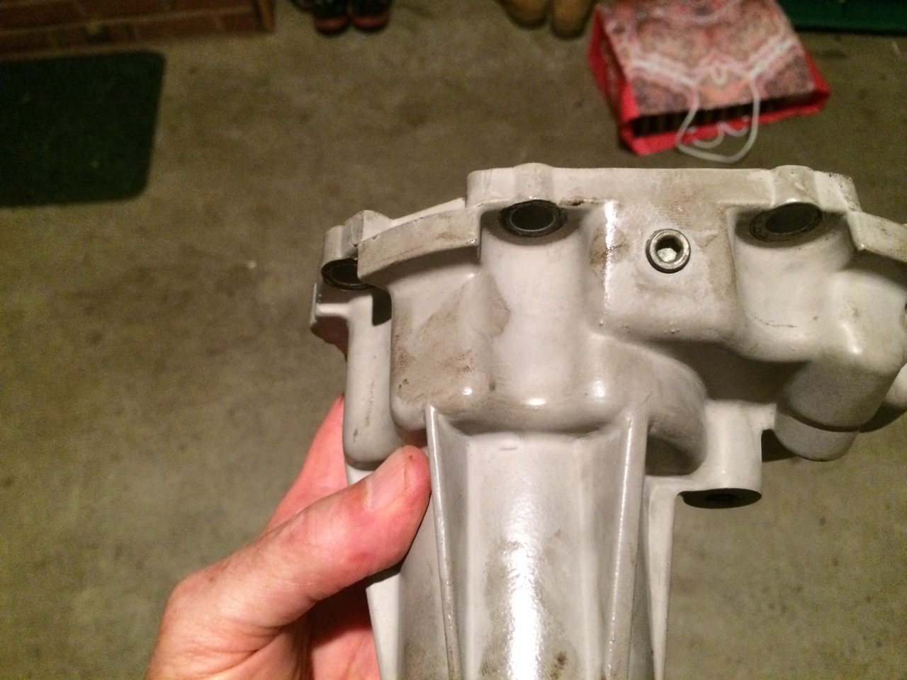

    It was drilled so when the screw plug is set in its flush with the surface

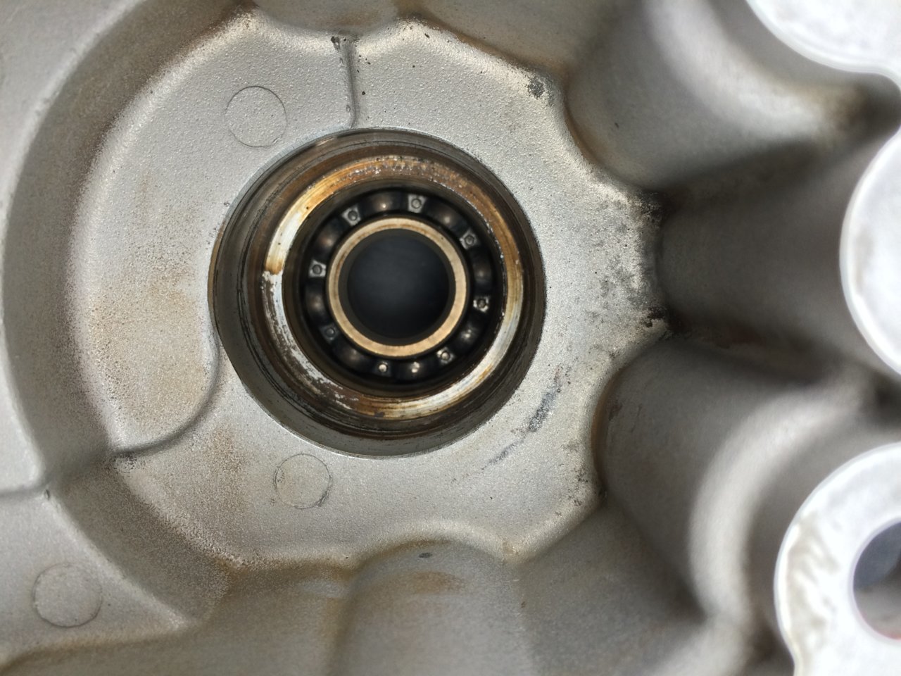

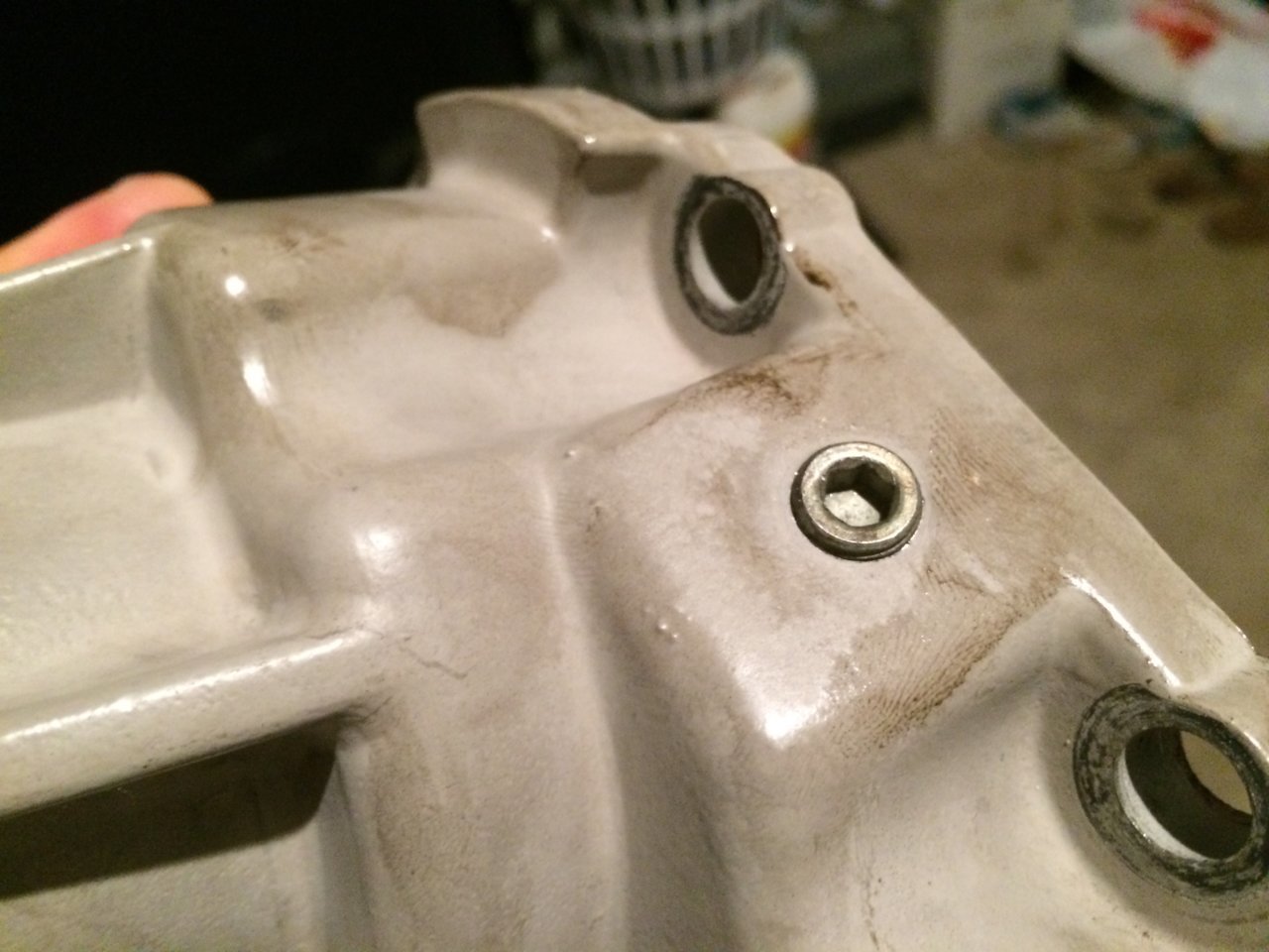

    So after I asked the question I decided instead of a widget factory, I should go to an auto machine shop. Ran into another cool dude there and he tapped me an nice hole, perpendicular to the surface, to fit an aluminum plug which he supplied. Then he pressed in the shaft and I was good to go.
    I decided to go with the bearings that were in it as they seemed in great shape. Also cleaned out the rear needle bearings and repacking with that Redline CV2 moly grease.
    I'll reassemble tomorrow and be ready to role the day after. From what you say that gasket sealer needs 24hrs to fully cure.
