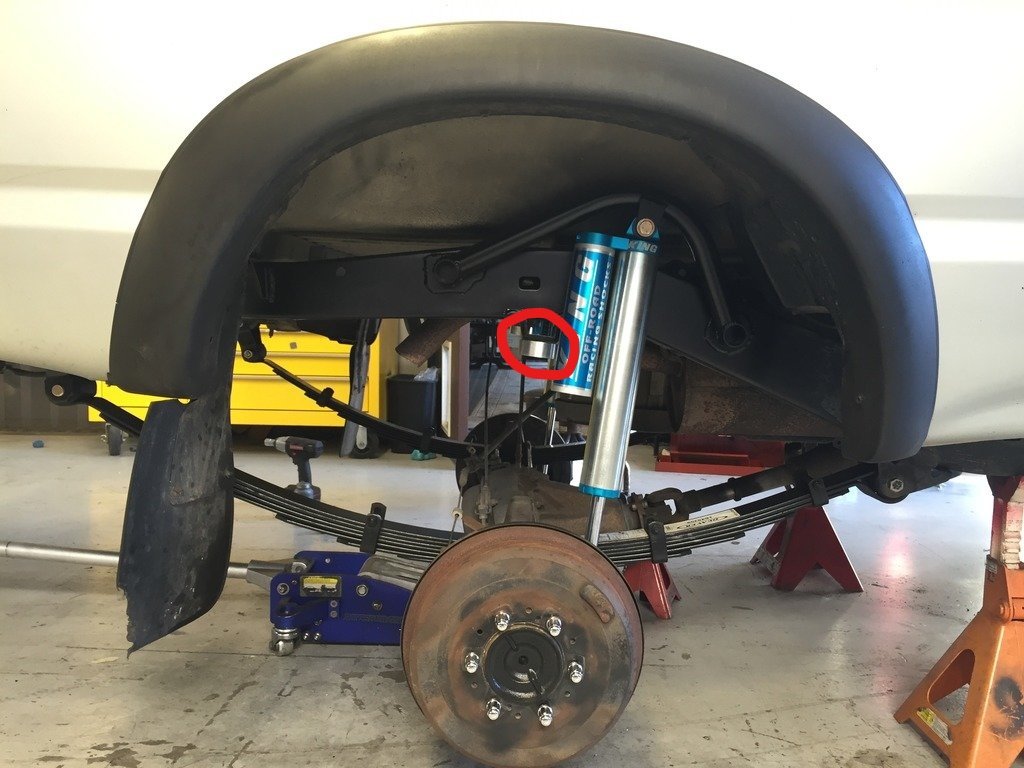

    My Deavers go just past flat when i bump. I added a 3/4" spacer as it was the most effective way point to set my bump limit.
    When we set up my Archive kit, we kept the spacers in because losing 3/4" inch of uptravel isn't that big of a deal, and it optimizes the amount of droop i get, because sending it is fun.

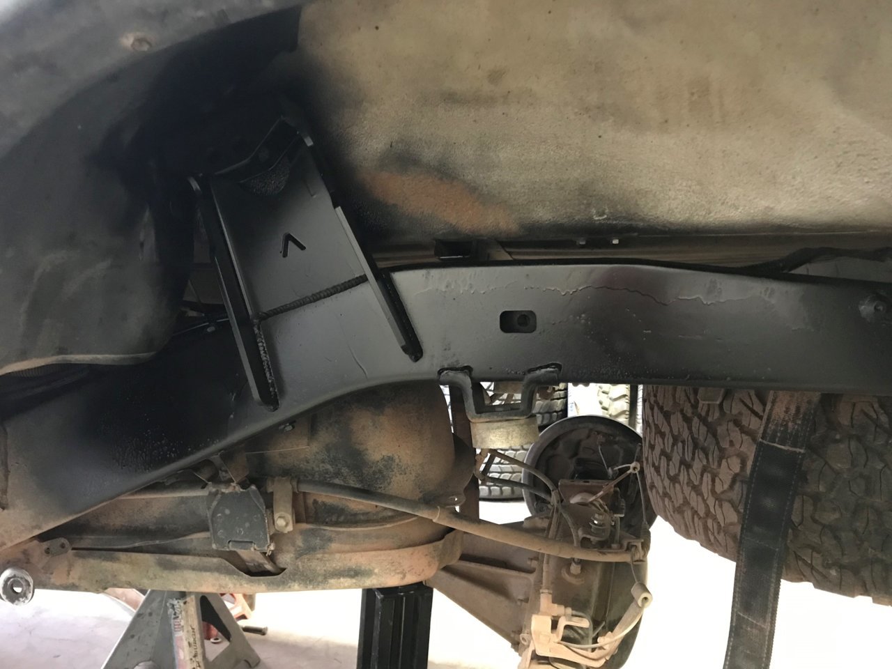

    Eric asked for help from experienced members to R&D the prototypes, and i need the space for a hydro bump that the Solo mount prevented.
    Plus the Archive is a tower style which i prefer, it's designed for a 2.5, vs 2.0 for all the others, and its crazy stout. My frame will bend before i ever have issues with this beast.
