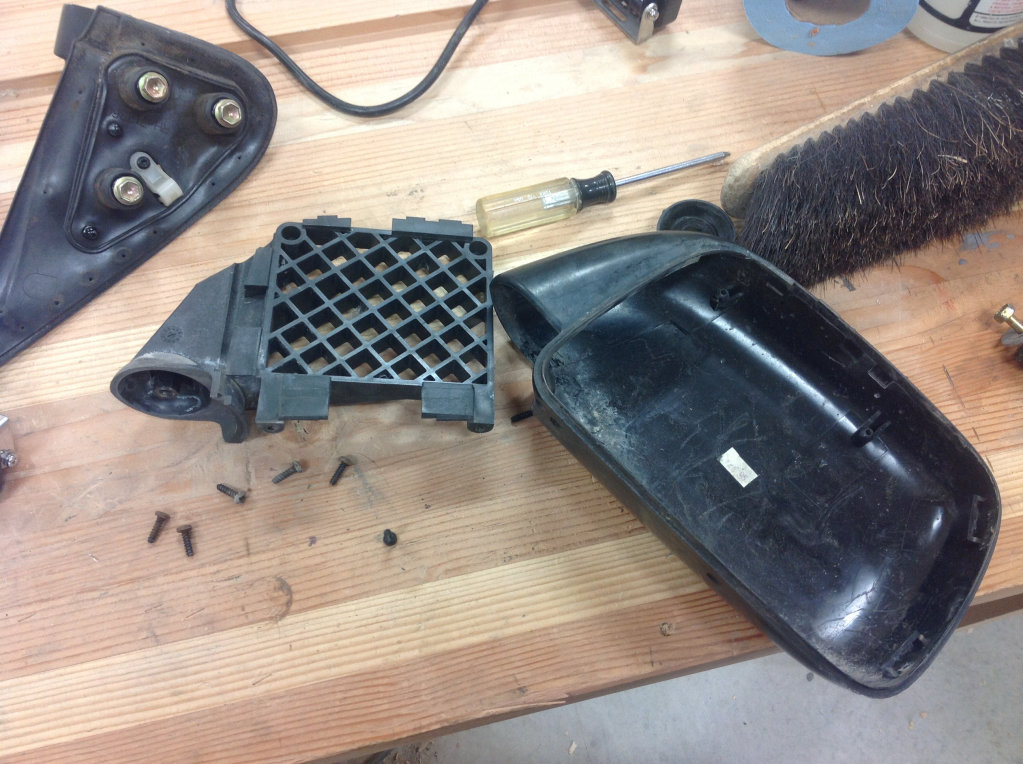

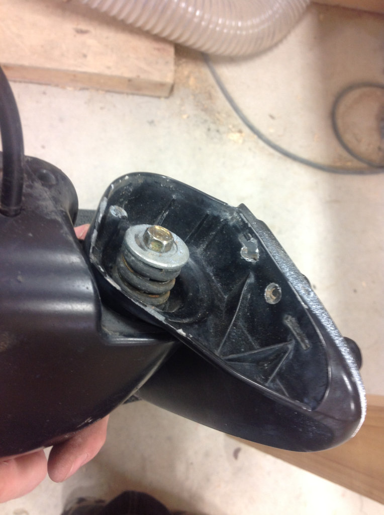

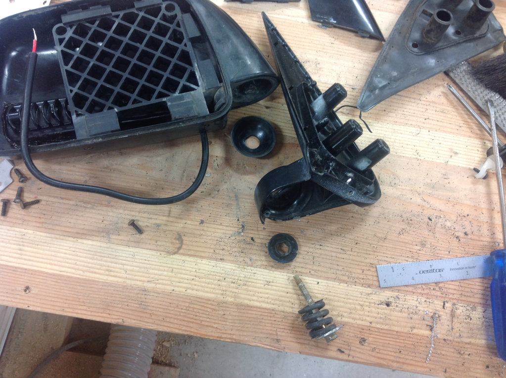

    The first step is of course getting the mirrors apart. Now, this is trick. On my mirrors(95-97 1st gen) there is a ring that you can see to pull off. However, the glass is held in by tabs by this ring. This means that if you just stick a screwdriver in it and pry, the glass will crack as you pop one side out. This poses a problem of course and is why i suggest getting a set of spare mirrors to steal the glass out of. Why? well when i went to the parts store the glass was made to order only. Not sure how much it would cost, but a set of spare mirrors will run you like 20-40 bucks. If someone does just order glass please let me know!
    So as a result, i ended up breaking out all my glass while popping off the outer ring.

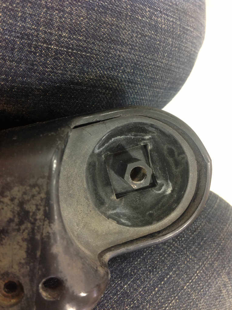

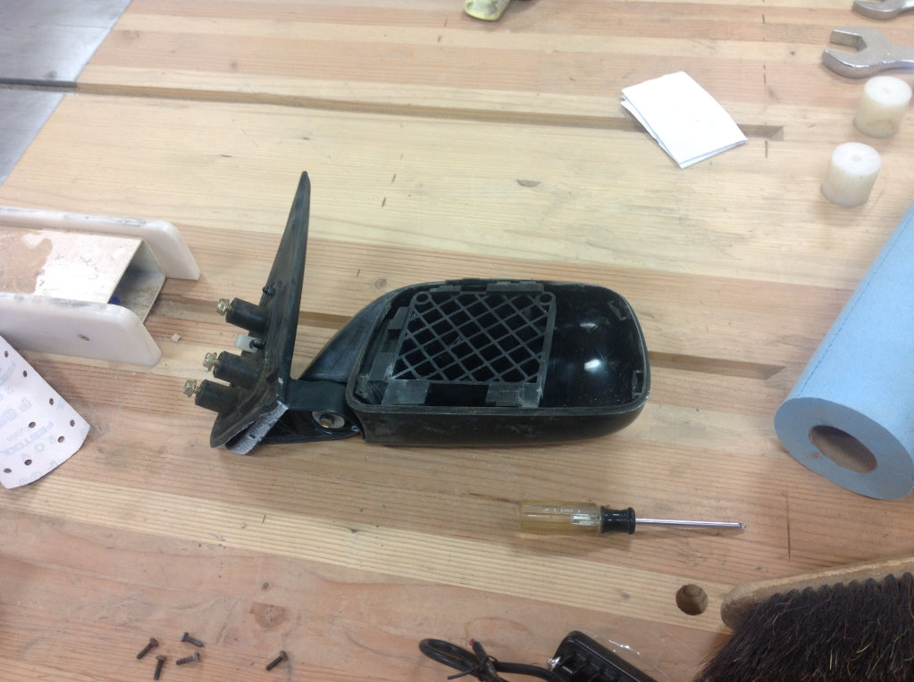

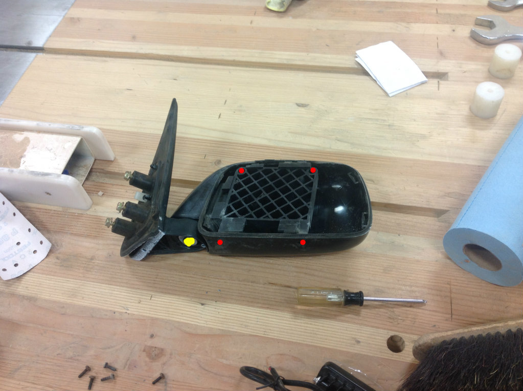

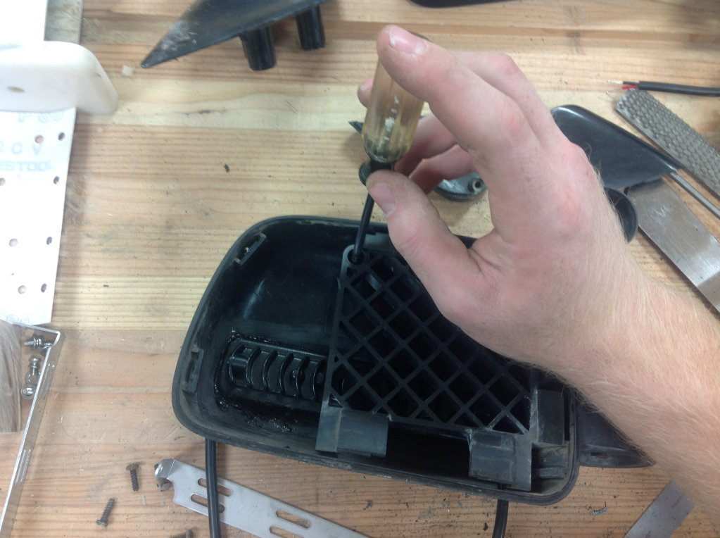

    From here you must remove that glass honeycomb structure support. There are 4 T10 torquex screw you much take out and the 1 main 10mm bolt that holds the main joint together.
    Two screws are up top on the honeycomb struceture, and two are on the bottom on the mirror.
    Red are T10 screws, Yellow is bolt. You have to also pop of the small plastic cover that hides the bolt.
    Should be like when done. KEEP TRACK OF ALL THE PARTS IN THE JOINT! and the order they go in. This is also another good reason to have extra mirrors. I actually had to borrow some of the joint parts as a few broke just from age.

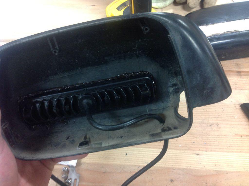

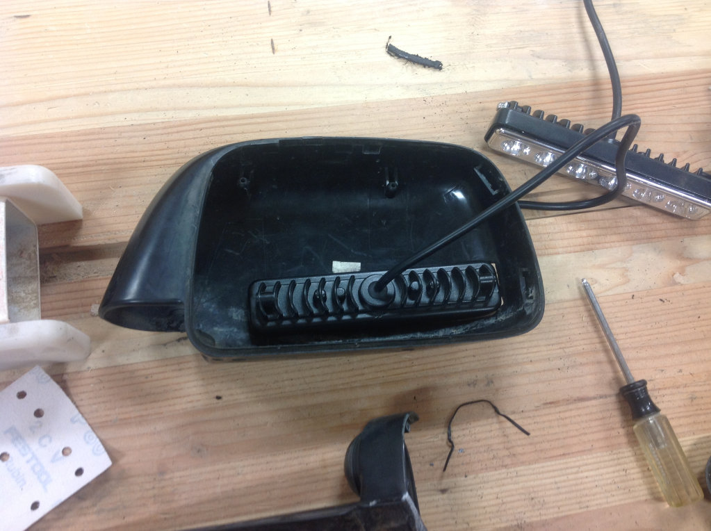

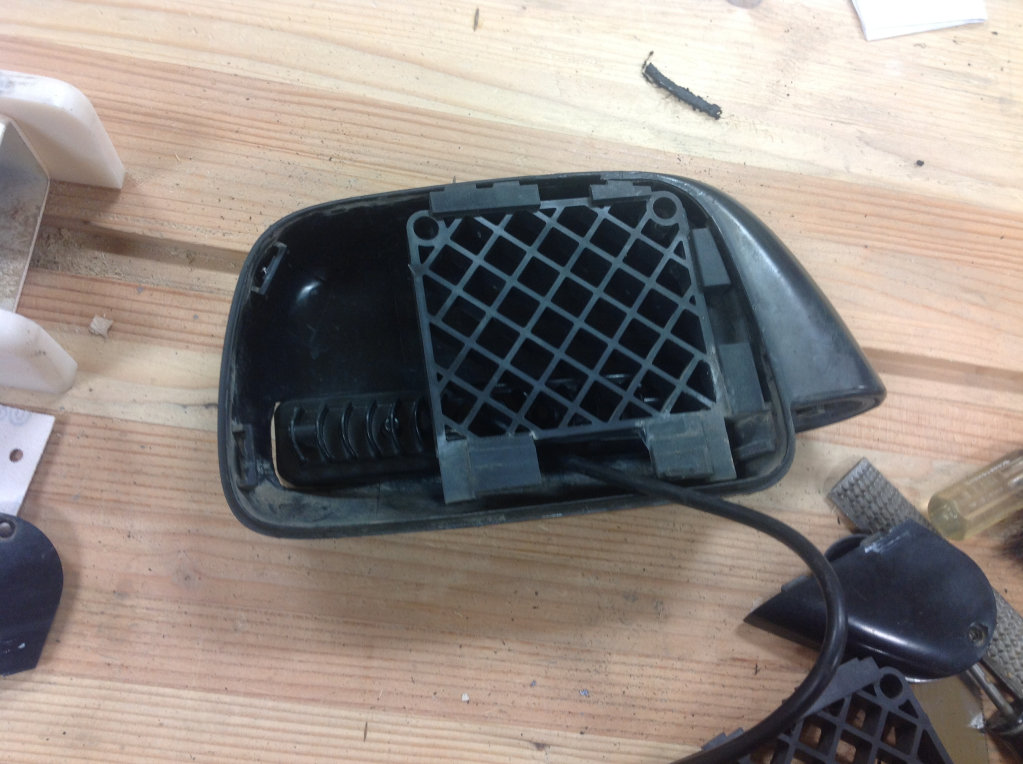

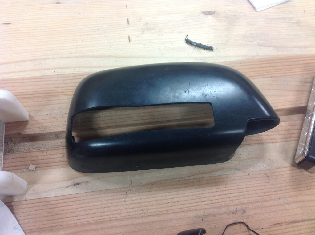

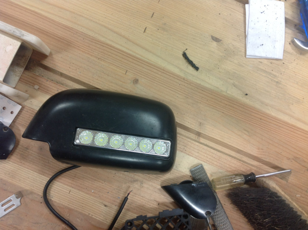

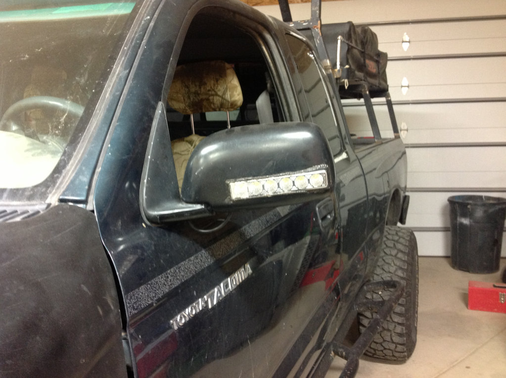

    Now for the cutting! I used a pretty nice tool but i don't think most will have it. I used one of these. Its a multi tool that has different blades. I can't remember the brand i used but it was very nice and using the curved blade made it quite easy. I set the light it and got a rough idea where to cut and went to town.
    Two important things about this:

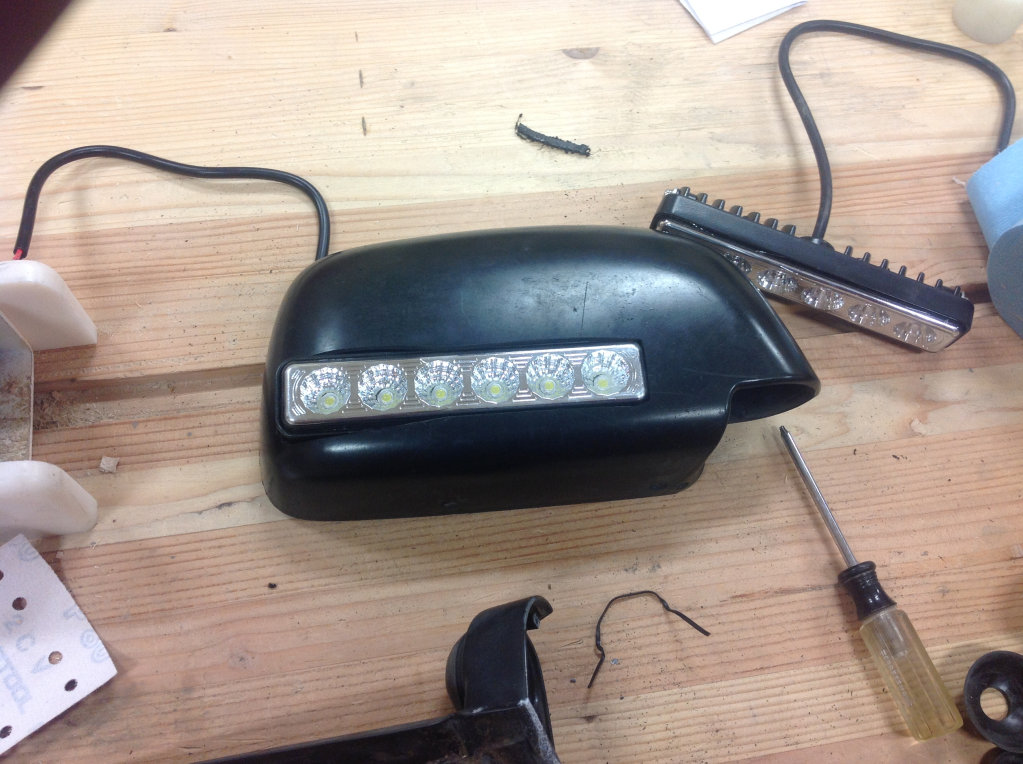

    1: the Blitzpro lights have a kind of lip. The clear lens is smaller then the black backing/heatsink. So i want my hole to allow the clear lens through but not the back part so as to help create a seal.
    2: Id strongly recommend NOT cutting it super exact. Cut smaller then what you think. You can ALWAYS cut out more..can't really add plastic easily though..

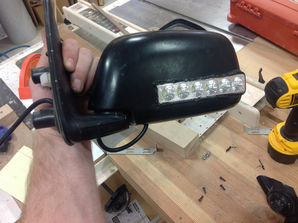

    My first cut was much too small, i was okay with that and set about using hand files to get it perfect. It took some time but i got it how i wanted it.
    Now because i had to push the LED bar more out side the mirror this presented a slight issue. It put the end of the bar into the curved part. This did not allow the light to sit flat as the hole was small enough it would only let the clear lens through. So i made the outside portion of the mirror even larger to allow the black back part of the light stick out as well which in turned let the light sit flush.
    As you can see the left part of the mirror(outside) is wider then the right(inside)
    As you can see, part of the bar is now outside the whole mirror while another part is on the inside with only the lens out.
    this did take some filing and time to get it just right but really the light sate in just great and practically held itself especially with the honeycomb struce behind it.

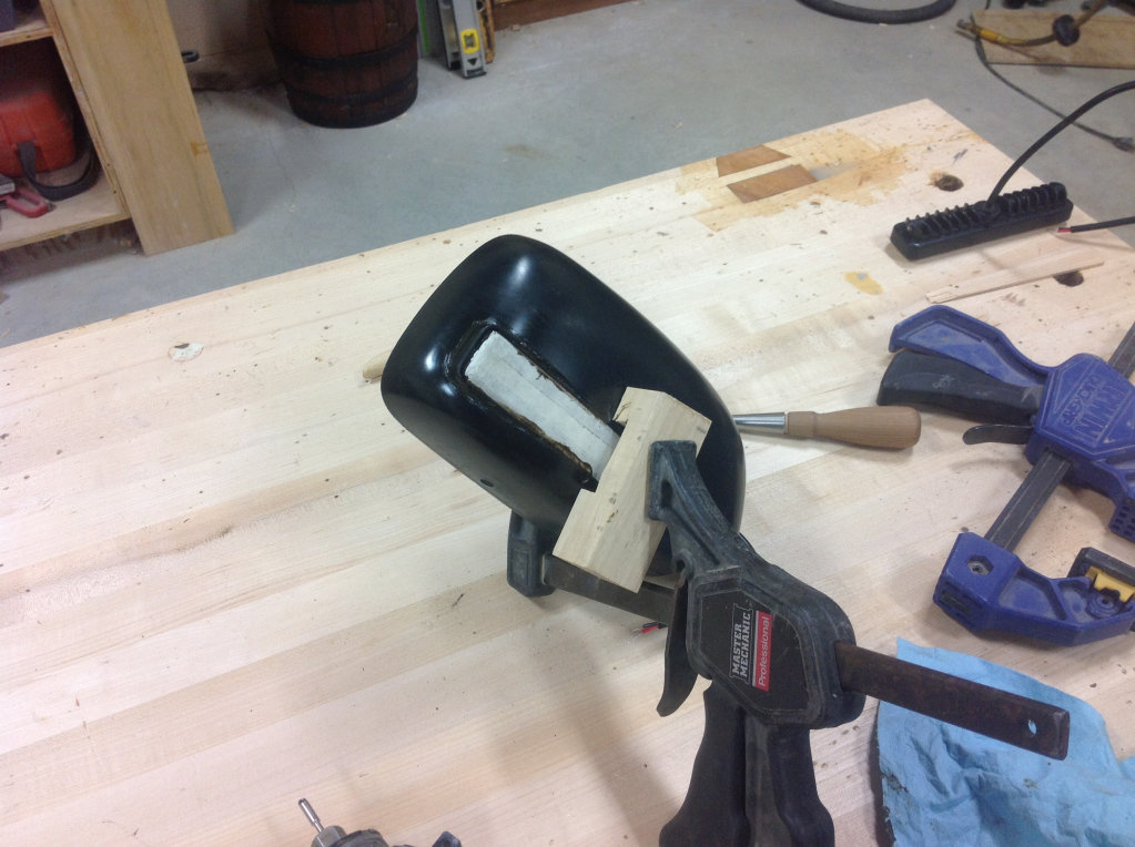

    From here i applied my epoxy on both the inside and outside of the light careful not to get any on the lens. This provided even a tighter hold for the light but also a good weather seal.
    rigged this up to keep it in place.

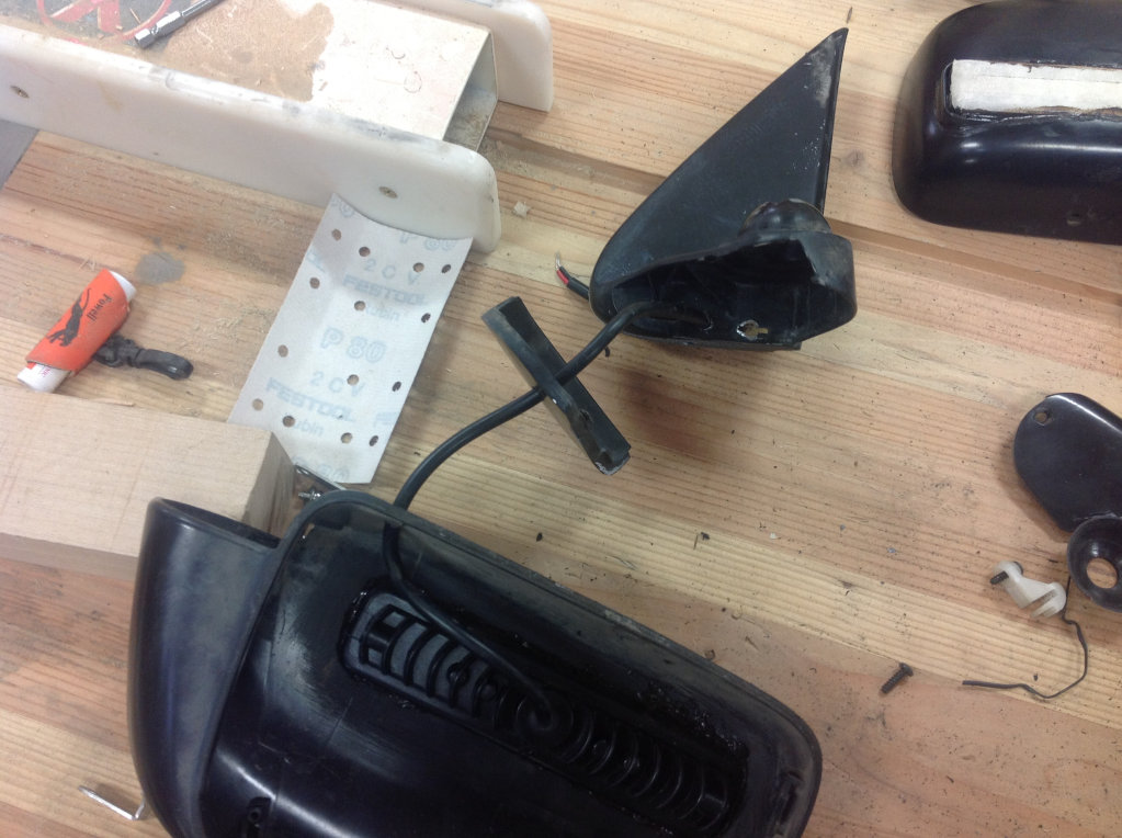

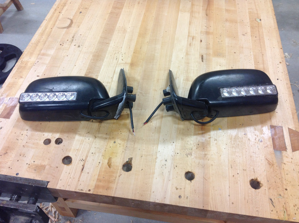

    now after letting them sit for a day i went back to work with getting the mirror back together.

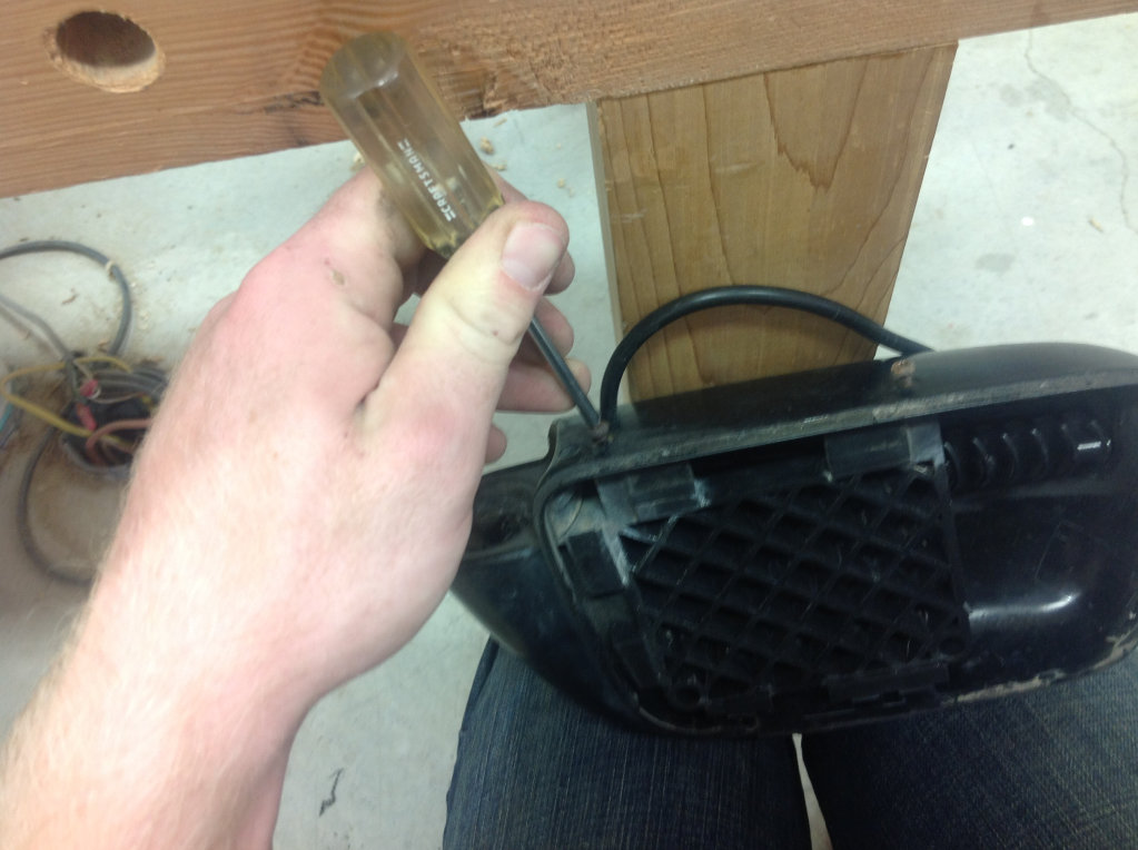

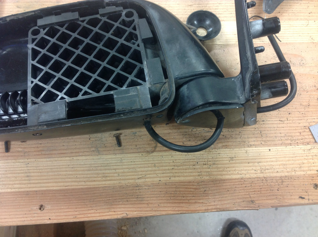

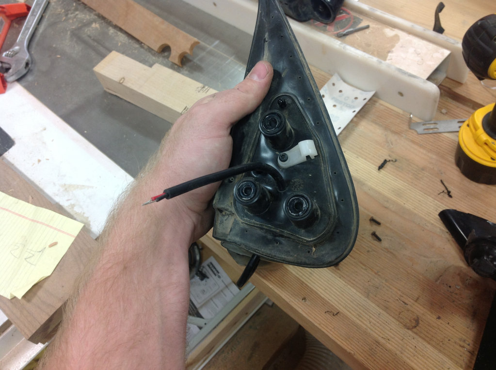

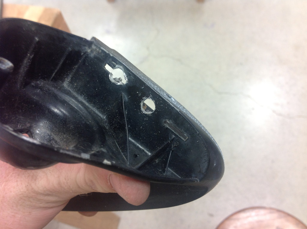

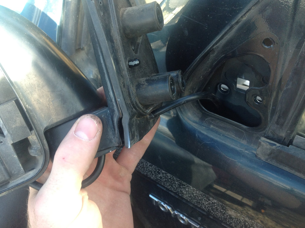

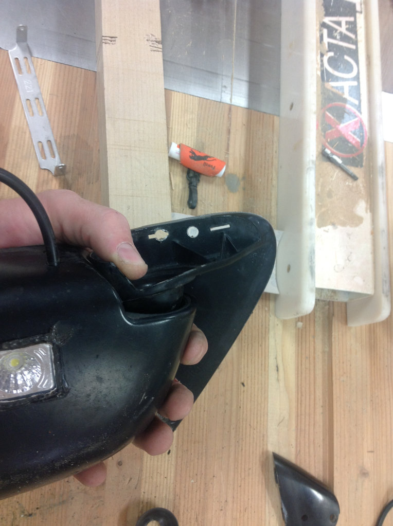

    first i had to get the wire out. Now some might be saying why not go through the joint? well..easier said then done. In order to still allow the mirror to freely pivot, you would have to cut very large notches in the joint..all three layers of it..if you want too, please do! But i found this way to be very effective and really doesn't look bad.
    i started by drilling a hole at the bottom of the mirror on the inside just by the drain hole using a 1/4'' drill bit.
    Then i passed the wire through.
    this is how i have the wire on the inside.

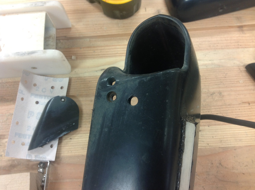

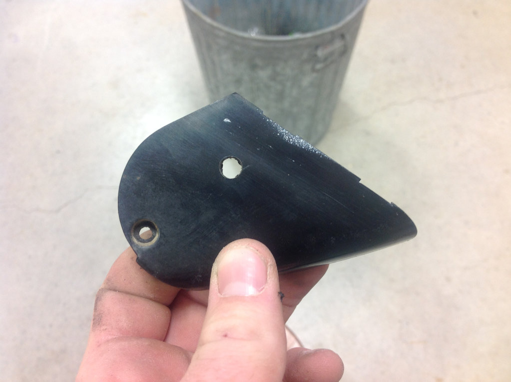

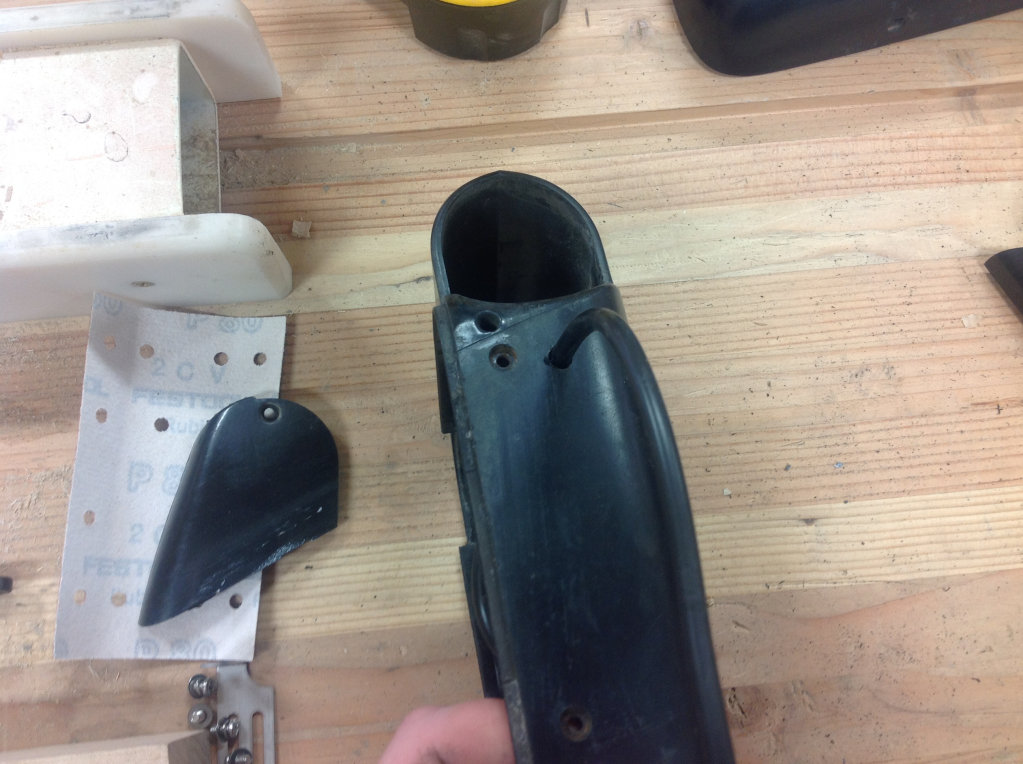

    Next i drilled yet another hole in the small plastic cover that goes over the joint bolt on the bottom
    Then i drill a hole right in between the two slots that the cover goes into on the mirror mount. (please ignore the hole in the slot on the left of the center hole, that was my failed first attempt)
    You will also right above the hole have to cut a notch in the mirror mount. This is to allow the wire up so the wire can come down into the door through the gasket.
    Make sure to take a small round file and smooth the edges as best you can in the two metal holes! and get any flakes off.
    So the wire route through the mirror is like so for now..

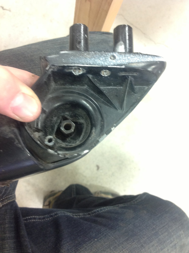

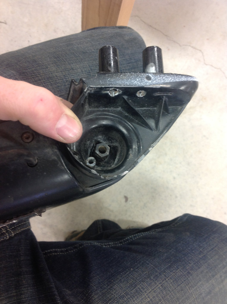

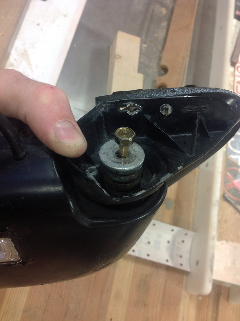

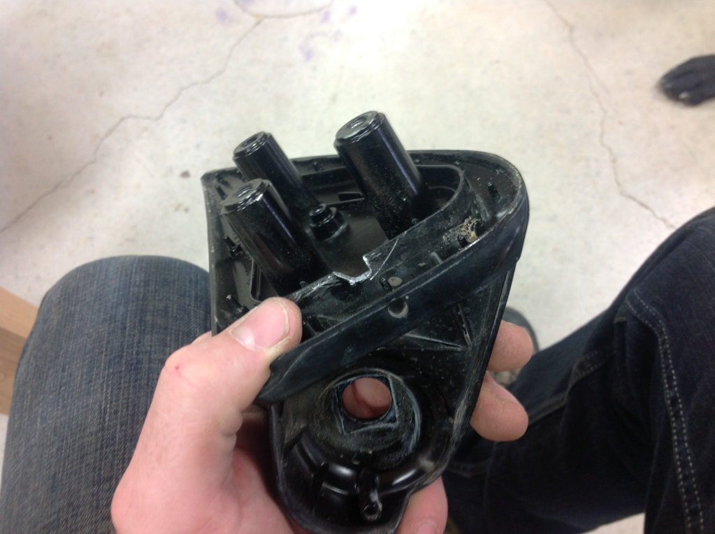

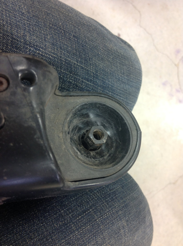

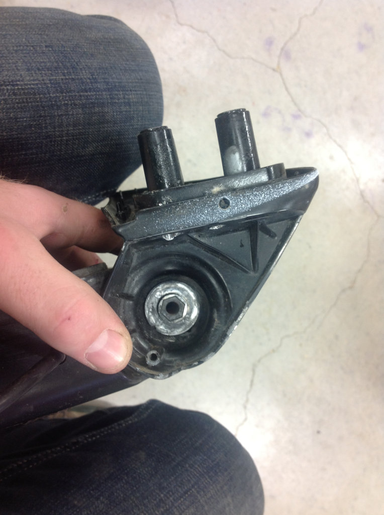

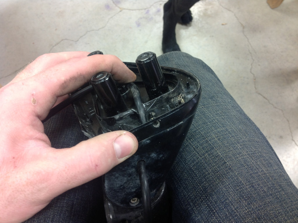

    great! Now you put the joint and honeycomb structure back together.
    here is the joint in case you forgot. BUT..i forgot a piece..its actually there but i didn't pull it out for you to see :eek: But i did show it again so you should know how it goes together just right.
    the piece i forgot to pull from the mirror is actually the first part of the joint.
    This is how it starts..
    needs to look like this
    Then the second half sphere goes on, followed by the main joint
    so you have this..
    then add the smaller half sphere
    then the metal washer
    then the bolt!
    Then torque it down to a point that the mirror is movable, but not super hard, not to easy either.
    So now you can thread the light wire though the hole you cut and put the small plastic joint cover back on.

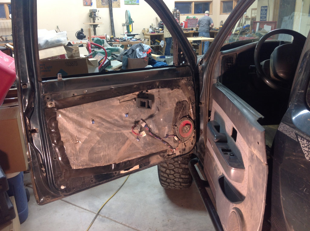

    You have to take off the door panels to do this so go ahead and do that. You will also have to remove the rubber wire sheath that projects the wires running from the door to the cab. you do NOT have to disconnect the wires from the door. Just push the grommet out on either side. Also removing the door speakers is a must so you can actually grab the wire and see whats going on.
    Then drop the cable down through the door.
    MAKE SURE IT RUNS ON THE OUTSIDE OF THE WINDOW GUIDE! You don't want to have it get pinched by the window!!

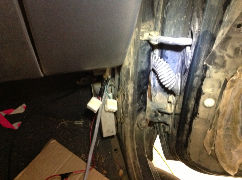

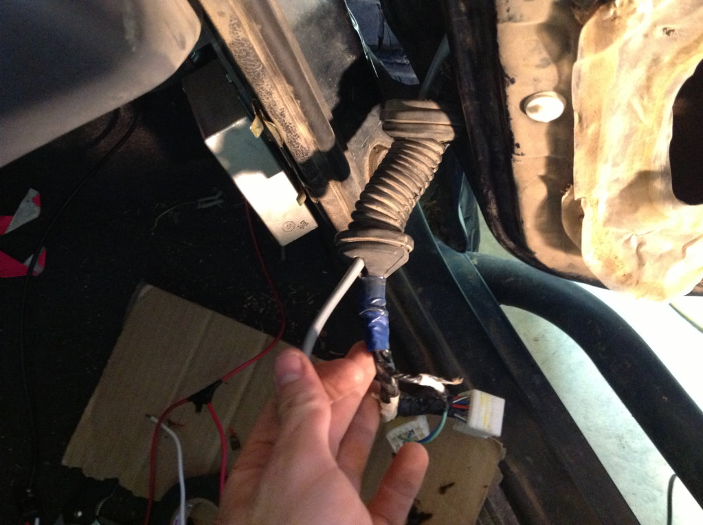

    okay so then you have to remove the inside lower kick panel and then disconnect the two big plugs for the windows and door locks. Granted that is if you have power windows and locks.
    So now you just push the wire through the Grommet shielding and through the hole on the other side like so.
    put the shield back on like stock

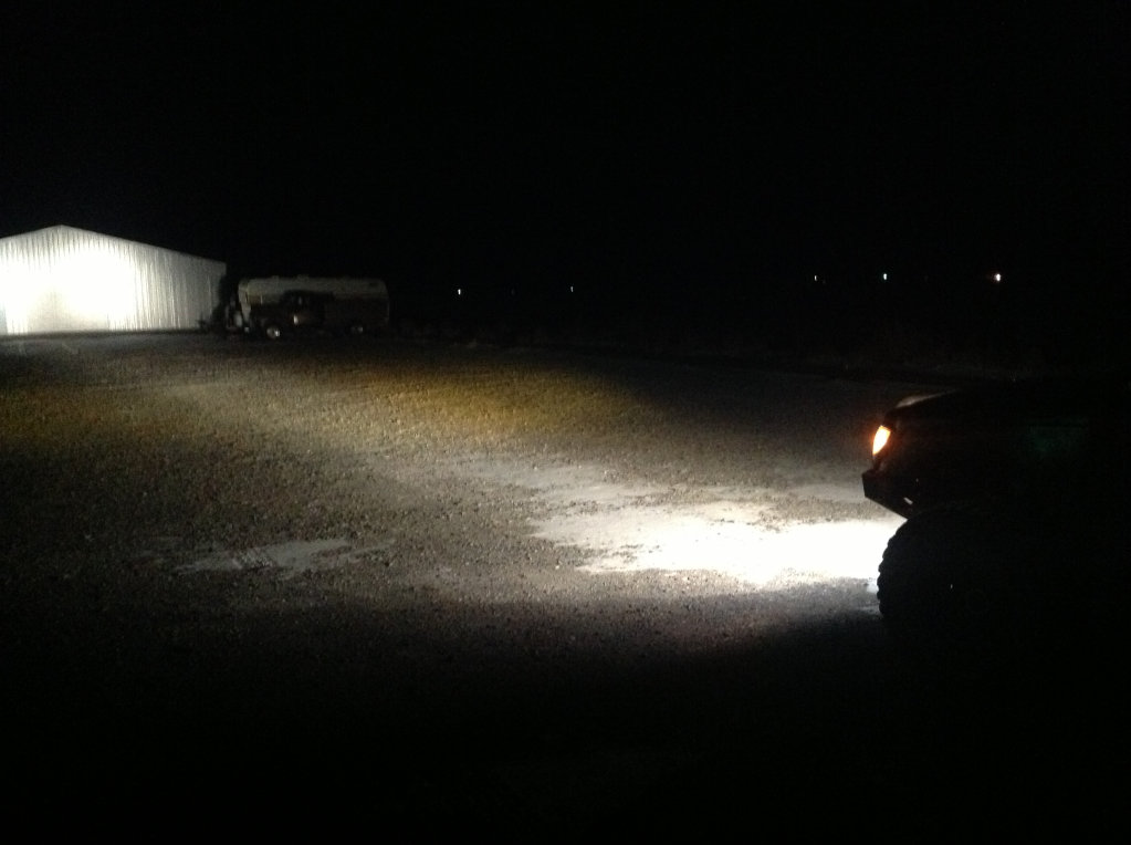

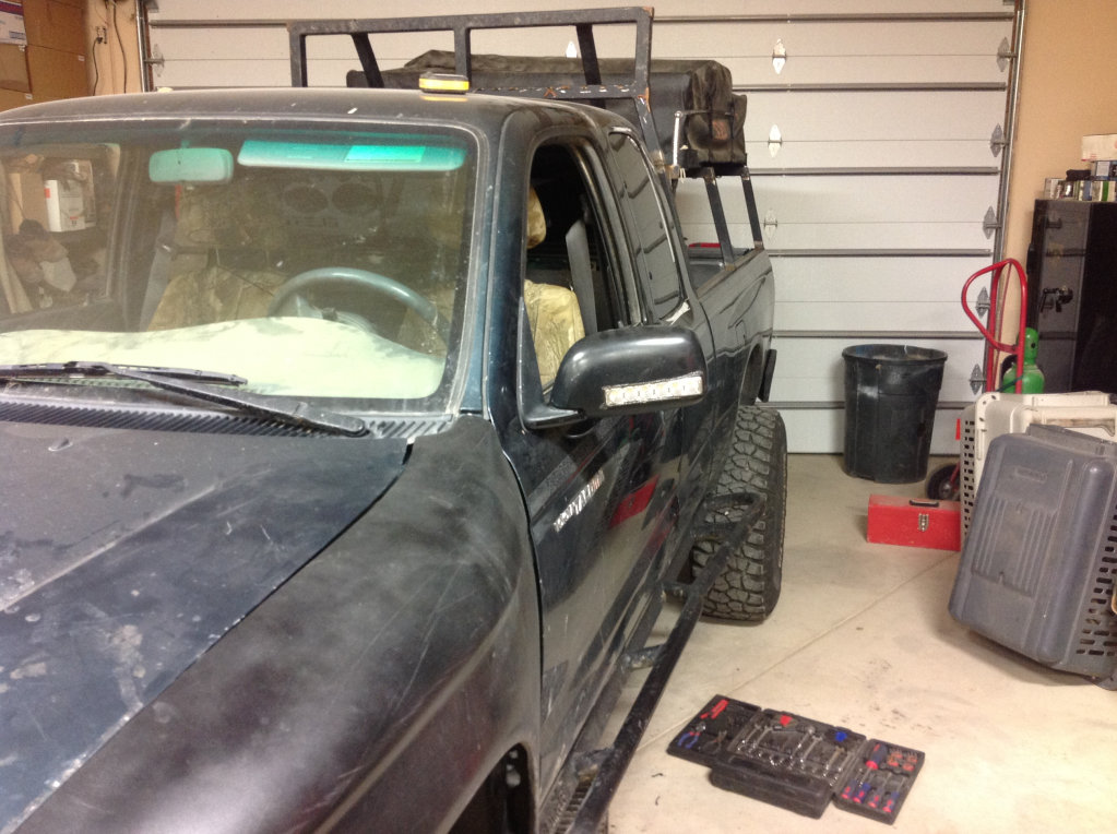

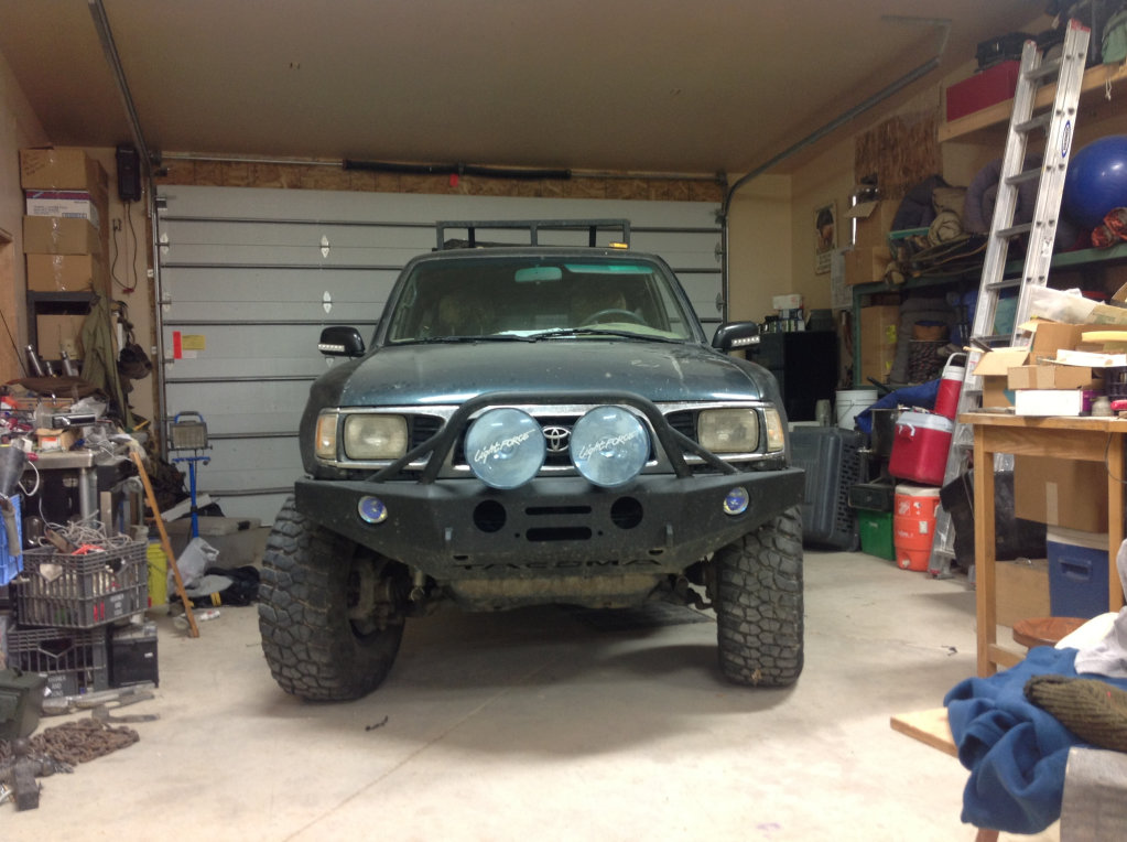

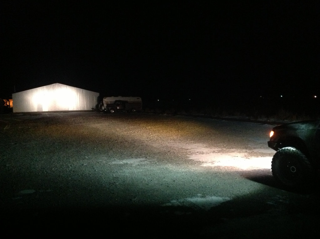

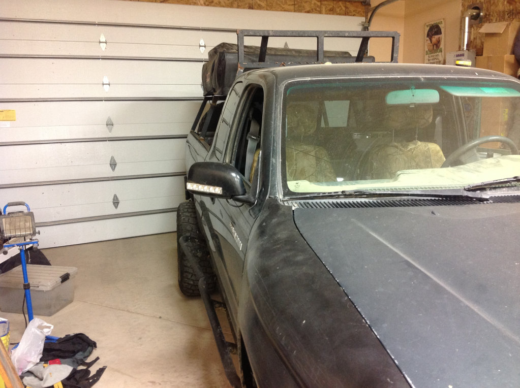

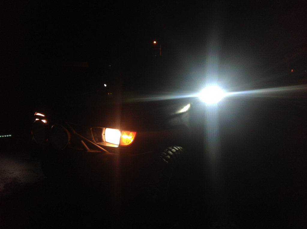

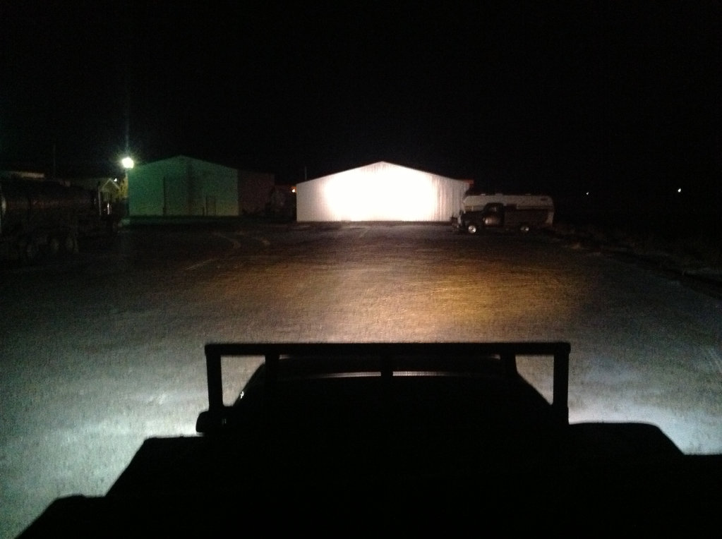

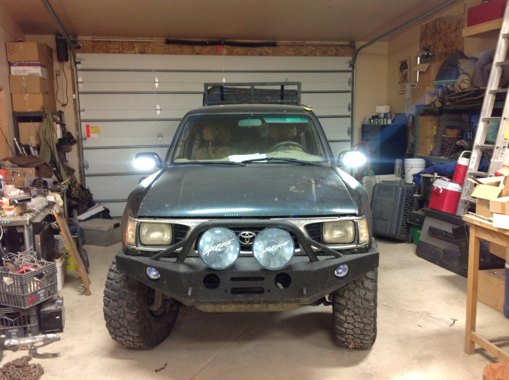

    Now some pic of them in action.
    Mirror lights off
    mirror lights on
    If you have ANY question i will be more then happy to answer them! Or get more pictures if need.

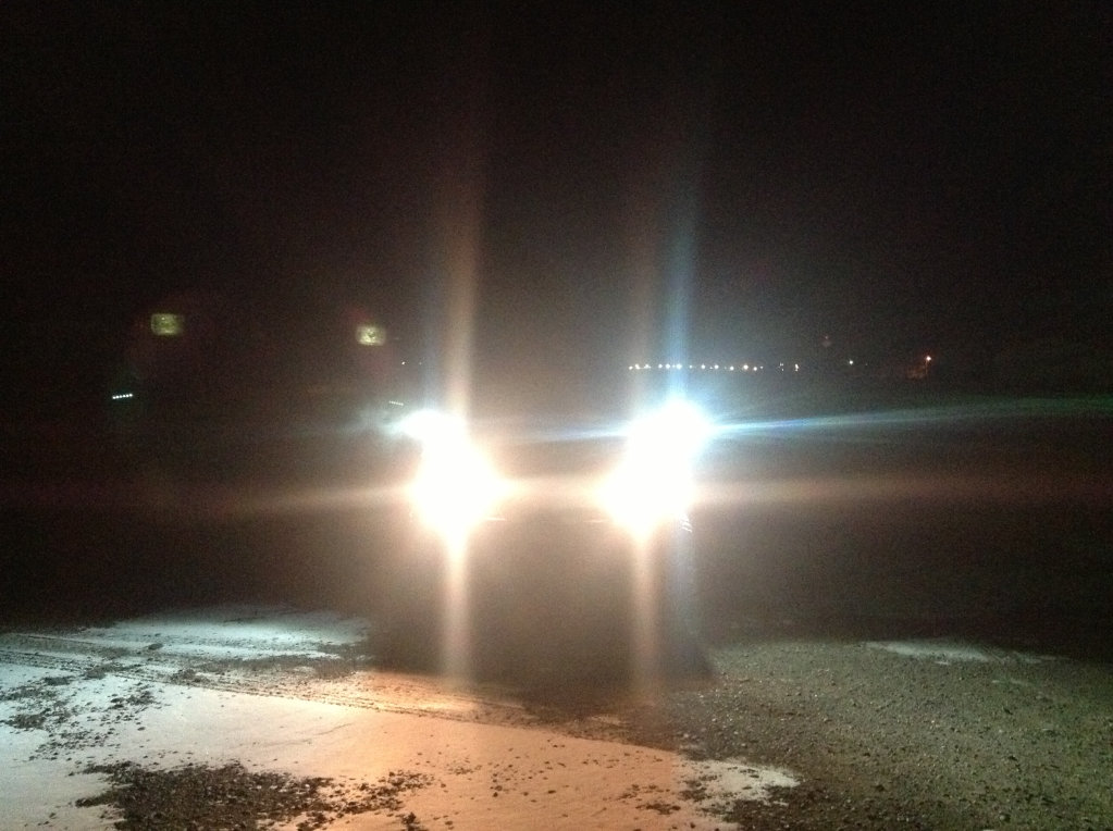

    OP updated with night shots!
    More to come in the future with a real photographer.
