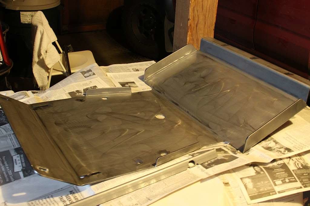

    I really like my BudBuilts. http://www.budbuilt.com/index.php?option=com_virtuemart&page=shop.browse&category_id=23&Itemid=170
    Here is the front one before paint.

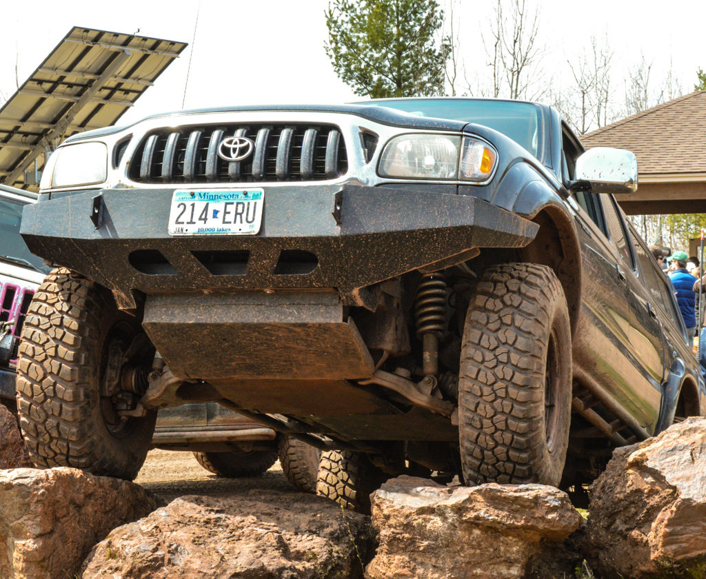

    Bilstein 5100's all around - Toytec/Eibach 112-620 Coils, Wheelers 5-Pack+Wheelers 2"AAL. 33x10.5x15 KM2s - Siped on Summit Racing 84-5883 rims with 3.750 BS. 4.88s. Demello HD round sliders. Home built full skids. Home built front bumper. Plasti'd badges. Energy Susp. steering rack bushings. Sway bar delete. Deck plate mod. aFe Pro-Dry. Gibson exhaust.
    Yup, bud builts are pretty much a standard. Only tip is to either mimic their layout when building your own if you have the skills/friends, or at least have some angle iron welded in on the 'bash' part to keep i from bending over time/big hits. Definitely add the 'ribs' on the belly skid if you get that too.

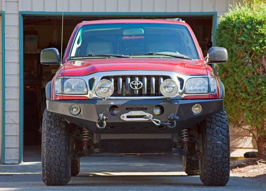

    You do not have to have an aftermarket bumper. The budbuilts mount to the stock locations.
