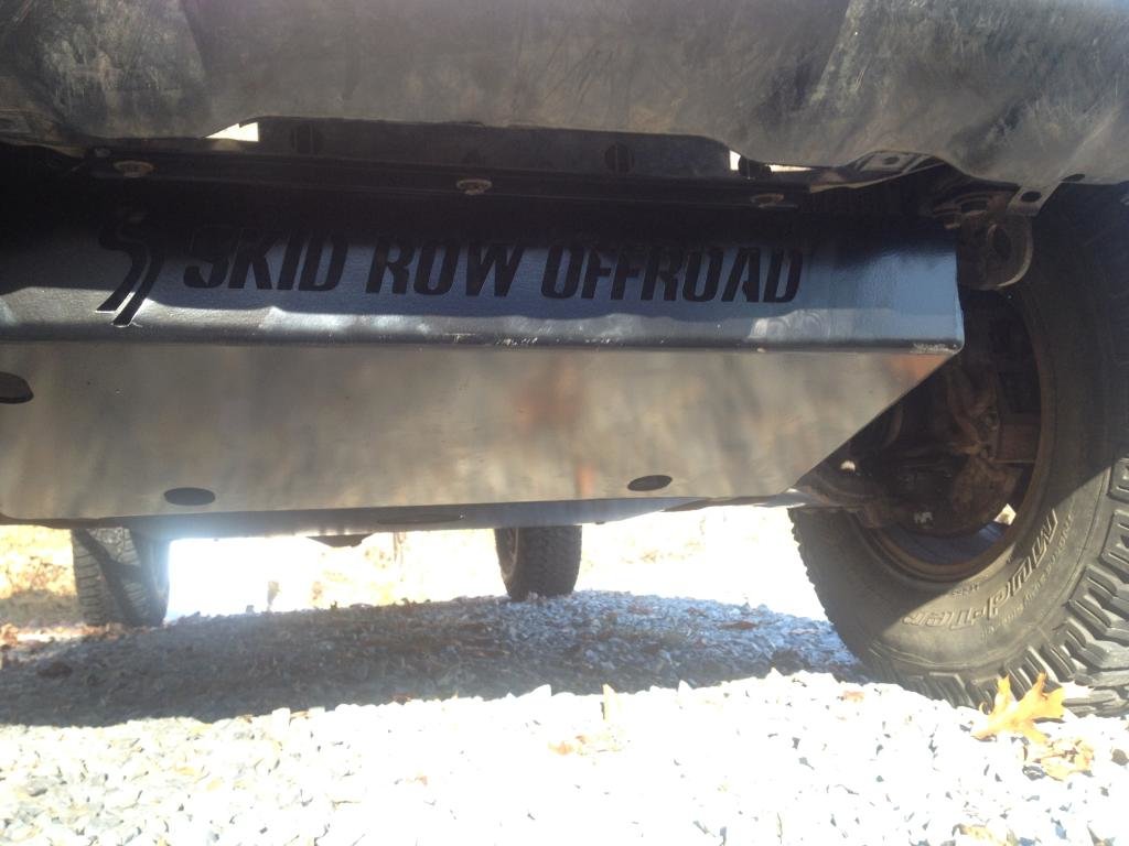

    I know you asked Lauren but I have some shots of mine so I figure I'll share them too.
    IFS skid:
    T Case:
    Def want to re-enforce the t case skid a bit more at some point.

    ^^looks good! I didn't get the transfer case skid, just the front and transmission one.
    Will do! Should hopefully have it on within the next day or so. Changed my oil while everything was out of the way today lol
    I jumped on it as soon as I saw they were cheaper than the Bud Built. I don't know about other brands but the differences on the Skid Row vs the Bud's I noticed are: countersunk holes, come powdercoated, holes for changing oil, and extra bracing on the back part of the front skid.

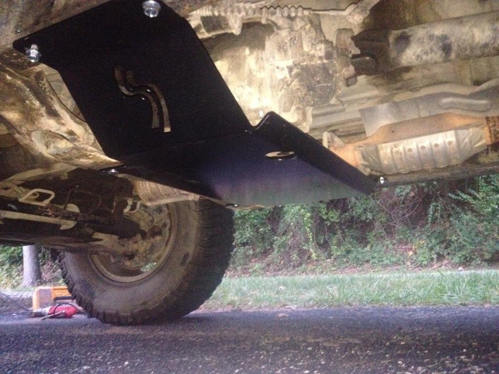

    Cynicalrider, do you have a diff drop at all?
    We made some progress with mine today:
    The diff drop does make it a little bit more of a PITA to install. Kind of didn't cross our minds that if you add spacers to the middle area of the front skid, you have to space out the front as well because it throws off the angles. Also, the carriage bolts they provide for the transmission skid interfere on the passenger side with the catalytic converter. So I need to get one a little bit shorter or just cut it.
    As you can see it's still a WIP, got some bolts in, but only one holding up the front currently :laugh: We got tired of making so many trips to ACE Hardware today through our trial and errors...and also one case of grabbing standard bolts that somebody put into the metric area -sigh-

    That sucks! Hope you can get it sorted soon.
    No diff drop here because I am still wheeling on stock ride height. :eek:
    I don't plan on putting a diff drop though when I do lift.

    Like I said it's not too bad. It's just finding the right combination of bolts and washers lol
