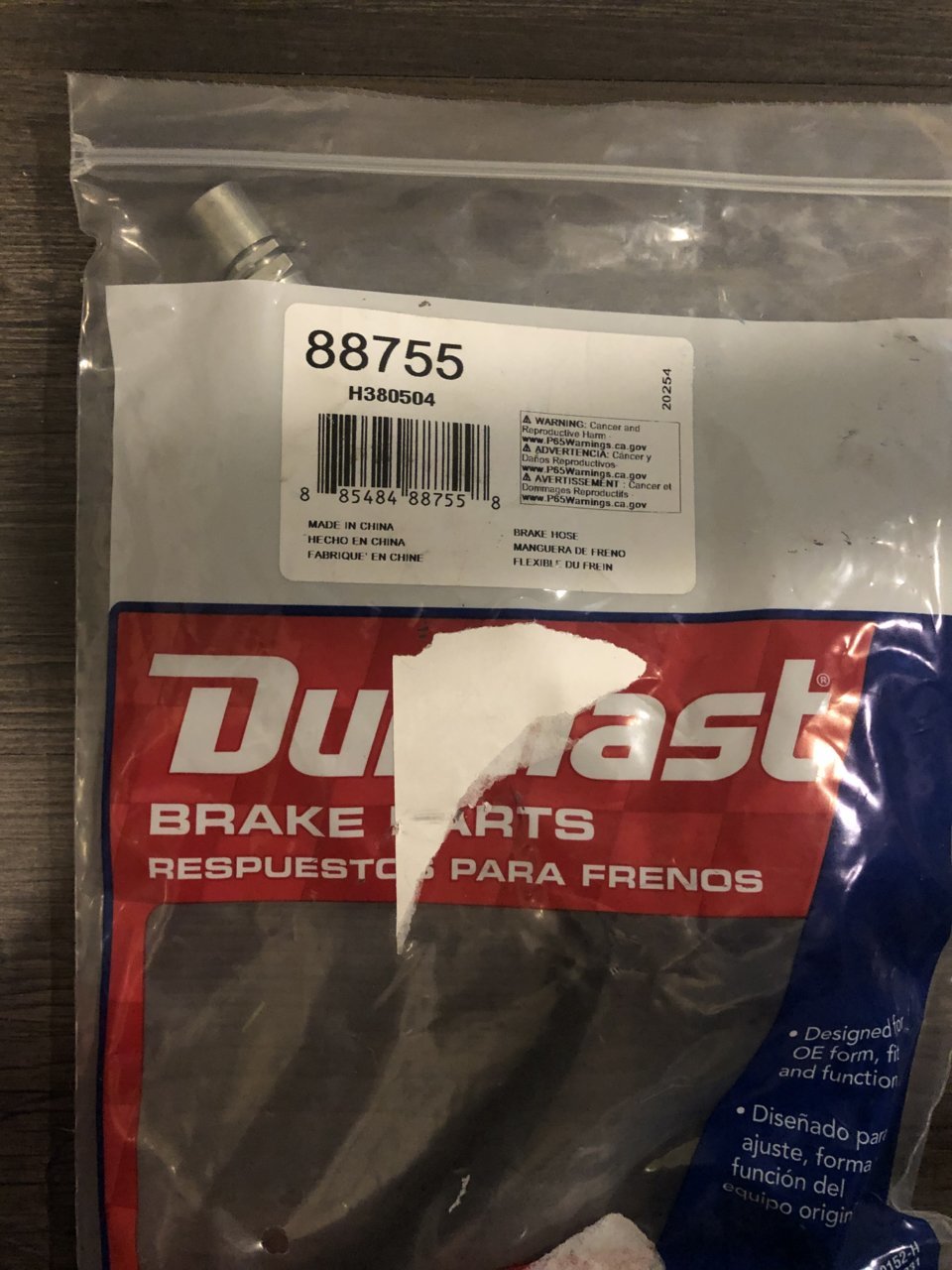

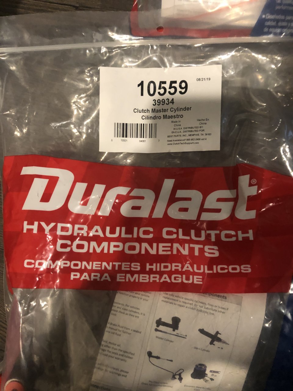

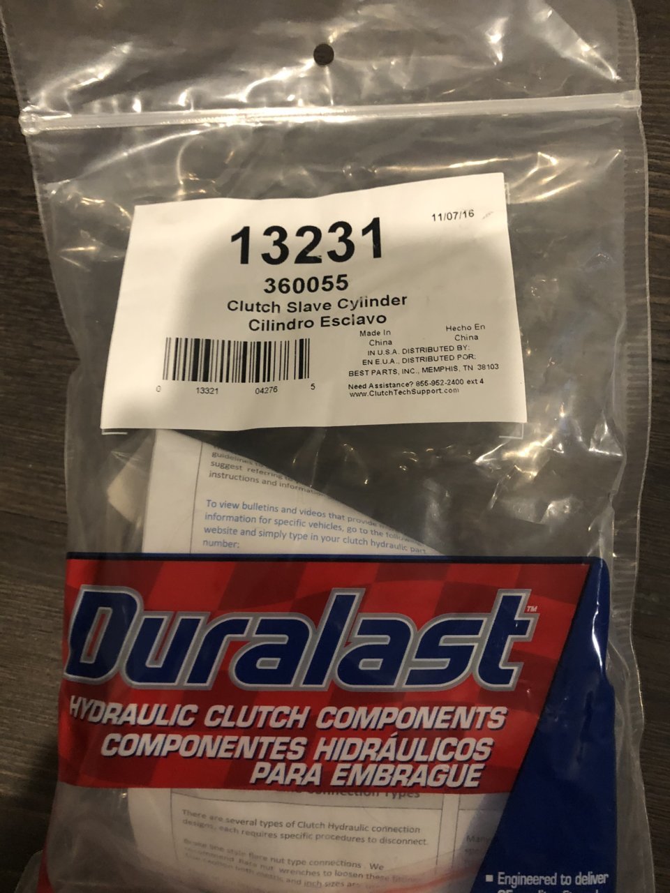

    I got everything swapped out and the line bled. It seems to be working great.
    I found out that the 11mm flair nut wrench is used for the bleed valve on the new slave/return cylinder. I got duralast replacements from auto zone. So if you’re sticking to the aisin oem parts you won’t need it.
    So to answer my question you’ll need: -10mm, 11mm flair nut wrench
    -10mm, 12mm, possible 17mm sockets with 6” extension and 3/8 ratchet
    -DOT 3
    Possibly a new break hose
    EDIT: I haven’t done the line yet because I am working with a small amount of tools due to my truck being broke into.

    I can only hope you have better luck then me with your Auto Zone parts maybe they have gotten better.

    I work from my truck and needed it running by Monday. I read in the forums there’s a rebuild kit for the master. Not sure about the slave cylinder..? But am hoping to rebuild it so when the auto zone parts fail I’ve got a backup. Don’t have much faith in them lasting that long. Read horror stories of them failing out of the box.
