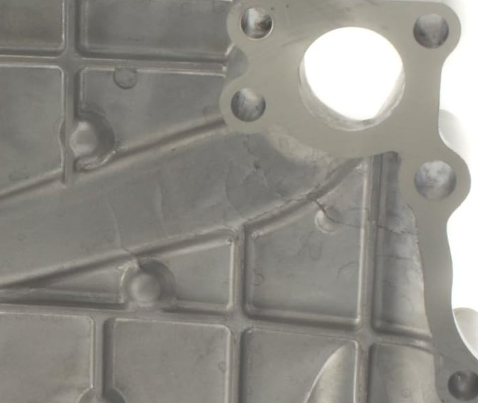

    Thanks, I appreciate your comment. I am no expert in how aluminum castings are supposed to look, but the worst one, the one I tried to highlight, it seems to me is an actual crack in the metal. It continues on down several inches along that surface until it hits a more solid structure (a thick wall), just like a crack would. And on the flip side of the casting, you can see an impression that suggests that the crack goes almost all the way through the material.
    A close look at the metal surface shows numerous small "hairline" cracks, almost all of which are along the water passageway, and they look (to me) as if formed by metal fatigue after 23 years of heat cycles from being used in the Tacoma, and the water passage just might break up in chunks some time in the future if I continued to use it. That's how I had been interpreting them until I read your comment.
    if an artifact of the manufacturing process, they formed during the cooling process of the molten aluminum, right? And quality control let it pass. And your experience says that happens reasonably often.

    I just found evidence that you are correct. If I can figure out how to post this photo, it is snipped from an enlarged photo of the AISIN timing chain cover made for my Toyota, and I believe shows exactly what you described.
    Clearly these are surface artefacts that are very similar to those I see on the backside of my timing chain cover. I cannot understand why they seem to associate only with the water passageway, unless it has to do with the non orthonormal sweep the passageway traverses, but there they are anyway, in a supposedly brand new aluminum casting. I would have thought that the manufacturer would have selected a better specimen to put on display.
    Thanks again for your help.

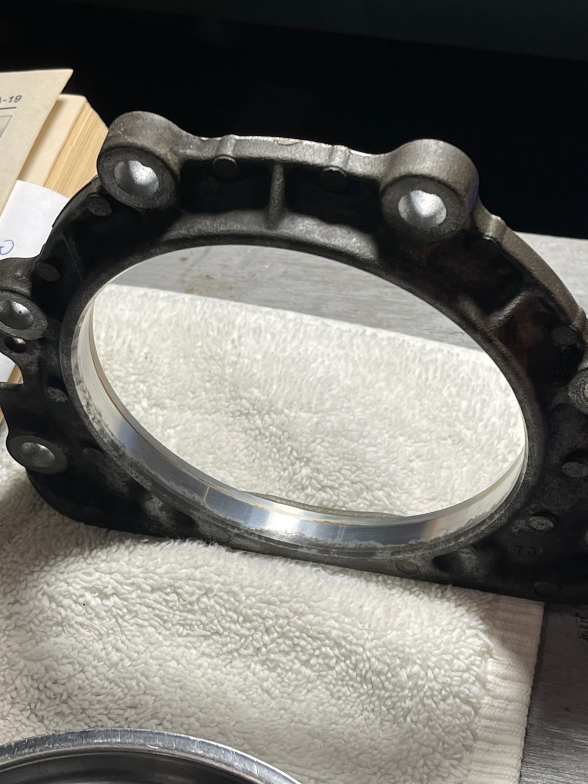

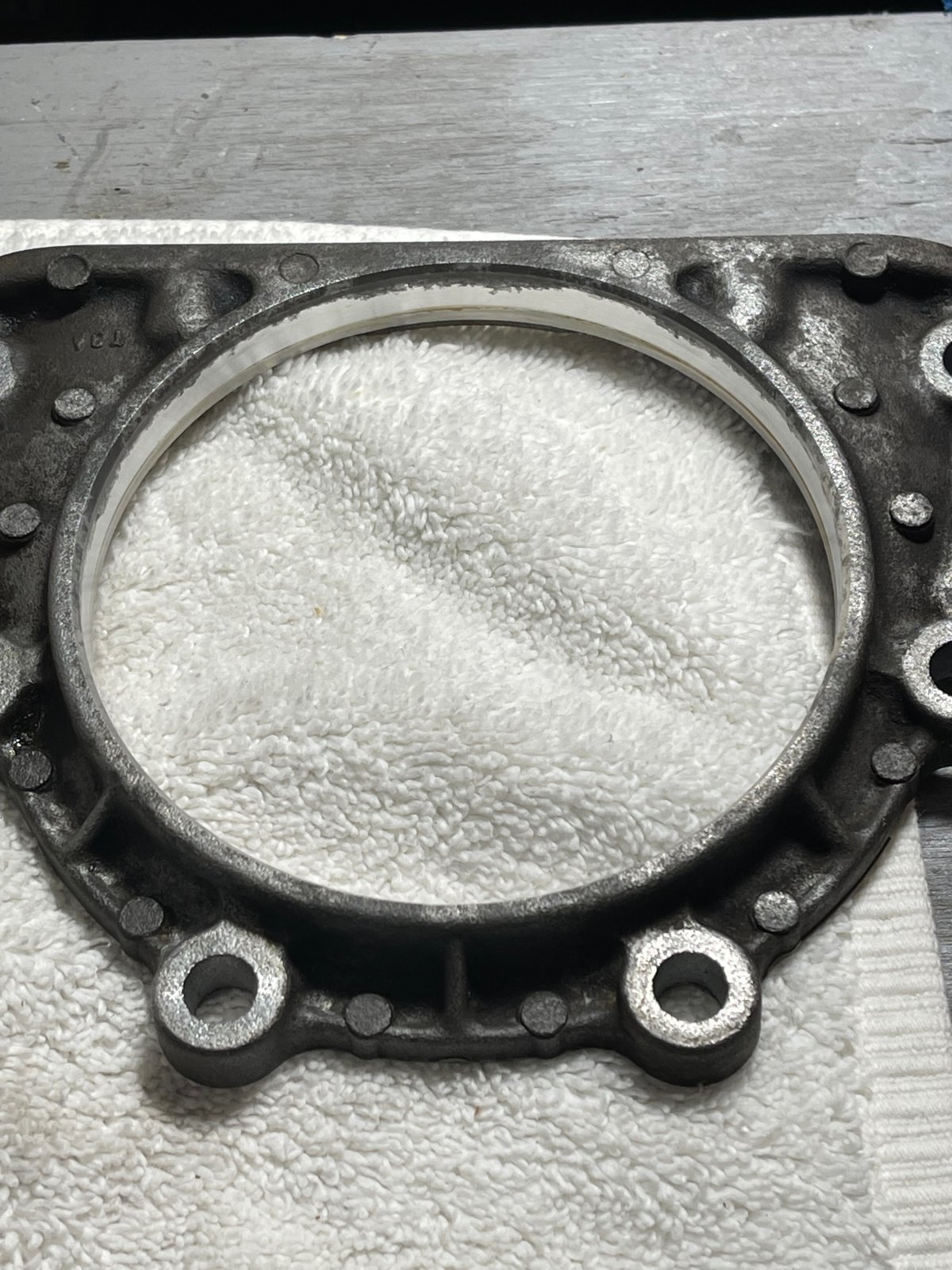

    Well, a lot has happened since I first began my oil sludge cleaning up by hand without taking the engine out of the truck project.
    At the moment, I have the transmission out and am going to replace the rear main seal. Way back, at the very first evidence of the truck having an oil leak, I had visually determined that the rear main seal was leaking oil. I wasn't completely sure, but there seemed to be evidence of that. We put a plastic mat under the engine to collect any drips, and it continued to collect oil for several years, up to the point where I had to take the valve cover off, because I feared the leaking oil spilling onto the exhaust manifold might cause a fire (so much smoke billowing out), and with the valve cover off, I discovered the sludge. That's where this project started.
    BTW: Getting the transmission out without taking the engine out is a dicey proposition in this particular truck (2000 Tacoma 2WD regular cab 5-speed MT 2RZ-FE 2.4L engine) because the cross-member that rides under the rear of the transmission is welded to the frame and cannot be removed (as is typically done) so the transmission cannot just drop down, hence getting the transmission out, once it has been separated from the engine, is a process (defined in the FSM), and it is tricky, especially if you have never done it before. But, it is out and I have gotten the "Engine Rear Oil Seal Retainer" off. I started to clean it so I can install a new seal.
    I discovered intrusion of discoloration (presumedly aluminum oxide) on the lower edge of the round polished sealing surface, somewhat damaging that surface. I need advice about whether or not to replace this part in order to guarantee a good oil seal. I don't know what is needed to form a long-lasting oil seal with aluminum and am looking for somebody who knows and can tell me to buy a new one, or not. I have used Scotch-Brite to rub the surface to try to bring back the polish, but nothing stronger. And I didn't work on it very long.

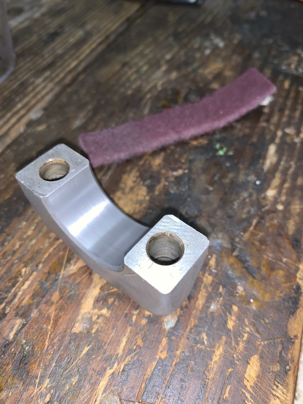

    i think a red brillo pad will def get that surface better
    as you said....dont go crazy
    i think i have some pix of my cam carriers from another vehicle
    i will post b4/after pix shortly

    IMG_0274.jpg Before /afterIMG_0273.jpg

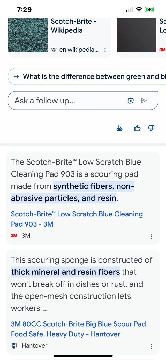

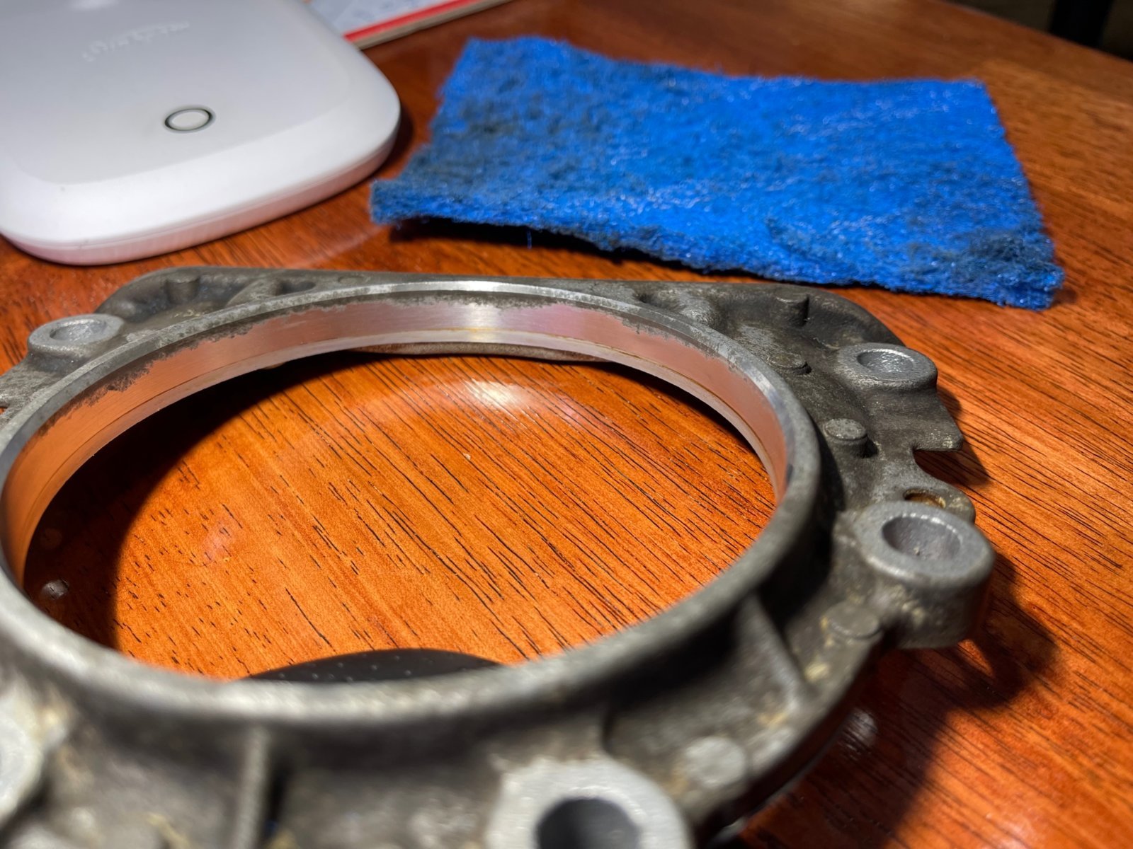

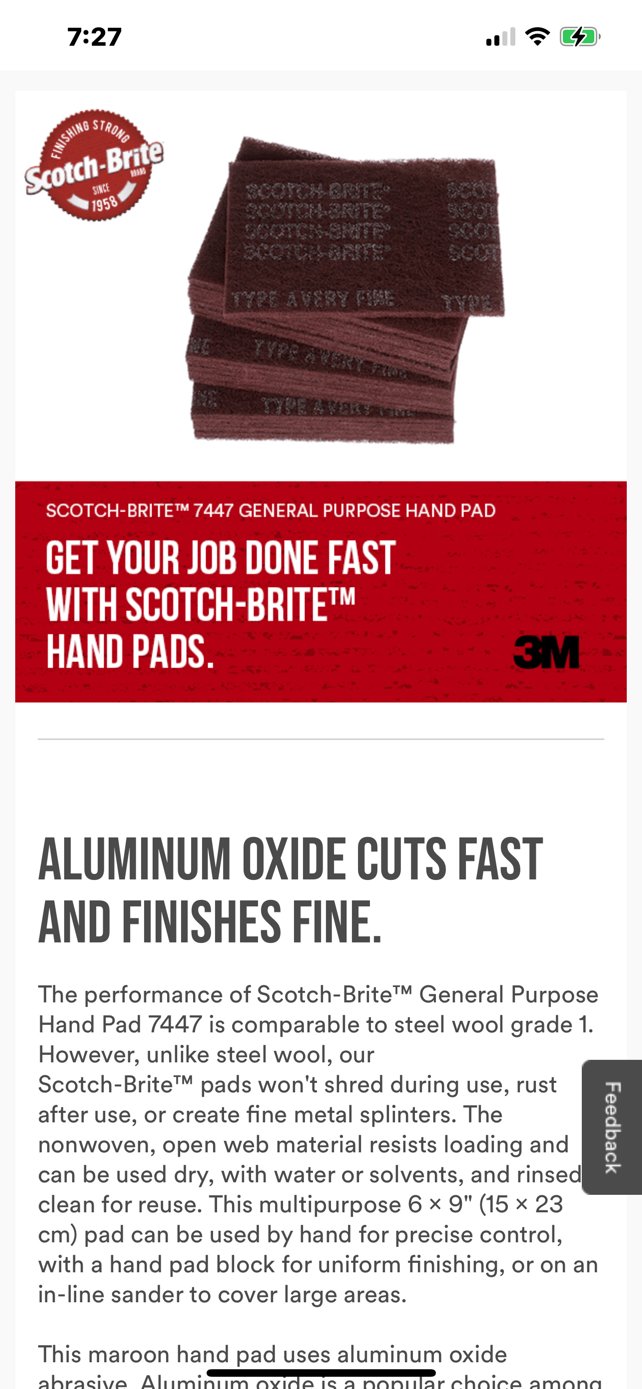

    Appreciate your reply, ControlCar. When you said brillo pad, I was thinking of the soap impregnated steel wool pads. If I understand your pictures, you seem to have used scotch brite, like I was using, only the color of my scotch brite was blue (soft) and yours is red, or red-ish, which probably has aluminum oxide particles in it (more abrasive). That's a good idea. (are your photos in reverse order, as the after seems to have scratches and the before doesn't?) Here is a photo of the blue that I was using.
    Ok, you are suggesting that I use a little abrasion to polish the sealing surface to get rid of the oxidation?
    Scotch Brite comes in different colors that indicate the amount of abrasiveness they can provide.
    If I am understanding you, I should be able to select a Scotch Brite pad with just enough abrasiveness to enable me to remove all of the finish mess and get down to a nicely polished aluminum sealing surface.
    That is where I had a problem in my thinking. I was wondering first whether the existing surface would lead to oil leaking if I just used it as it is and put a new oil seal into the retainer.
    My next thinking problem is that if I managed to polish off the entire sealing surface, and then pressed a new seal into the retainer, the diameter of the opening would be slightly larger than before I polished it out, and I was thinking that might not be such a good idea, considering that the seal goes in dry and is pressed into position. Do you know if the tolerances generated by that approach would still permit making a long-lasting oil seal? This afternoon was spent searching for a new retainer, but if the polishing will not lead to more oil leaking, I would be ok doing that. Trouble is, I just do not know for certain, and once I do that job and put the transmission back in place, I really don't want to have to do it all over again. The original seal began leaking a few years ago, but the Tacoma is now age 24, which means that seal lasted a long time as it came from the factory.
    That's all I can tell you at this point. I do thank you for the advice.

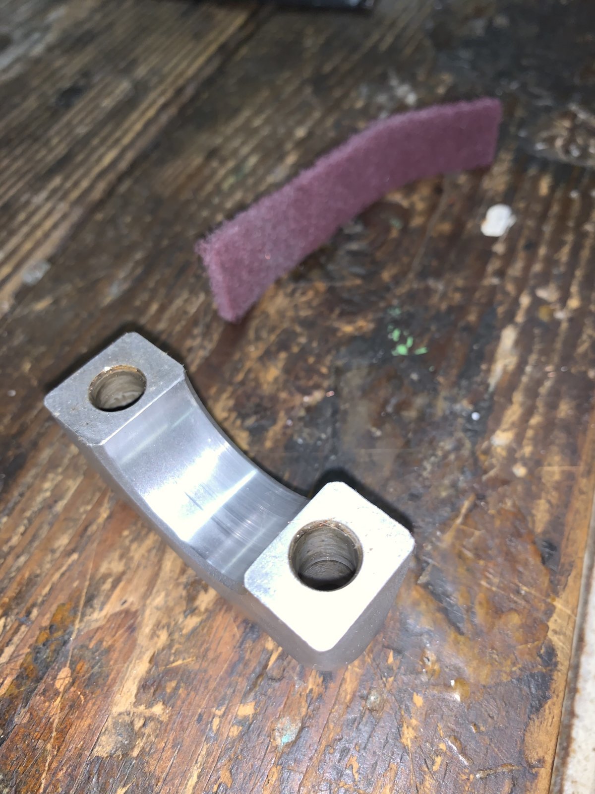

    1-a machinest told me about ‘red brillo pad’ was best BUT quote: “less is more”
    DONT hulk it scrubbing surface
    I used brake cleaner as lubricant
    Seriously 4-5 light pressure even passes on cam carrier surface. Took out that scoring
    Now on that cam carrier, my choice was get scoring out as best I could or buy new $2600 head(tht small part not available unless assembly bought)
    It worked.
    2-yes, before/after pix got swapped somehow
    3-remember, my use was metal to metal
    Cam (forged steel) to cam carrier(soft aluminum)…..much less tolerance for a screwup from taking too much material off mating surface
    In your case rear seal(rubber) that needs to be tapped in to aluminum
    You have crap ton more ‘wiggle room’ than I did
    I agree with you that current seal mating surface needs to be cleaner
    If not, over time, that is where the leak will start
    I also like your idea of using pads like sand paper….start out rough finish with fine
    Man for seal surface, I wouldn’t rule out using 1000-1500 grit sand paper LIGHTLY as 1st step

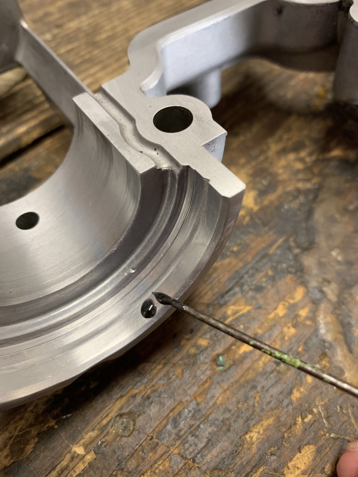

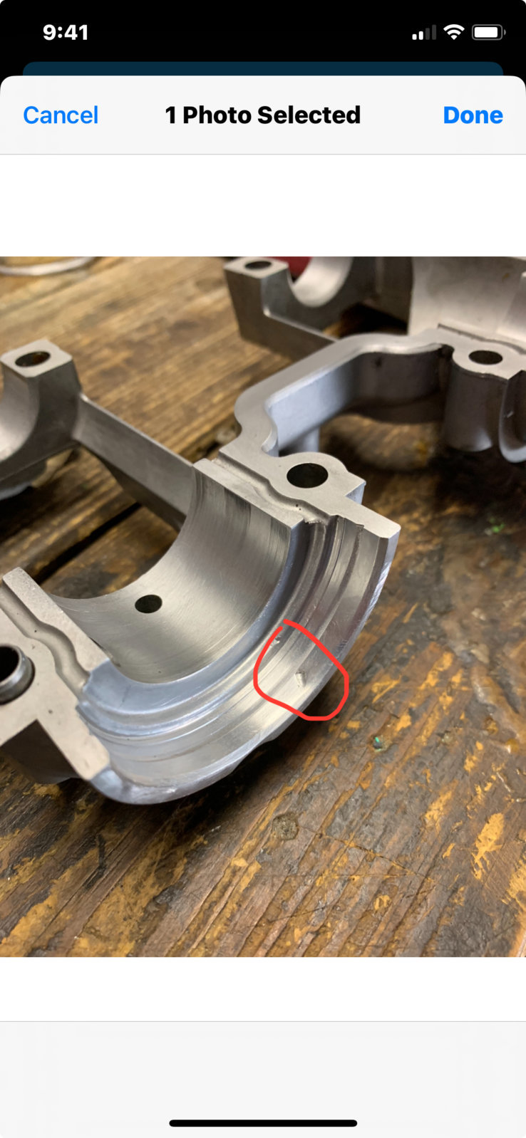

    4-last trick is IF you thick u screwed up surface with too much sanding
    (Hopefully not an option)
    Ugh…..this is bringing back so many bad memories…..

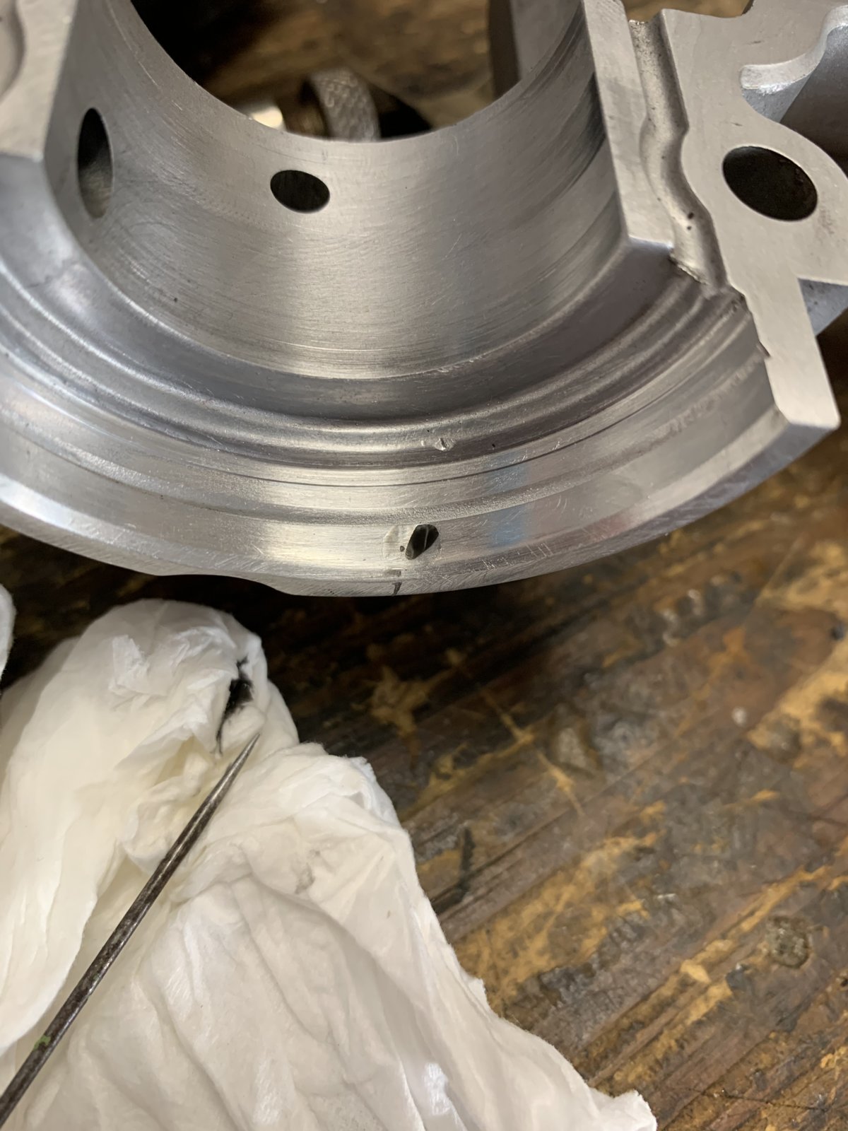

    again, $2600 or get it the best I could.
    Drill bit dinged my cam seal cup/surface
    Ahhhhhhhhh
    this is after a shit ton of 1500 grit sanding
  9. Jan 4, 2024 at 7:45 PM
    #29
    ControlCar
    ControlCar My Moto: Help & Learn…period.
    Jul 22, 2023
    #429578
    3,601
    Steven
    Sugar Land TX
    1996 Taco 2.4L 2wd Automatic
    Clock Volt meter/LSPV Delete/Hyundai 16’s/FP gauge/after 9months of wrenching ZERO oil leaks
    Again I went back to machine shop
    This front carrier part too small, would likely warp if alum added with heat/sanded.
    Owner said to do this
  10. Jan 4, 2024 at 7:46 PM

    Then sand smooth

    And for added security
    Thin layer of Fugi Bond(high quality RTV) around cam seal
    Manual advised to only use thin coat of mineral oil on tapped in cam seals
    I had no choice. did that to affected/sanded cup and other 3 other cam seals tapped in per manual
    Good to go
    4yrs running
    GL

    1-tht black pin drip was epoxy….for metal
    I Let sit 24hrs and then did the best I could to sand gently the curvature to match the aluminum

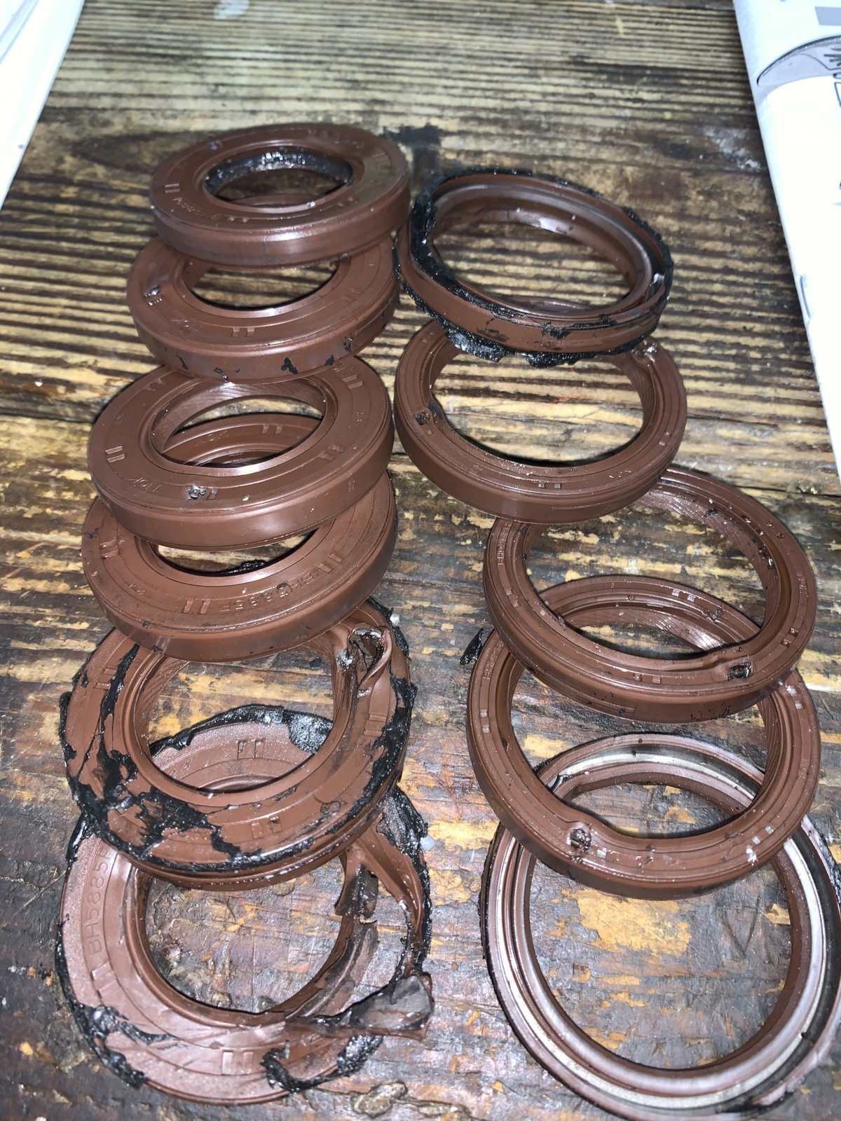

    11 used seals, OMG. . .
    Steven, your last paragraph makes a lot of sense to me. I am going to try that before considering buying a new retainer. Might take a bit of time to do it right, but that's only effort expended, not money.
    I counted 11 used seals laid out on your work-bench, and some of them seemed to be coated with the Fugi Bond (RTV) you were talking about. All those seals came from your Subaru 25SJ, from that aluminum cam carrier assembly you were showing the divot you repaired with epoxy? They came from the same vehicle? I have a couple of questions.
    First, my Tacoma has a 4 cylinder engine and under the valve cover live the two cam shafts (Input and Exhaust). There are no seals like yours living in there. In fact, the only seals like yours on my engine are the two I mentioned, the front and rear crankshaft seals. That makes me think that your Subaru is a V-6 or V-8, so it would have two cylinder heads, and each would have two cam shafts with seals on each end, maybe, if it has overhead cams? If so, that accounts for 8 of the 11 seals. You mentioned that you can replace the timing cover on your Subaru in 2.5 hours. Do you have to replace all of those seals each time you replace the timing chain or belt?
    If that is correct, what are the other 3 seals doing? If you had to polish all of the sealing surfaces for 11 seals, that might account for your talking about having PTSD from doing that job. Before I keep thinking of how horrible that would be, maybe you should straighten me out on where the seals go in your engine.
    Second question: you used the RTV on more than one seal, when I thought you only repaired one divot. What was the purpose for using it on the other seals?
    Final question: what was the epoxy you used to repaid the divot in the aluminum? I have used JB Weld a number of times, but it isn't a liquid like what you showed.
    Bottom line: I sympathize with you in having to change out 11 seals in the engine of your car. The way I am obsessing over a single, but important seal, my rear main seal (cause to get to it requires removing the transmission) must seem rather silly to you, obsessing over getting 11 seals installed but not a single one leaking. Congratulations on getting that job done!
