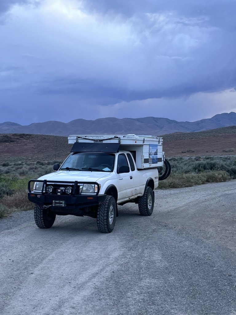

    I’d like to piggyback onto this thread with a related question. I have two different configurations I run my truck in. Most of the time it’s an empty bed or softtopper, however I have a Four Wheel Camper eagle that weighs in at about 850lbs that I install for trips.
    My current setup is OME 822s + nitrochargers in the front, OME Dakar HD leaf pack in the rear (with the overload leaf) with the nitrochargers that came with the package. I also have Riderite airbags in the rear that are kept at 5psi with the empty bed and upped to 35psi with the camper onboard.
    Neither configuration feels great, the empty bed is a real kidney smasher (too stiff) while the camper configuration feels underdamped (bouncy undulating highways cause the truck to buck up and down like a bronco).
    I’m wondering if there’s a shock with adjustable rebound speed that would allow me to be comfy in both configurations.
