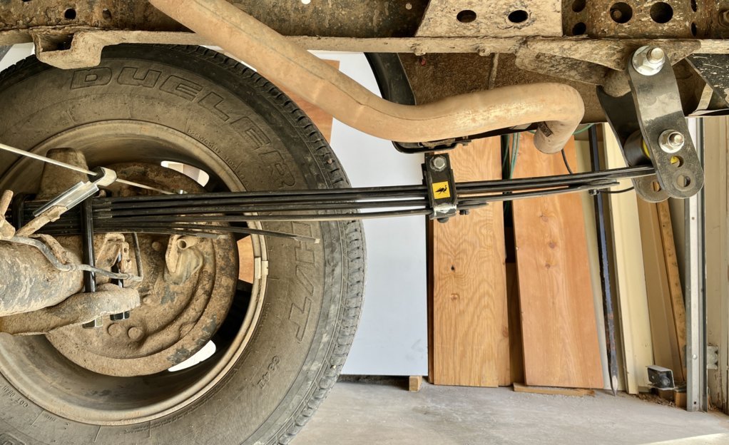

    Treyus30, i hadn't even considered these shocks might top-out! Now i've gotta go raise it and see where they stop. The kit *promised* they were long enough, and the lift is only 1-2", but still...
    My minimal "lift" is currently a soft conglomeration from the OME add-a-leaf and the Dakar set: one companion leaf and bottom leaf removed from the Dakars, and the tiny bottom add-a-leaf, well...added, because this soft set-up's got a lot of sag. Added adjustable shackles for experiment flexibility and relocated the tailpipe above the spring.
