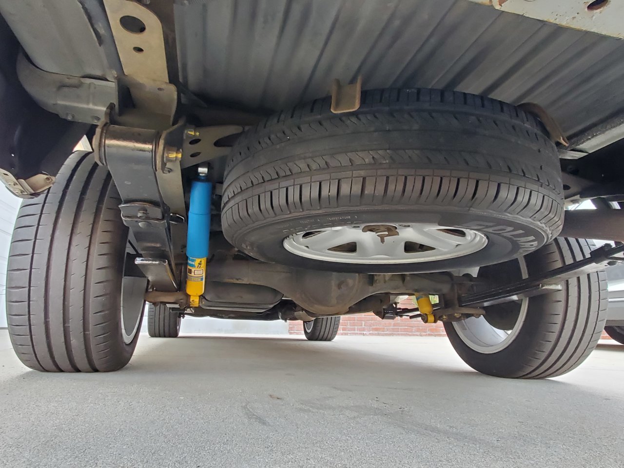

    Small modification: I used an angle grinder with a cutoff wheel and trimmed the ends of the factory spare tire supports. Filed down rough edges. So they no longer have an “L” or 90 degree bend at the end so it clears a 33” spare.
    Note: when lowering and raising the 33” spare on the cable system I must pay attention to the brake lines/cable around the rear diff and swing the tire a bit to make sure it doesn’t snag there.

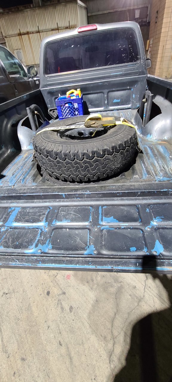

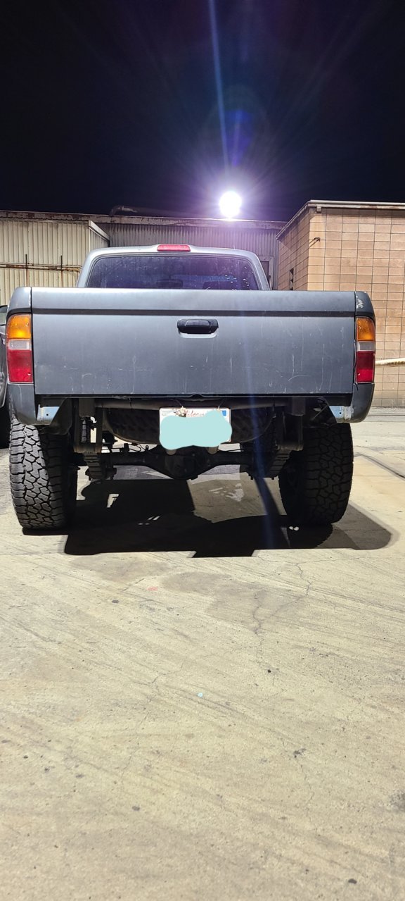

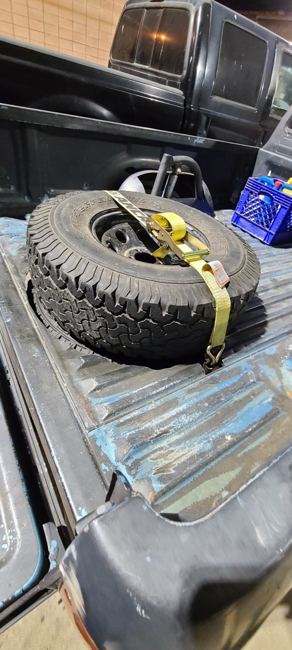

    2 33" spares laying down, held down by ratchet strap i got from a truck driver. I traced 1 tire to cut a hole in the bed then bent up some 1 3/4" tube to support it

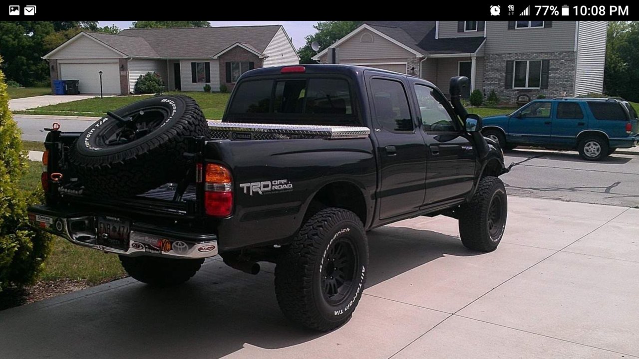

    01 SR5 TRD 4x4, '23 Bronco Wildtrak, 2017 HSQV FE350
    Drop bracket lift and booger welds

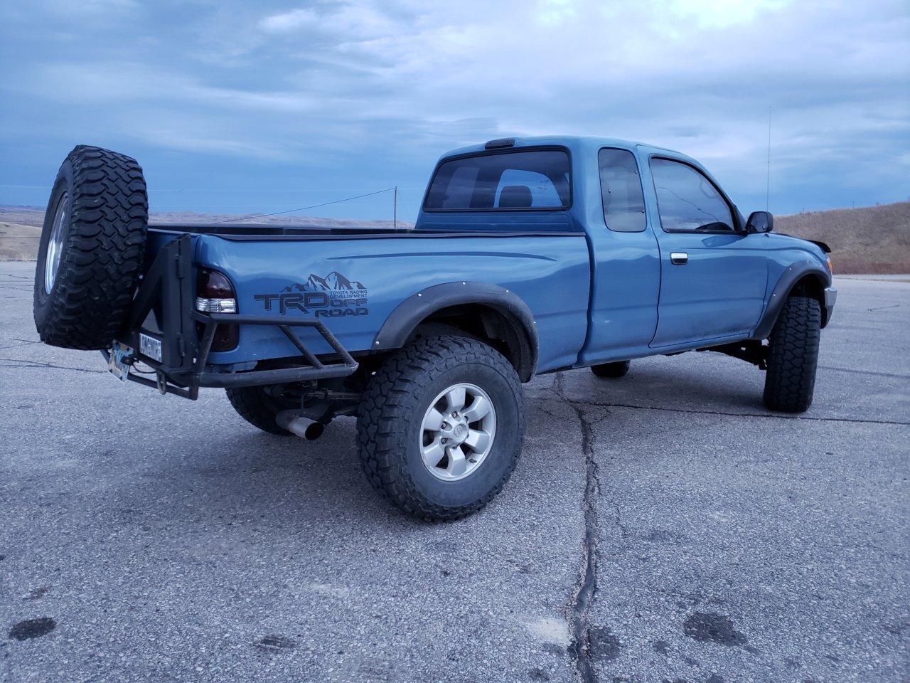

    Recycled an old lumber rack and some scrap tubing for this one. 20201113_164452.jpg 20201126_133022.jpg
