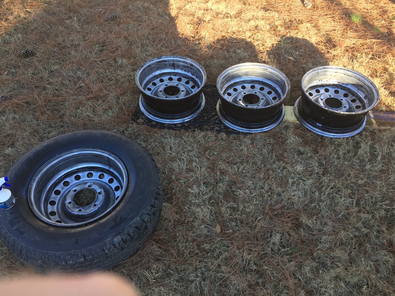

    Update: decided to completely strip the paint on the inside of the wheels. Too much crud built up and some rust spots and a few slightly pitted spots here and there. Giving myself a good substrate for applying POR15 to the insides. Will then topcoat that. The exterior side of the wheels are just going to be further degrimed and sanded for application of Duplicolor engine enamel. Will see how that works out. Wanted spray paint on outside so any foreseeable touchups are easier.
    Also side note, simple green is weak sauce on wheel grime, in contrast to what I saw on other forums.
    Was hoping to have the wheels powdercoated but the local reputable shop quoted $400 for media blasting+powdercoat total. That is way off my range. Which is why I am going the POR15 route.

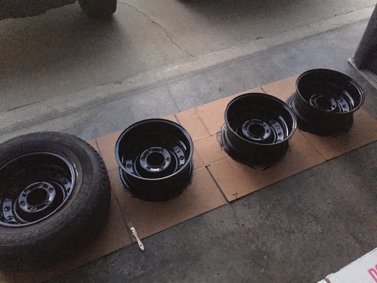

    Finished coating the wheels. Did POR15 on then inside of the rim and did Duplicolor semi gloss black engine enamel on the exterior over sanded down stock paint.
    Sort of after the fact I went and read some more reviews on POR15 long term results. Lots of 50/50 responses on either its held up great or is chipping/pealed off in spots. So we will see if I screwed up or not. I think the 50/50 comes down to proper prep. I did the degrease, then metal prep, and finally application stages on a wire wheeled/sanded bare metal surface with some surface rust here and there. My only real worries are hopefully it maintains a bond with the prepped metal as well as the rusted areas.
    POR15 Prepping after taking interior of wheels down to bare metal as best as possible:

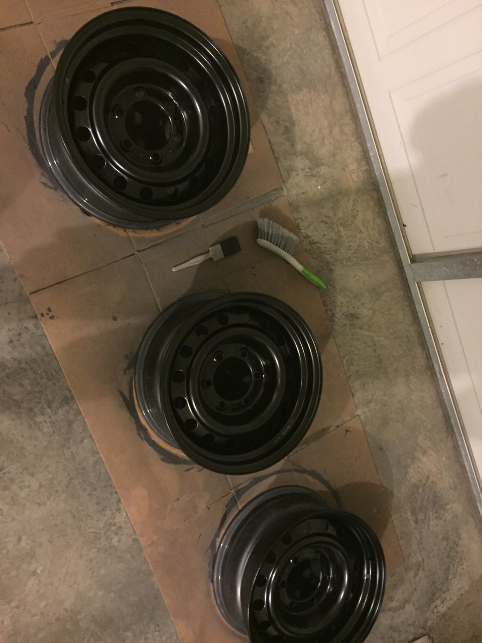

    Hit insides with POR15. Stuff went on really smooth. Only used maybe 1/2 a small can to do entire first coat on all 4 wheels. Took 4hrs to cure to a tacky finish so I could do th second coat. Left them overnight to “fully” cure.

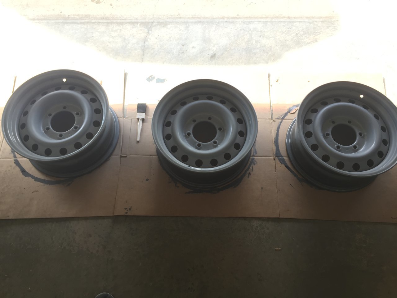

    Hit outsides with Duplicolor engine enamel primer:
    Final topcoat with the Duplicolor semi gloss black. This stuff apparently does pretty well in regards to durability/finish. Again, most negative reviews seem to correlate with poor prep. Surface was sanded with 320 grit and degreased yesterday while prepping for the POR15, then hit again with some alcohol prior to painting.

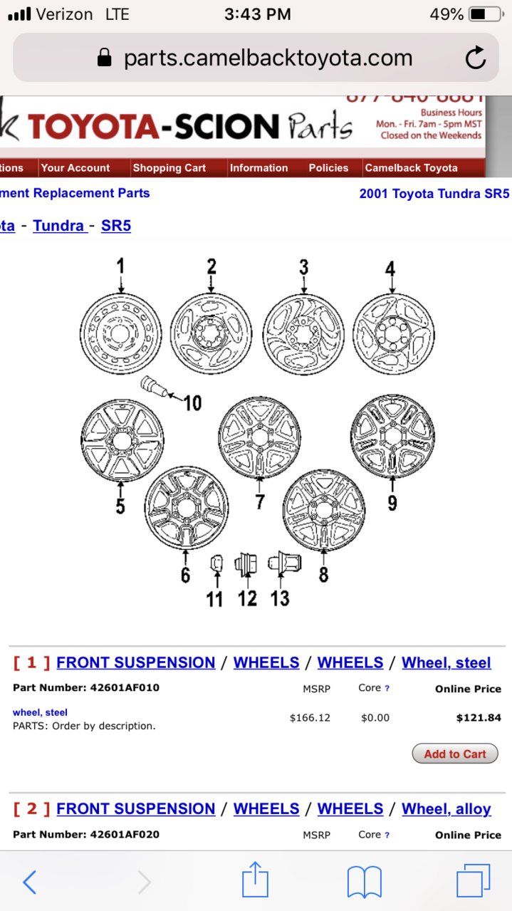

    Item #1 in the pic is the wheel with the part number listed below it. I eBayed all four of mine for $50 each.
    And then for TPMS, the part number at least for my OEM 2013 sensors is:
    4260706012
    It is the 20 degree angle sensor meant for alloys but fits the spare wheel style OEM steelies perfectly.
    BS on the wheels is like 4.625”. They just clear the stock calipers on the front. Didn’t need spacers.
