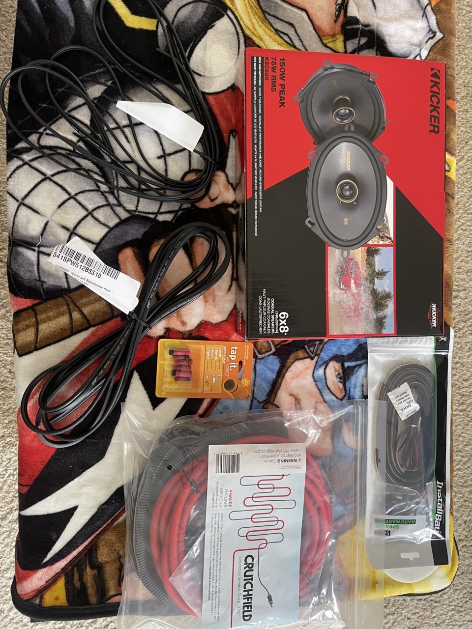

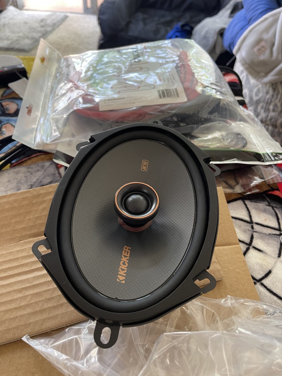

    Crutchfield.com has an abundance of speaker options to chose from. Luckily their website is very user friendly and helps you filter out speakers based on what your end goal is like budget, amp usage, etc. You can do what I did and actually live chat with one of their techs about what you want. I talked with Mulligan and I let him actually pick out a bunch of stuff and put it in my shopping cart for me to look at. This is what he went with for me.
