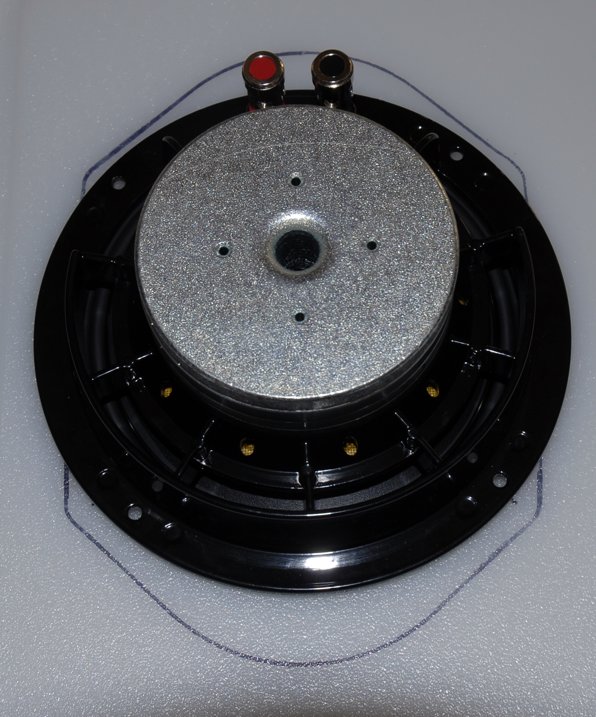

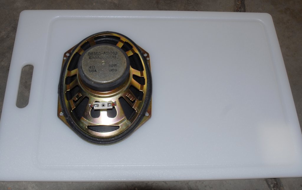

    I made brackets from HDPE cutting boards. Can't find the pics from the Seas for some reason, but here's what I did for the SI TM65s.
    Started tracing out the pattern of the stock speaker

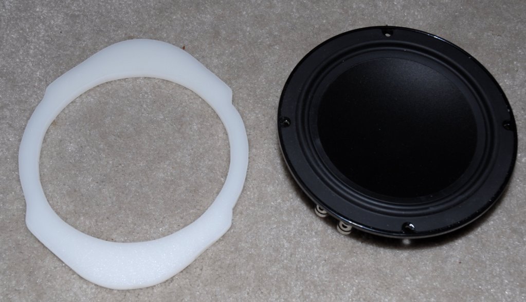

    Then cut out the inner diameter of the TM65

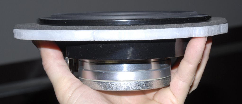

    Side view - to give you an idea of baffle thickness.

    Used a jigsaw for the cuts - then sanded. That stuff is really easy to work with. Works best with a fine pitch blade and going slow. Get the blade moving fast and it will melt the plastic.
