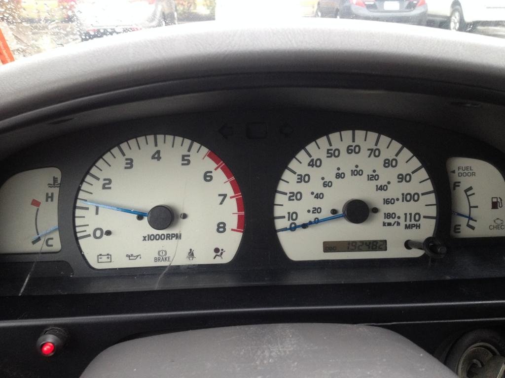

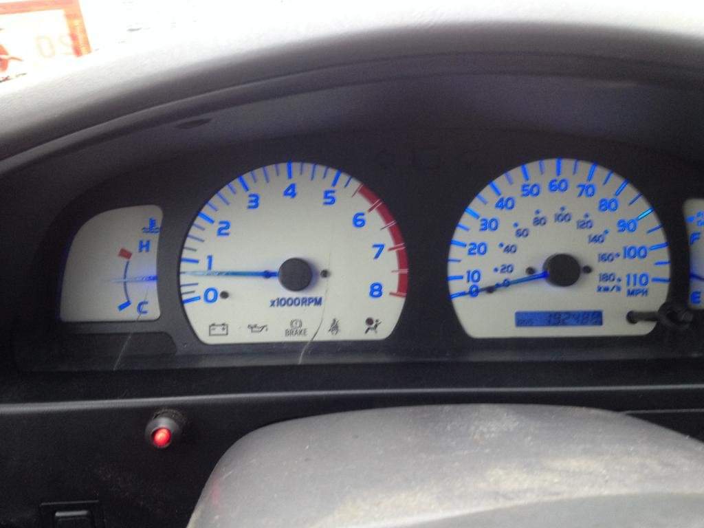

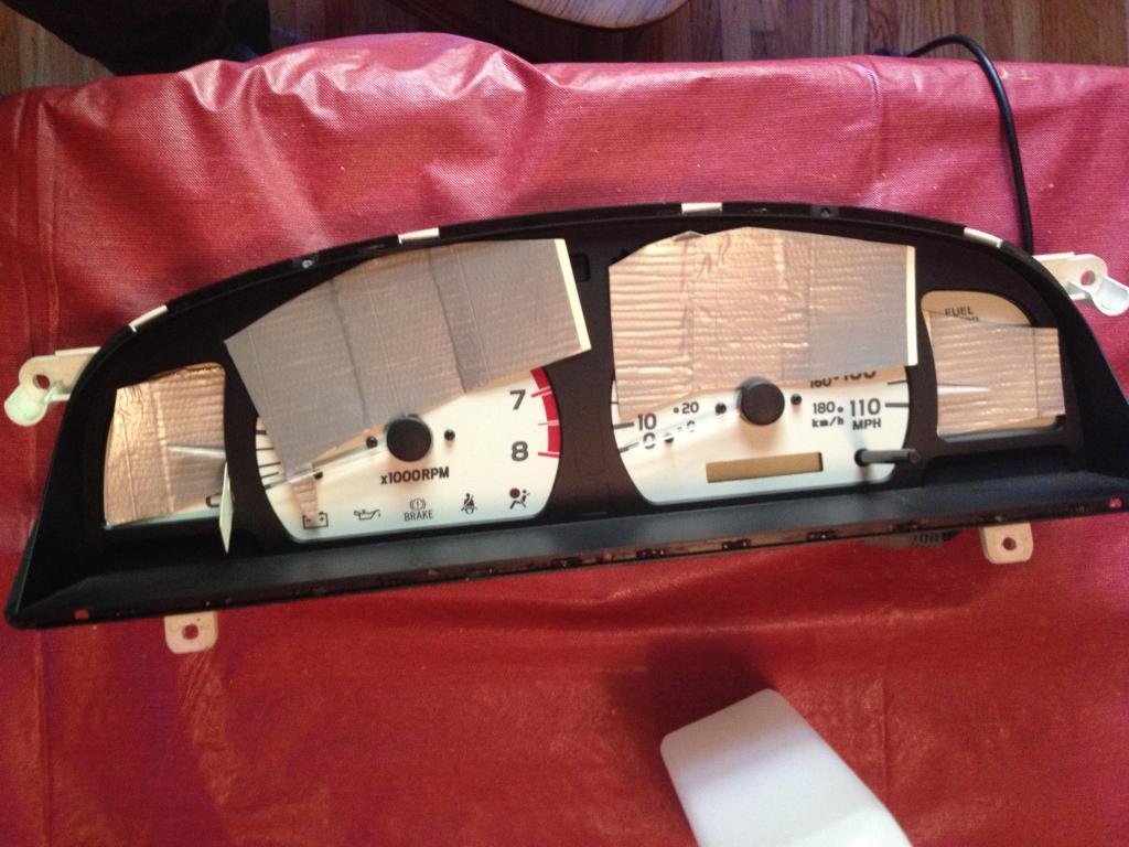

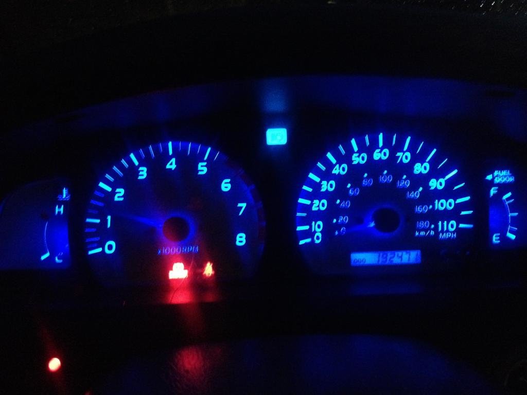

    I did this mod recently but never pulled the needles. Acetone and q tips will take the old paint right off. Applying the new paint was difficult but doable.
    Paint removed. I used this idea to mask at first but blue painters tape was much easier.
    Blue on blue makes night time visibility of the needles a little harder but not impossible.

    Very nice!!!!! I need to do my 4runners but never seem to have the time anymore. I originally thought of using something like acetone, but was scared it would eat the needles up. Glad to see you had no issues! They look awesome!
