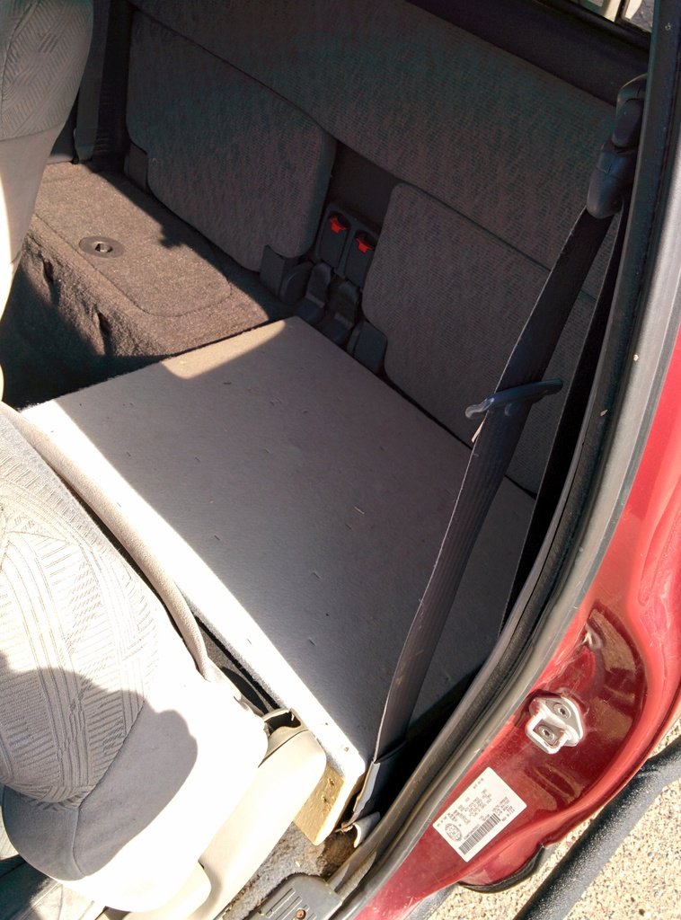

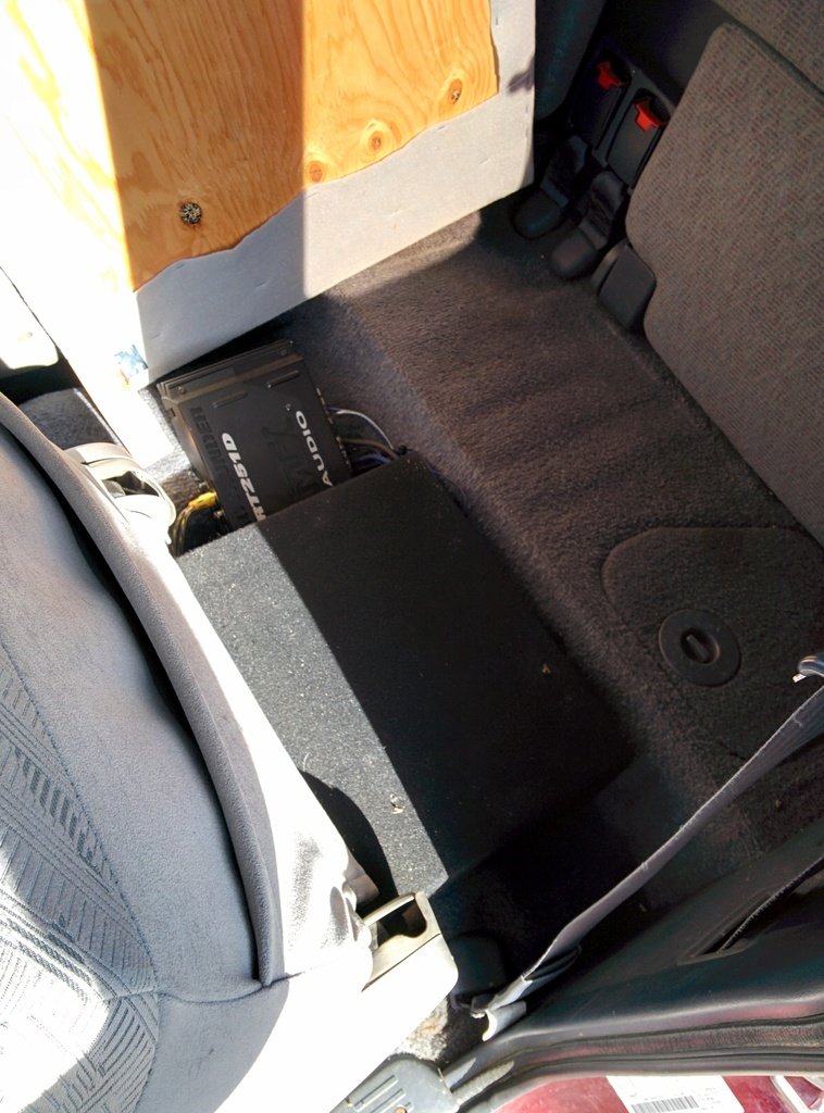

    I made a very small downward facing box for my 10" sub that sits behind the drivers seat on the floor, flush with the top of the rear bench. Then I put a plywood platform on top of there for my dog. Technically a person could still use that rear seat but not very practical with zero legroom.. Also you're limited on how far you can slide the drivers seat back but it works for me since im only just barely over 5'11"
    If I was to do it over again I'd probably get one of those compact sub's with a built in amp and put it under one of the front seats

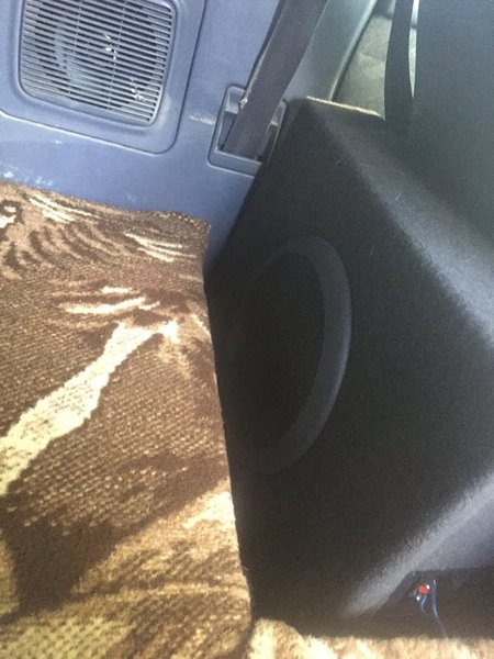

    98 Taco Max
    98 Taco Max Well-Known Member
    Dec 12, 2013
    #118446
    262
    Max
    Calgary, AB
    v6 Tacoma 4x4
