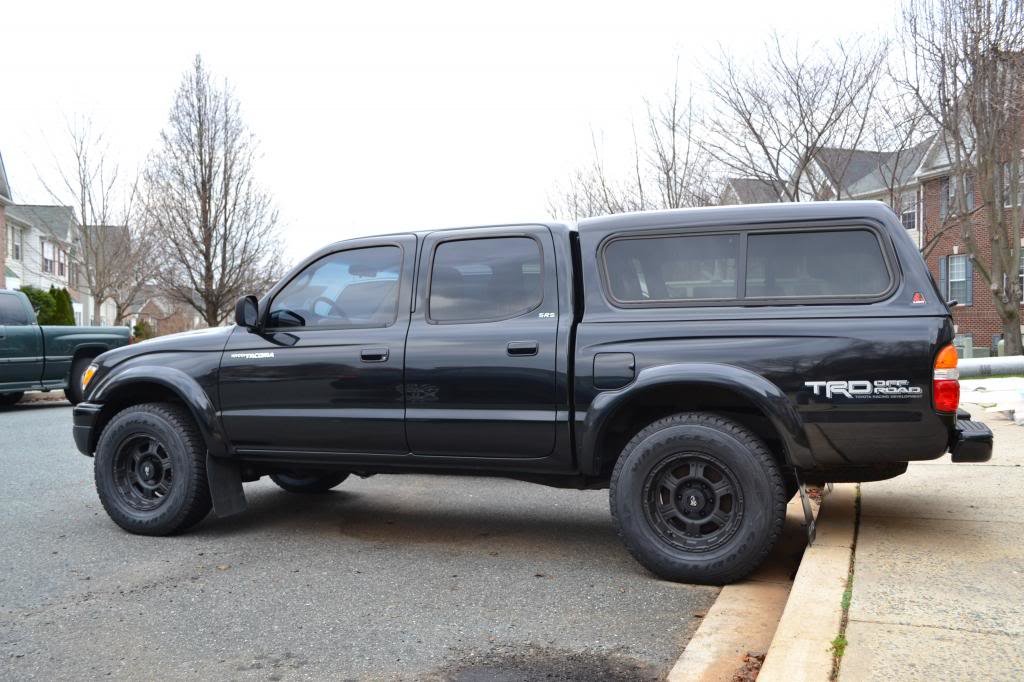

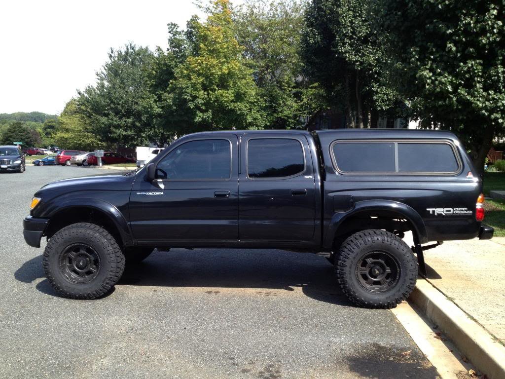

    Before:
    After:

    I am glad that I could help Joe. Post up some before/after pictures of your truck. We would love to see it!

    Just added

    Looks fantastic!
    I always wanted a cap for my truck.
