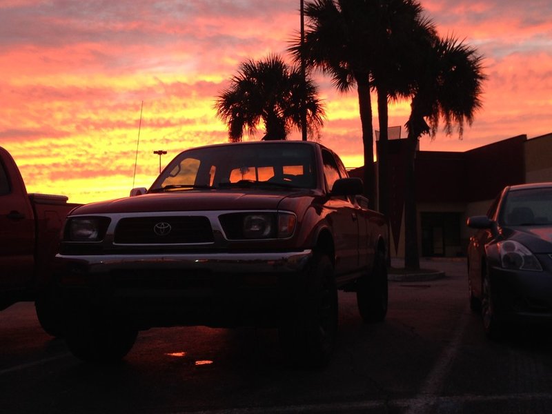

    hey guys. I finally have enough money to buy a lift kit for my '97 taco, But I have no idea which one to get. i want a 2.5 - 3 inch lift. I was just curious as to which lifts are better than others and what you guys prefer. i know you get what you pay for which is why i need the help from others who are more experienced than me lol. If anyone can put a link up to a good site to buy one and which one you think i should get i'd really appreciate it.
