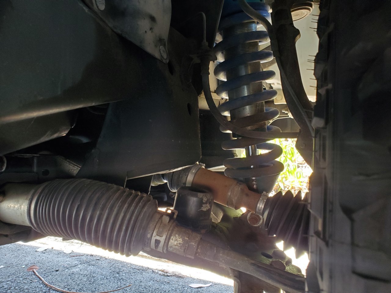

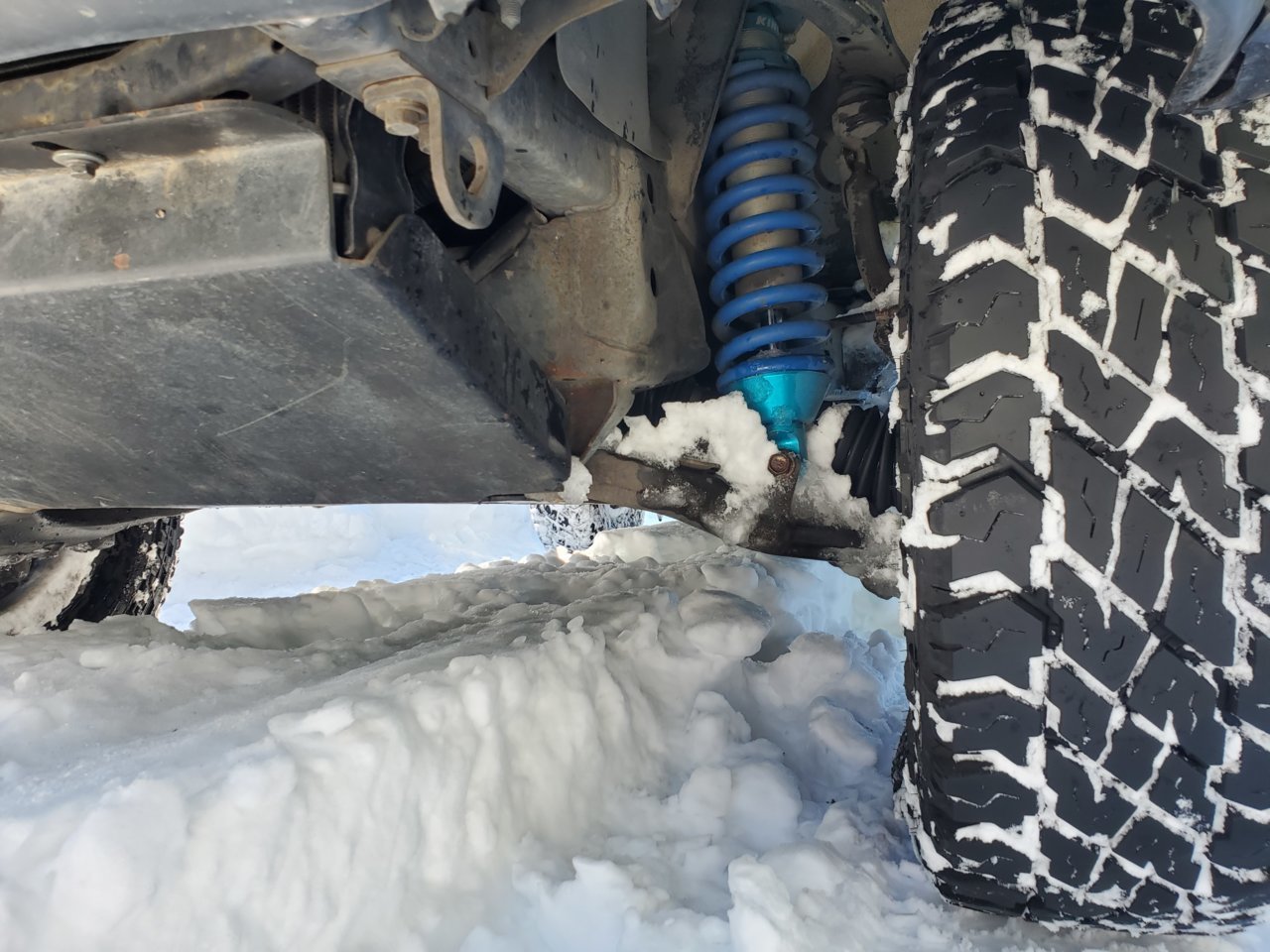

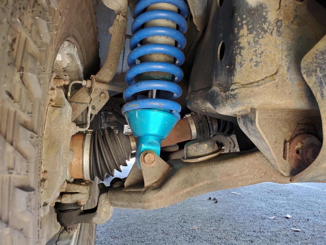

    Hey everyone. First time posting. I have been reading a lot of the amazing threads about suspension on here but still have a couple questions about front suspension to go with. About three months ago I picked up a 2003 3.4 double cab with an upgraded suspension. The owner before me used the rig for overlanding which I intent to use for as well and it is not my daily. The pickup currently has OME in the front and rear along with dakar reinforced leaf springs in the rear. Currently the pickup has a huge rake as it sits now. I know once the rear is loaded up with all of our overlanding/camping gear it will level out a bit but not the whole three inches in rake it currently has as the previous owner stated. I would like to bring up the front a couple inches and have been reading threads about the bilstein 5100s. I do have an aftermarket bumper I will be putting on in the future and want to make sure I have some good support in the front end. Since the OMEs on the taco are fairly new should I get some new springs to lift up the front or would a better option be the bilsteins? I am pretty mechanically inclined but do not have much experience with suspension components. Any help or suggestions would be appreciated!

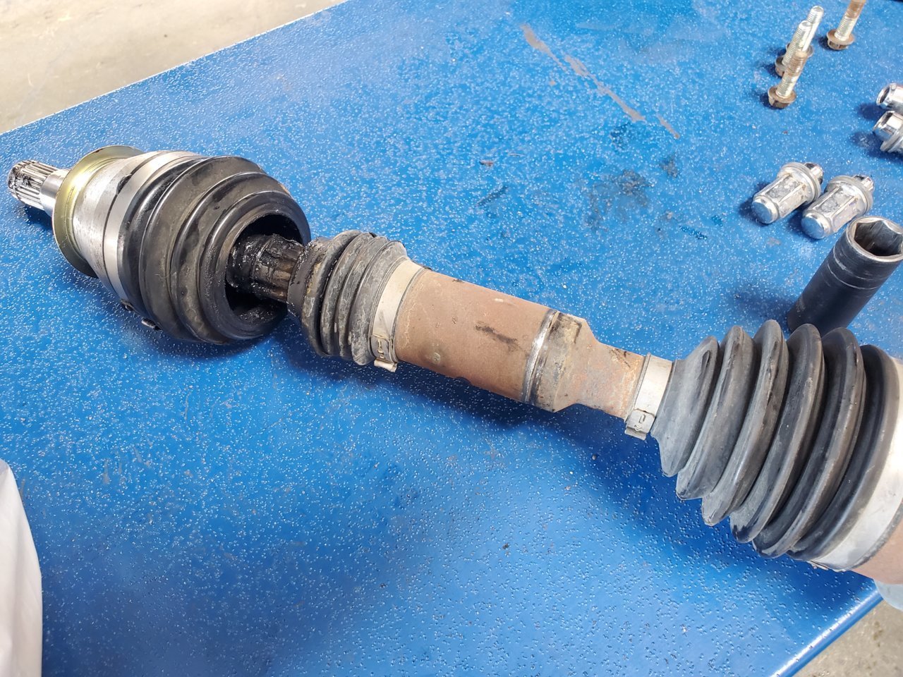

    Just be aware that if you add height up front you will create all sorts of issues with your CV axles (assuming you have 4x4). I put OME 882's up front and ran into so many issues with the cv axel angles and boots tearing that I finally just switched them back to the original ride height.

    That can be fixed by doing the bootslide mod or using the Oreilly offroad axles.

    Boots still rip :bananadead:
    You can do the snow mod to seal them up :anonymous:

    Regarding the CV axles, the boots are probably going to tear on you shortly after lifting your front end. If they're OEM, I'd reboot them at the same time you do this lift, to avoid them tearing on you in short order.

    I had the boot slide mod done on brand new oem boots and the boots didn’t Last 100 miles with the OME 882 lift. Giving up your oem cv axles for aftermarket ones is a big loss in my opinion. Also tried the diff drop, which did nothing at all. I think the OP would be better off taking that money and putting it towards a set of Alcans or deavers custom leafs in the rear that will maintain his desired rear height and weight load without giving him the unloaded rake. For me, the OME stuff was just money burned

    OEM axles are fine, but I broke a few of those while wheeling so it made sense to get the offroad axles from Oreilly, they have lifetime warranty and extended boots so it was a no brainer. I broke one of those too and got a brand new one no questions asked.
