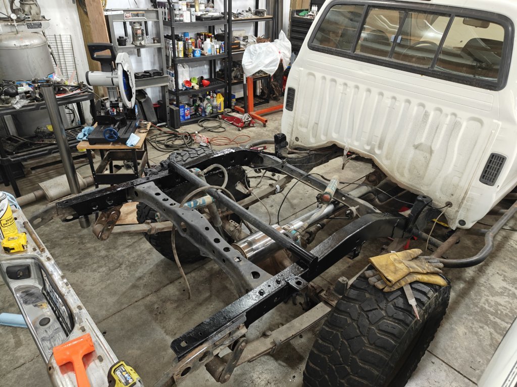

    Figured I'd come in here an bump this thread, the frame plates are a nice addition and install pretty easily, fit is really close.

    Ugh, I really need to do that at some point soon... Also gotta remove and replace the hack job shock relocation I did as an 18 year old and get some new shocks actually setup for the Deavers...

    I believe there's a reason for shocks to be in V pattern; not sure if having them in parallel without anything additional is a good idea.

    I believe it's supposed to help with axle wrap but I mounted mine parallel along with countless others and haven't had any issues.

    I did mine in a V pattern- it lets you fit longer shocks, but supposedly compromises stability. When I do it again, they will not be in a V pattern.
