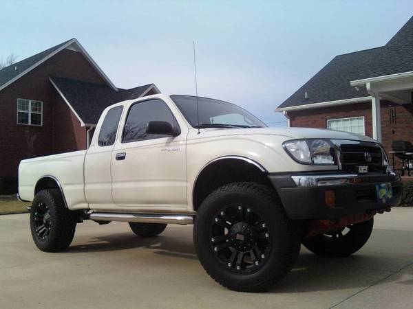

    and on another note, apparently Toytec stole my pic :eek:
    and thats not even a Toytec lift on that truck

    ha ha ive always wondered who owned that truck. so a set of 5100's and eibach coils will give enought room to stuff 33's? im not worried about gettin the hammer and saw out to it.

    and 17 year old bought that truck from me 6 years ago, and wrecked it about 3 months later. it is still running around, but the hood and bumper are back to stock.
    as long as they are not super wide and the wheel offset is right, you might get away with it

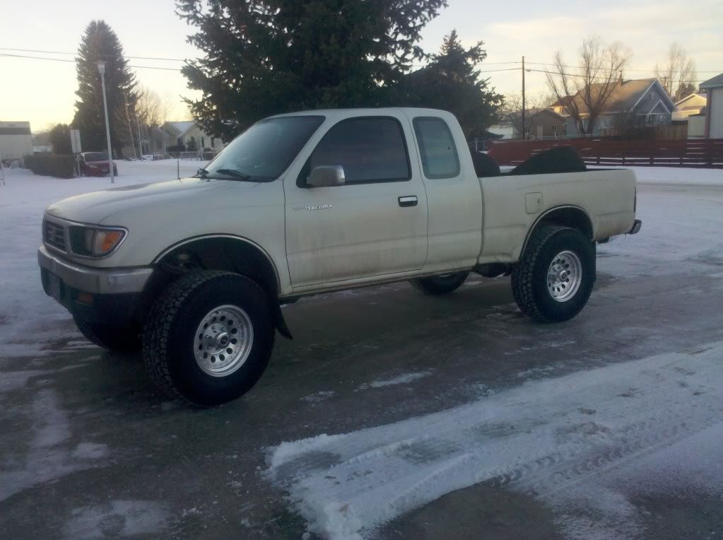

    Here is a pic of mine. i have a 2 inch leveling kit. and 32s. so 3 inch and 33s should work. mine does not rub much at all only when i reverse on unlevel ground

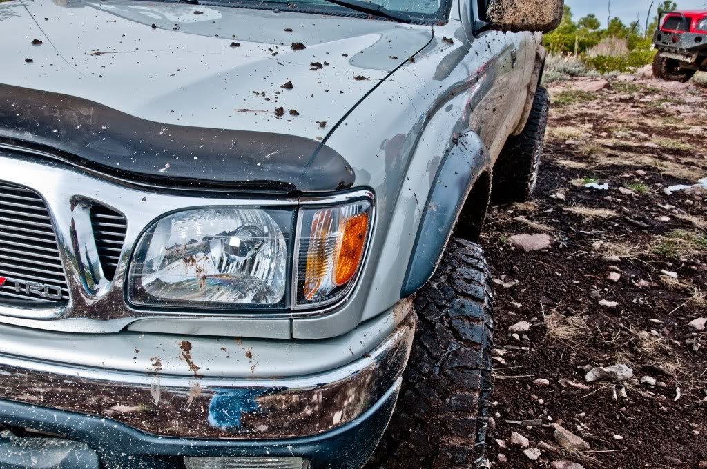

    Heres my 02 I use to have. 3" lift with 285/75/R16's only rubed a hair. Just did some trimming and the pinch weld mod, and was good to go.
    You could get the Toytec coilovers and set to 2.25" lift and be good, as long as you have a diff. drop. But thats the max.
