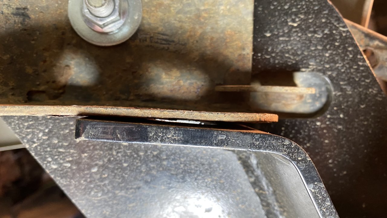

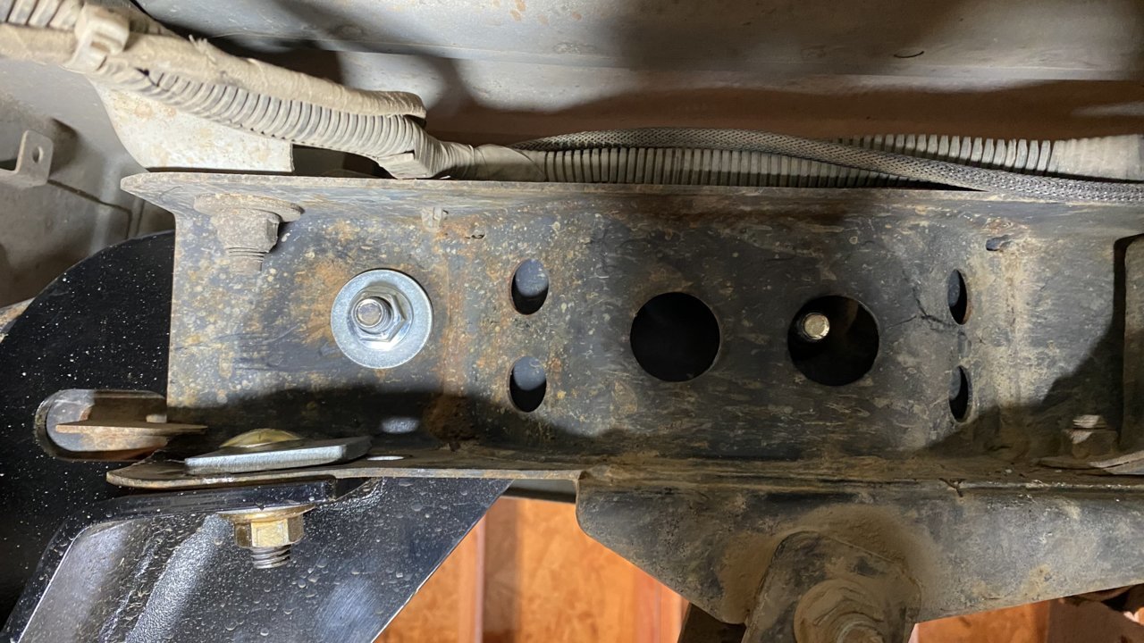

    The issue, and this is a gnarly and sinister issue, the flat plate the hitch uses to attach to the bottom section of C-channel on your truck, is welded out of plane of the two side mounting holes. Like, way off plane. So far off plane, my whole C-channel warped down when I tightened. So off-plane, I needed a friend and a six foot digging bar stuck into the 2" receiver, their weight on the six foot digging bar to pry down on it while I attached the wing bolts.
    This is the first hitch I've ever installed. Being as old as the truck is, and proven Curt hitches are, I didn't know what to expect. I torqued it all down, and I tell you, the amount that C-channel bent down to respond to the out of plane surface of the Curt (Model 13013) hitch, was impressive to say the least.
    The C-channel the Tacoma frame is made out of is a bit thin (in my opinion). Not something you want to put a lot of induced forces on when you're not towing.
    None the less, I reached out to Curt, spoke to two pretty nasty gentlemen. When I described the problem to the first, he said I installed the hitch wrong, I need to take a tap to the weld nut. I asked, what will tapping the weld nut do for my bent C-channel. He kept saying I need to tap it, clean out the threads. Then he went on to say, I need to take it to a trailer hitch installer to verify my install. I asked if U-haul was OK, he said it was, so off I went.
    U-haul was awesome. They took a look, and was like, yup, it's bent down, maybe an 1/8". The install was fine, it was the way the hitch was fabricated. I called Curt back, spoke to another nasty gentlemen, who said my truck was rear ended. I said, no it wasn't. I pointed out my truck didn't have a weld nut as shown on their diagrams. (side note: An early diagram of theirs shows a weld nut only in the front, a later shows two weld nuts. In place of a rear weld nut, I have an oval.). When I mentioned that, he said my weld nuts were sheared off, said their diagram is correlated with the factory, my truck is an anomaly (even though, as I mentioned, the earlier sketch of theirs shows just one weld nut like mine). He basically refused to listen to me. He said Curt couldn't do anything, this is an old hitch model, and they've never had issues like this. The only thing, Curt would support my return. I bought it from AutoZone, so instead of returning, I exchanged it for another.
    Low and behold, the other one came in, and still, that flat surface is out of plane with the side bolt holes. The interesting thing, it wasn't as out of plane as my original hitch I bought, but out of plane enough. I returned it on the spot.
    I went ahead and then bought a Draw-Tite (Model 75078). I ordered through Amazon. Horribly made hitch, overall. The welds were sloppy, the pieces not fitted together squarely and symmetrically, paint peeling off when you were just looking at it, in sheets. It was bad. The one plus, that surface was in plane with the two side holes of the wings (I unfortunately did not take photos of that). The major oddity with the Draw-Tite, the side wings are not symmetrical. For some reason, one is "fatter" than the other. I'm not sure why. I sent that back to Amazon.
    So I reached out to Husky Towing, asking about their hitch (Model Husky 69553c). I shared with them the challenges I had with Curt, sending them photos. It turns out, they get their hitches from Curt. The one I corresponded with confirmed, their hitch was the same, with the angled flat plate. So that's out.
    I also reached out to Armordillo (Model 7168060). I explained the situation. They have their hitches made by a third party, independent of Curt. They were really nice. He actually got a hold of one of his hitches from their warehouse, took a look, and confirmed, they also have that sloped flat plate (they described it as a 5-deg slope). He is going to reach out to his R&D team and look into it further, but this will take 6 months or so to realize.
    I know there is eBay, as a source of random trailer hitch manufacturers, but that makes me nervous, getting a hitch not made right, then having to wade through a scary return policy.
    I went ahead and just ordered a Reese (Model 51108) from Amazon. The challenge is, it's basically the Draw-Tite model. I'm kind of taking a chance, hoping this one is fabricated better? The reviews on Amazon seemed pretty solid, well see.

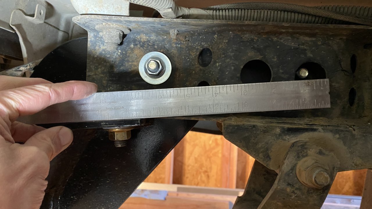

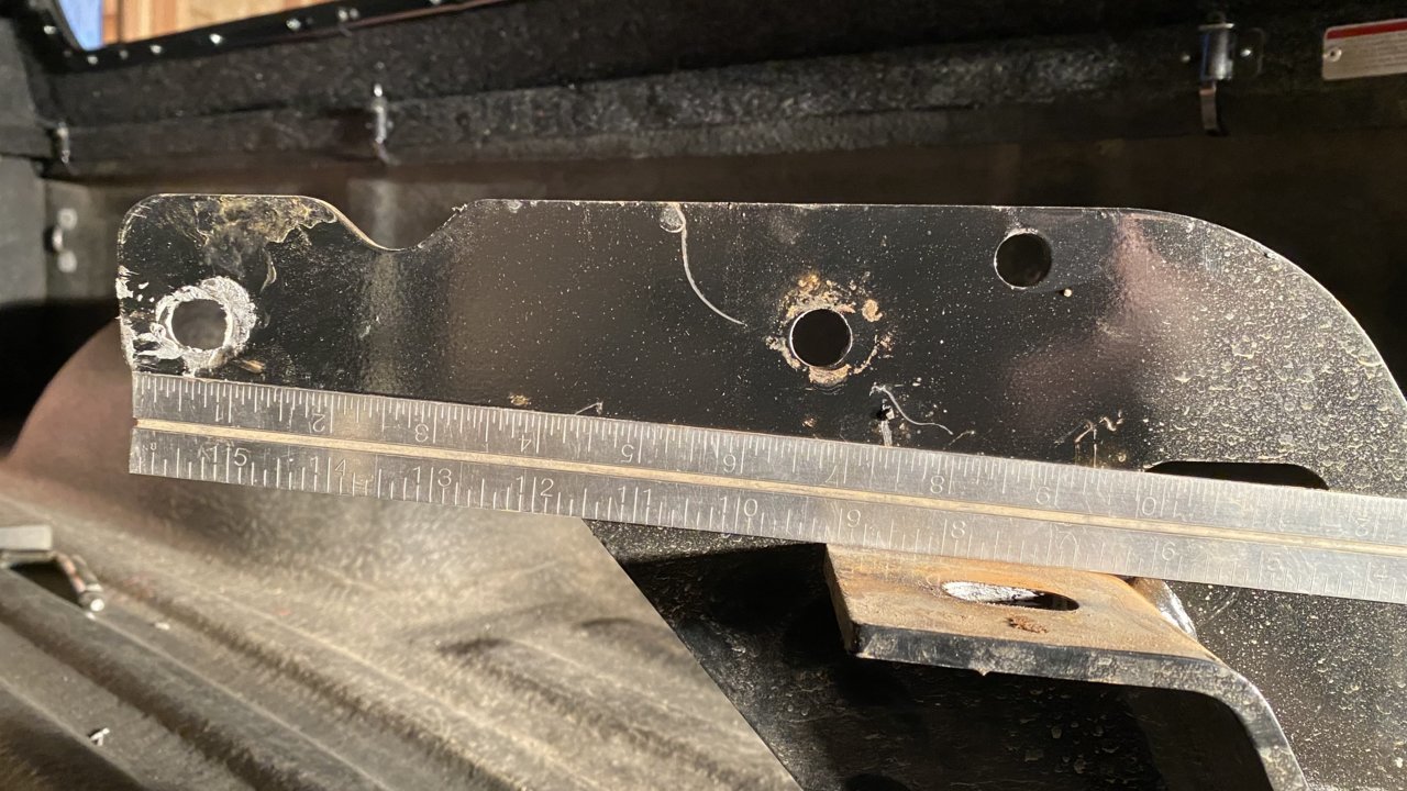

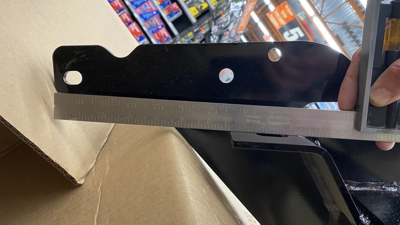

    Pictures below show some of the challenges with the Curt (Model 13013). The install is pretty clear from the clean store bought one. I used a metal ruler to help show how out of plane that surface is with the C-channel and the two wing holes. It's impressive.

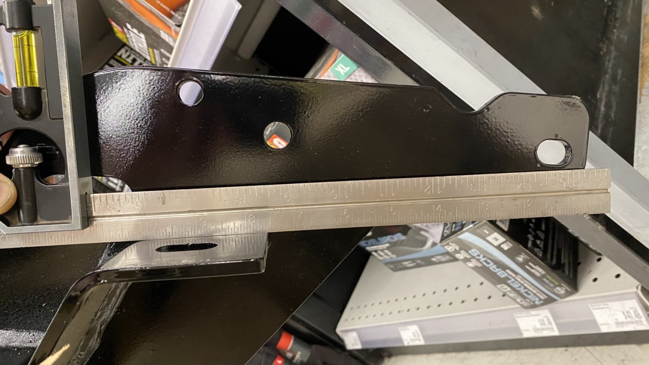

    The is a photo of the drivers side wing of the second Curt (Model 13013) hitch I bought, with that flat plate out of plane of the two side holes. I took this photo in AutoZone. I just returend the hitch on the spot.​
    The is a photo of the passenger side wing of the second Curt (Model 13013) hitch I bought, with that flat plate out of plane of the two side holes.​

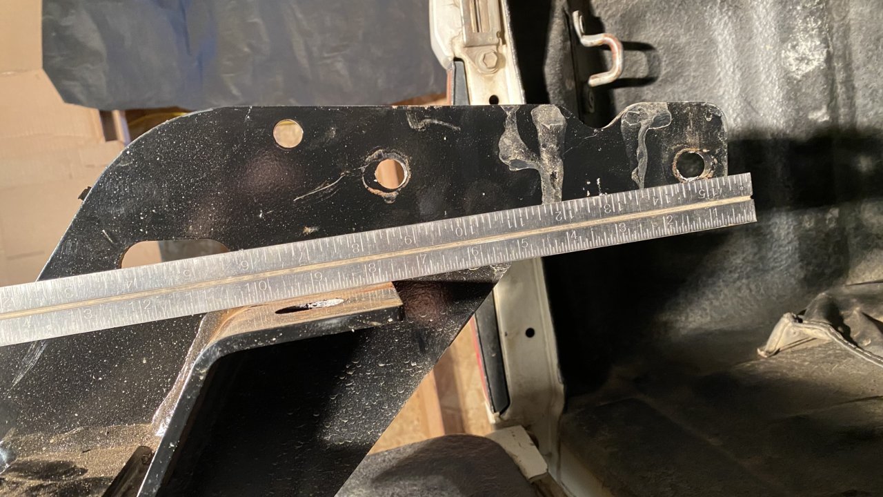

    This is a photo of the passenger side wing of the first Curt (Model 13013) hitch I bought. Note the flat surface, out of plane of the two mounting holes in the wing.
    This is a photo of the drivers side wing of the first Curt (Model 13013) hitch I bought. Note the flat surface, out of plane of the two mounting holes in the wing.

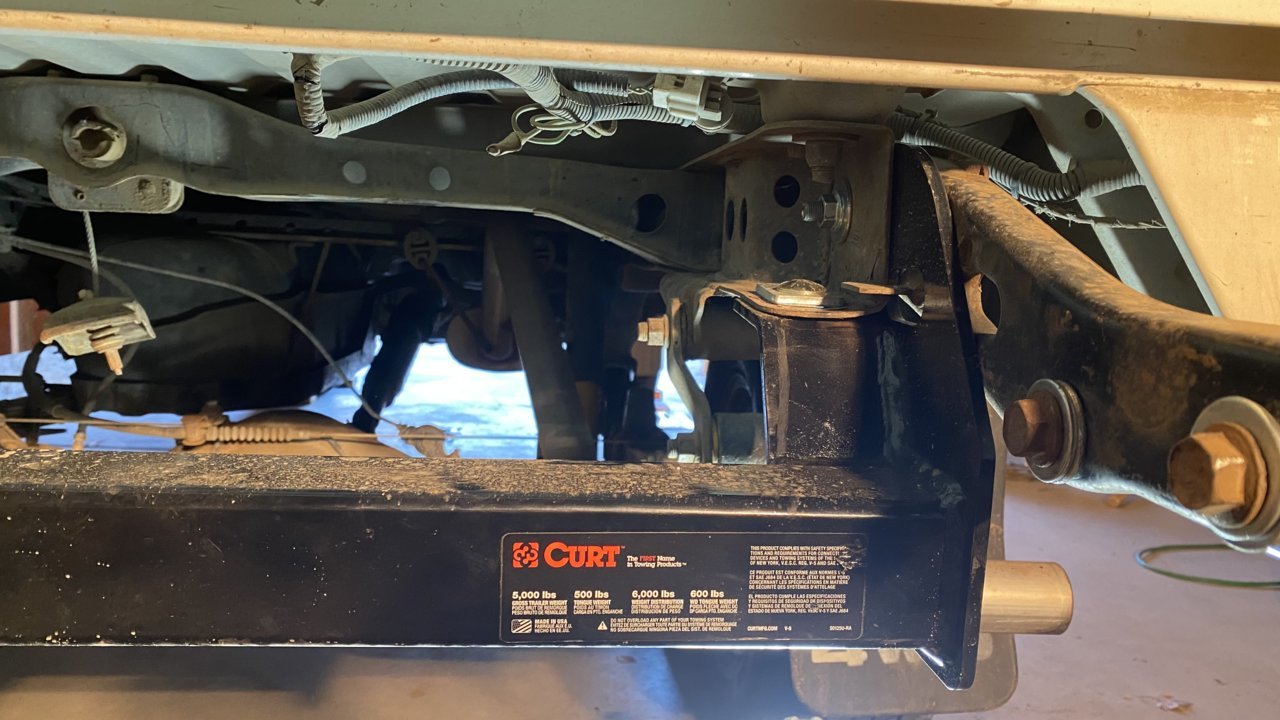

    The Curt (Model 13013) is installed on my truck, all torqued and ready to go. Note the C-channel pulled down due to poor fabrication of the hitch.

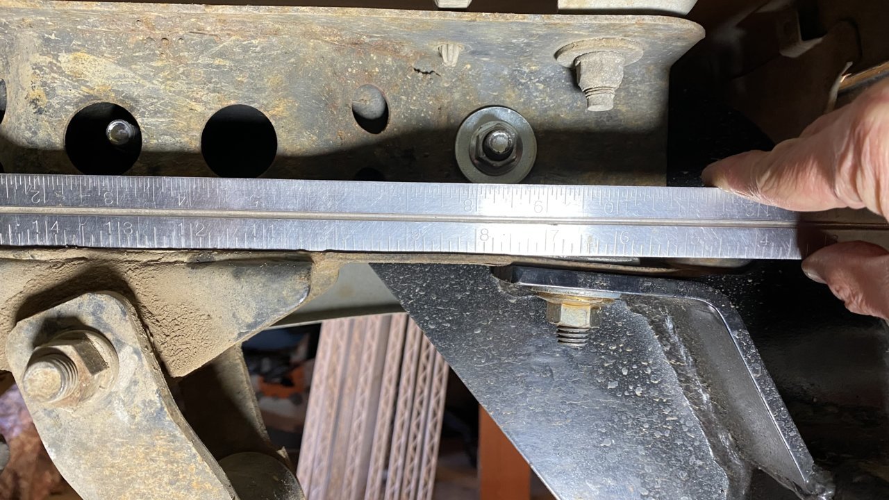

    Another photo of that passenger side, with ruler on face of plate, clearly out of plane with rest of C-channel

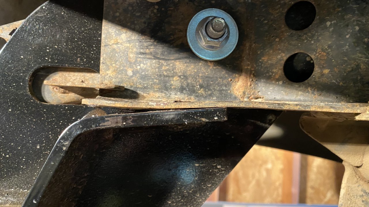

    Drivers side of the same installed hitch. Note the angle out of plane the surface that mounts on the bottom of the C-channel
    This is the drivers side again, note how much the C-channel is bent down from the surface on the hitch being out of plane with the side holes and rest of C-channel.​
    The drivers side, clear view of C-channel bent down due to poor hitch fabrication.​

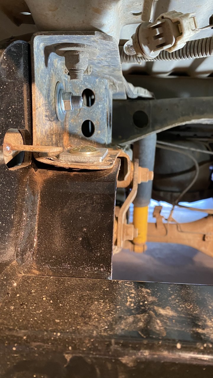

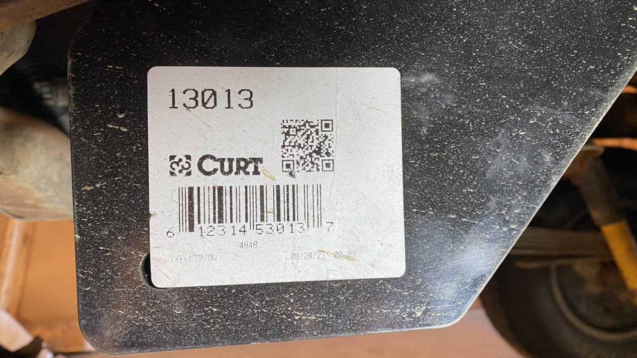

    The Curt (Model 13013) hitch.
    End view of drivers side, note the C-channel bent down. It even appears the thick washer the carriage bolt is also warped under the strain.
    Note the passenger side C-channel, bent down due to the mis-fabrication of Curt (Model 13013).
    When I took the carriage bolt out, the C-channel relaxed some, but was still bent on driver side. Note, the two wing bolts were still installed.
    When I took the carriage bolt out, the C-channel relaxed some, but was still bent on passenger side. Note, the two wing bolts were still installed.​
