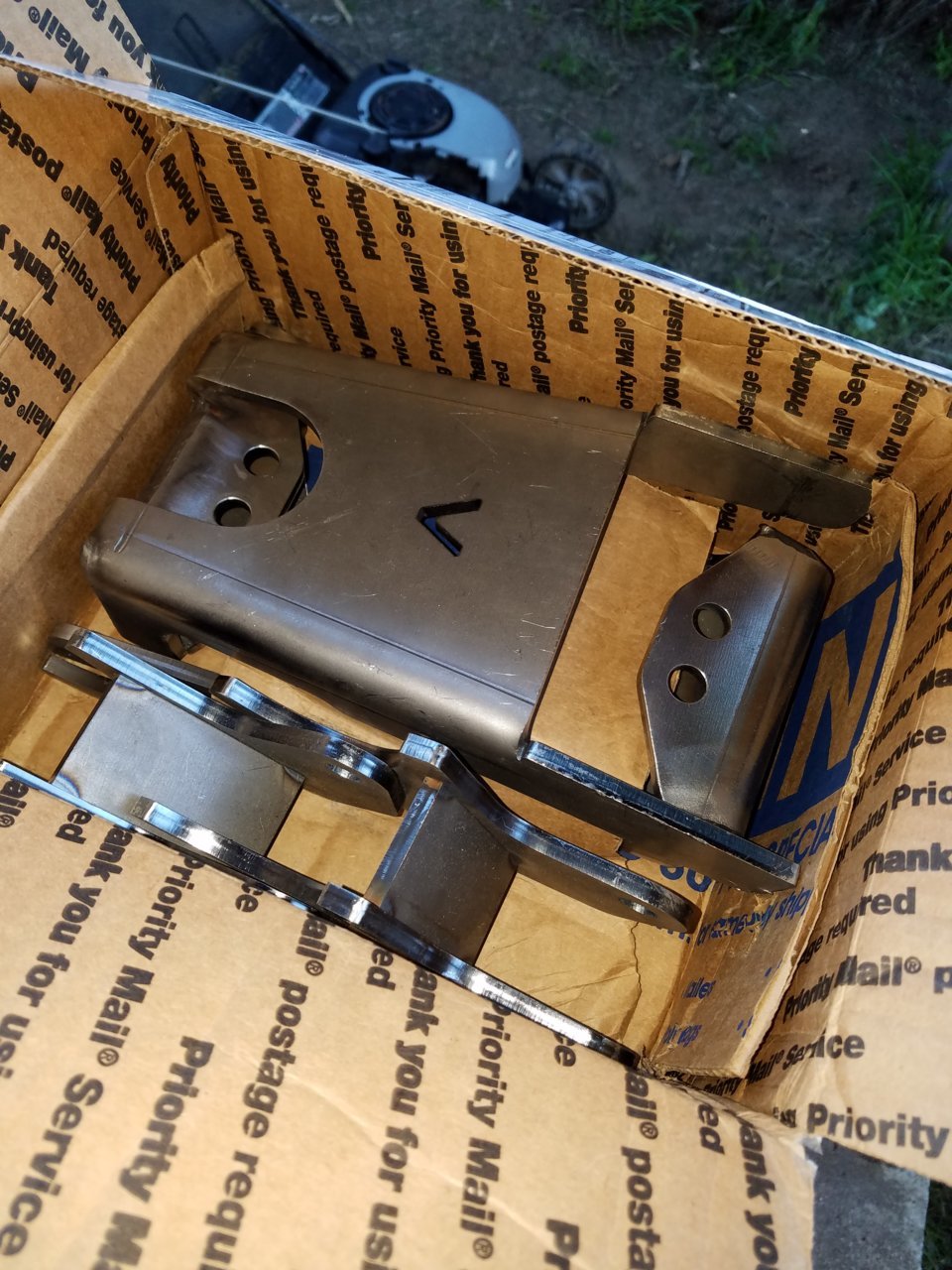

    Goodness the quality in these are top notch. Thanks so much Eric I'll post pictures as the kits installed.
