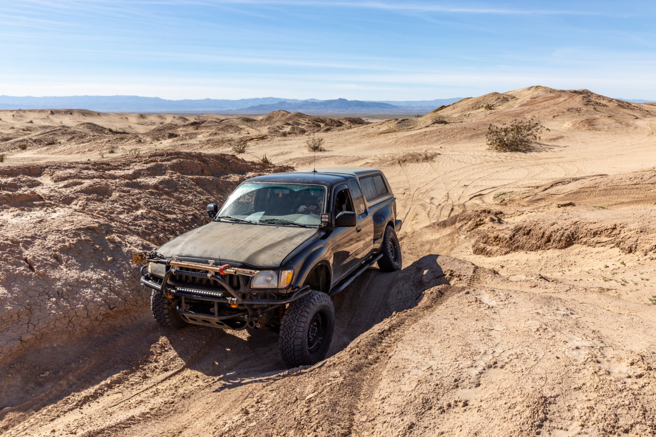

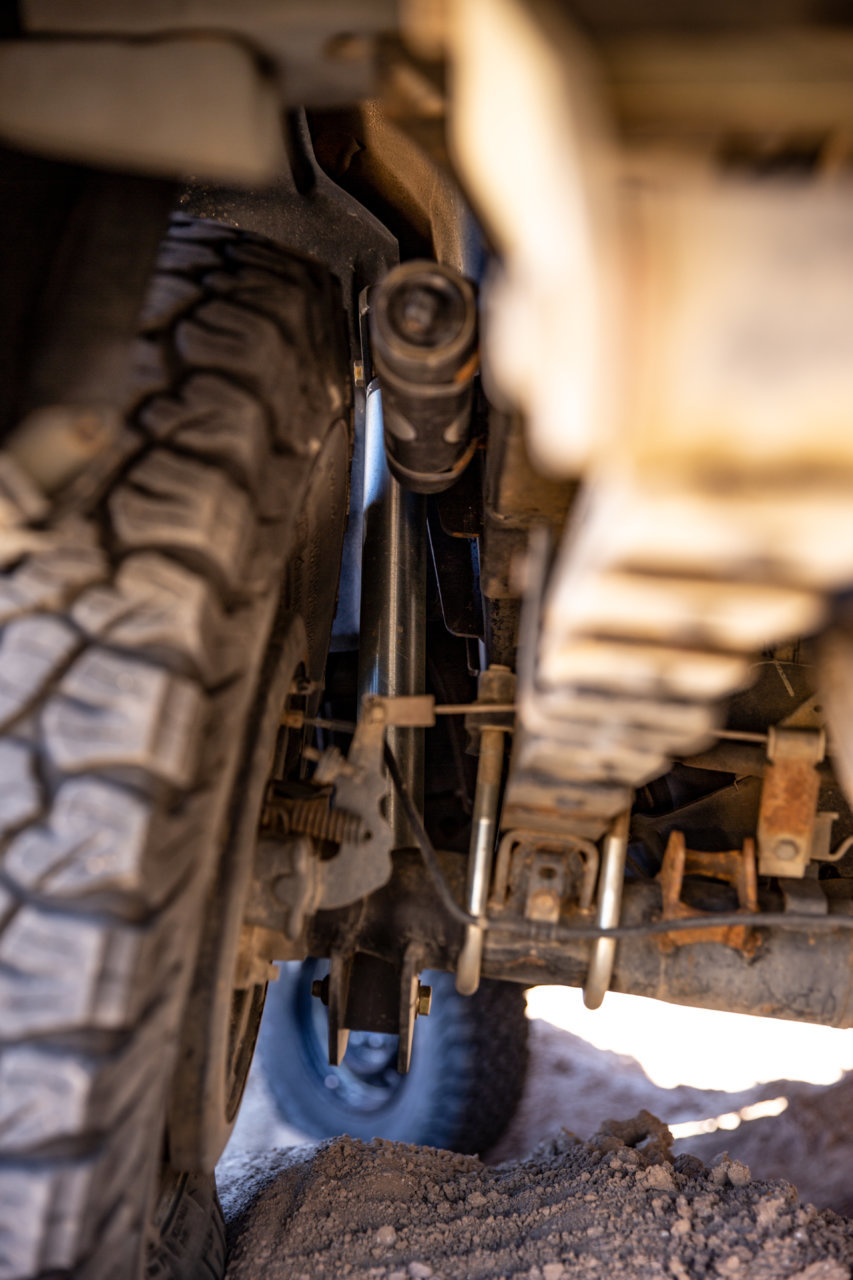

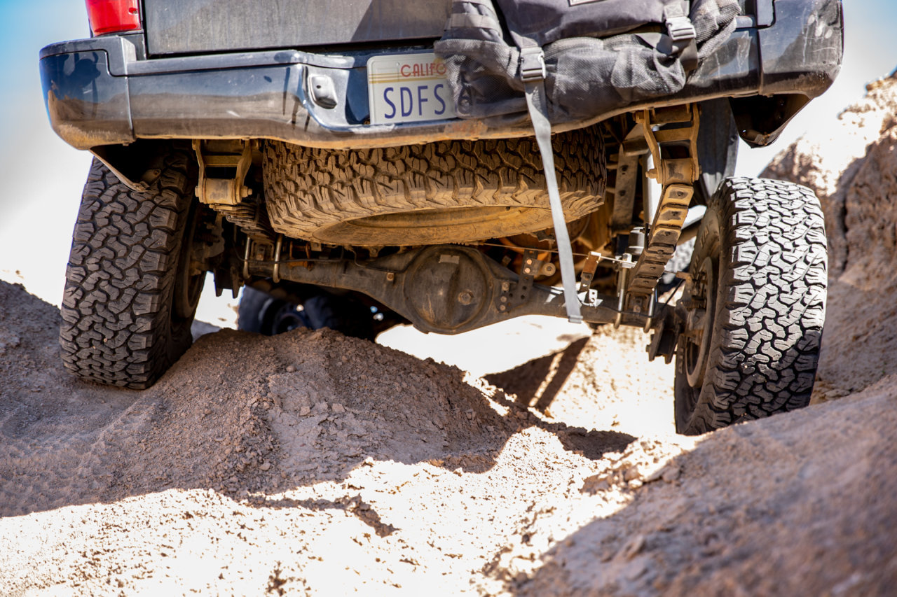

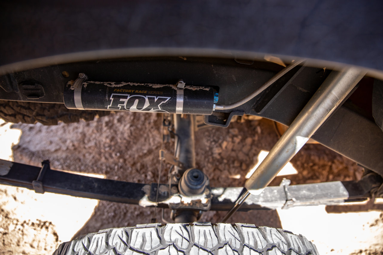

    Played in the dirt some more and found a spot to kind of flex her out again and see what happened this time.
    Wasn't as an extreme of an angle as last time where i was rubbing pretty hard. can see it on the shock in the side shot. This time things looked much better. Hitting the bump, AND no rubbing. :thumbsup: Rides great and flexes great.
    For those who don't want to back read a ton, i'm running alcans and 12" 2.0 foxes with 2" spacers and 16" steelies.
    I've got 265's @32" on now, before i had a 285s @33" just to toy around with different tire sizes since i have them. both steelies. 265's are 16" and the 33's are 17"
    I also got to pick up some speed and have some behind the shock footage that i've yet to upload. Think i need to make a youtube account to do that.
