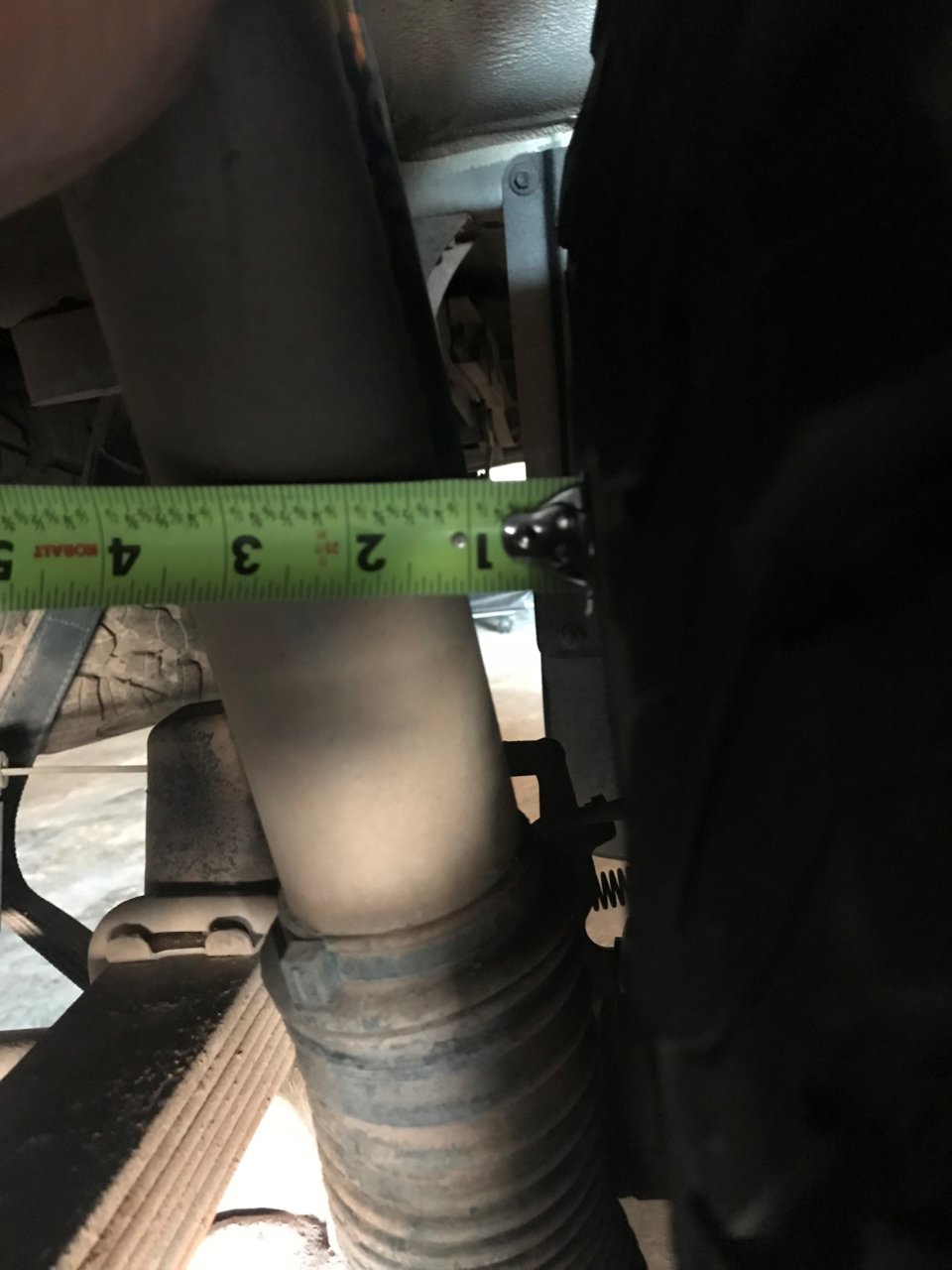

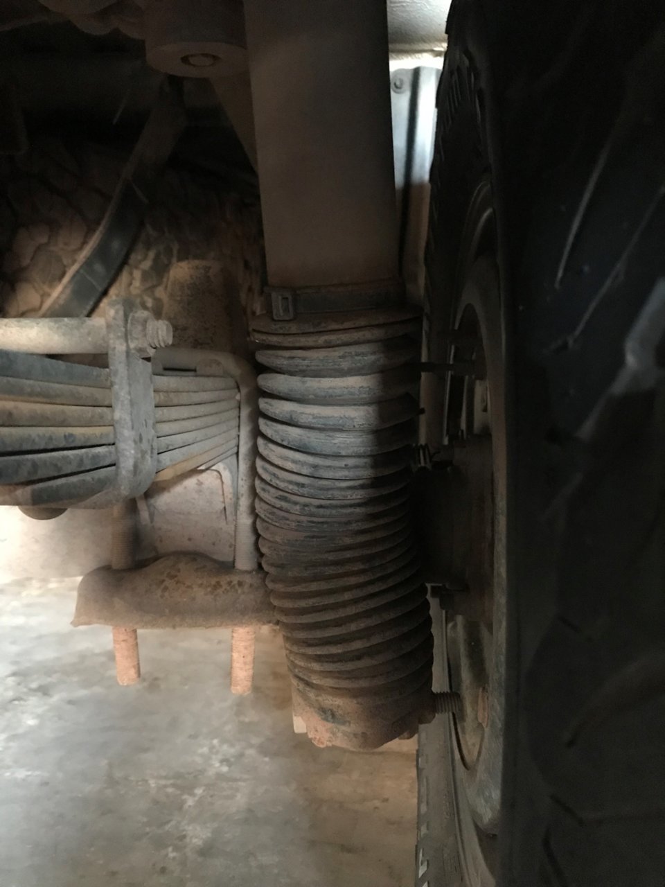

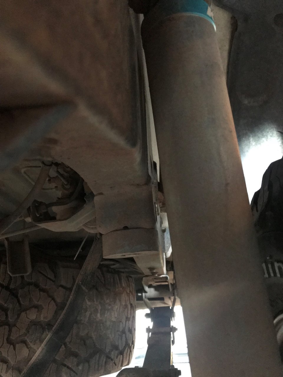

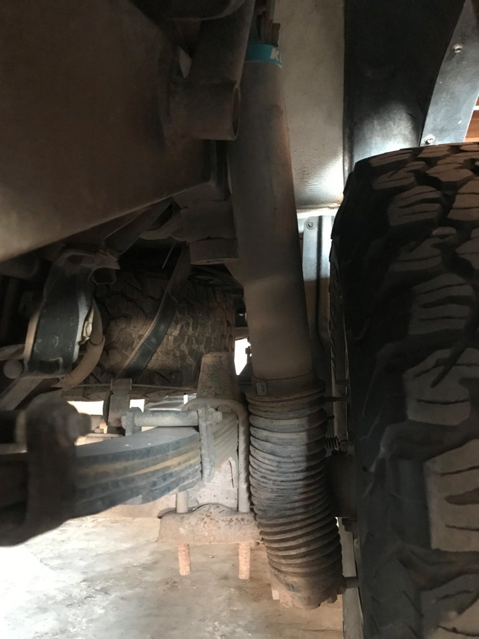

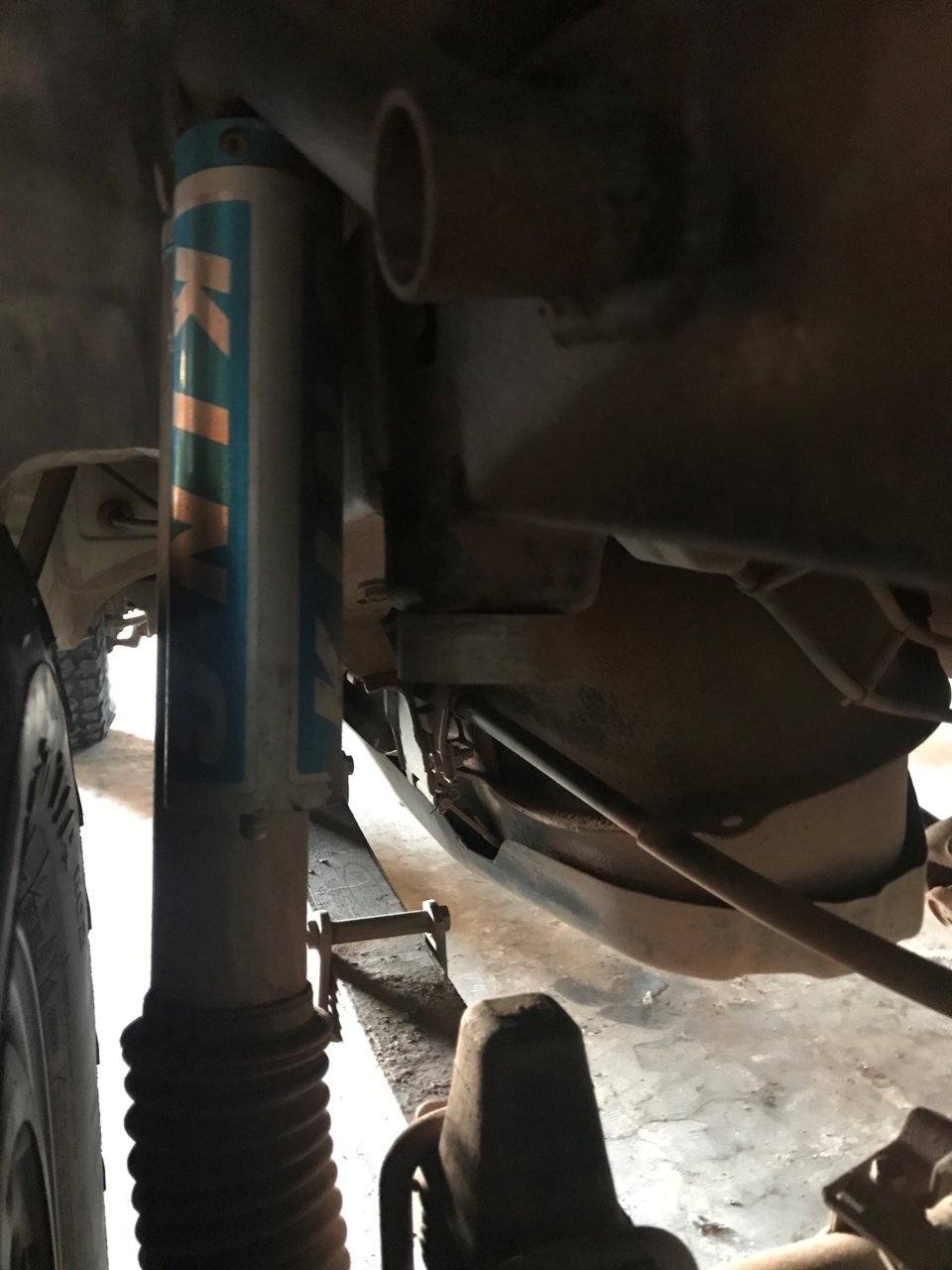

    Here's what i was able to grab. Let me know if there's other angles you need. I can put it up on stands if it helps you. Hard to squeeze a tape measure and a phone camera in there lol.
    Excuse all the Arizona clay that's now infused into every inch of my truck, i hate that shit with a passion
    Overall packaging
    Shock to frame clearance
    Leaf to shock clearance.
    From rear looking forward
    About an inch between the widest part of the tire and the shock body. The angles look weird for some reason.

    Thanks a TON! I did preliminary measurements on a stock 2002 TRD, but this helps with a modified truck plus seeing a 2.5 in there. That is right up against the frame. So this is a 265/75-16 on 3.5" BS wheels

    yessir, 16x8. We even spaced out the shock hoop from the body with 3/16 plate, and angled the hoop outwards slightly to make sure the shock had enough clearance.
    When i articulate, the tires rub the shock, and i have to replace the king decals every time i rebuild the shocks. Thankfully they're local and give me half a roll ever time i go lol.

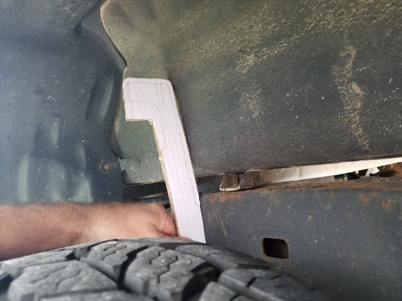

    Arts and crafts.

    Bug deflector
    Will you be supplying new lower shock mounts as well?
    Will they be matched to where they land on the axle? Due to the way the axle necks down right where the lowers need to be, one of the mounts should have a smaller diameter where it lands. I'll try to grab a picture of what I'm talking about.
