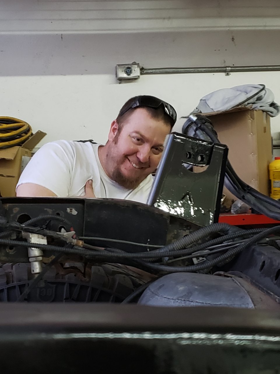

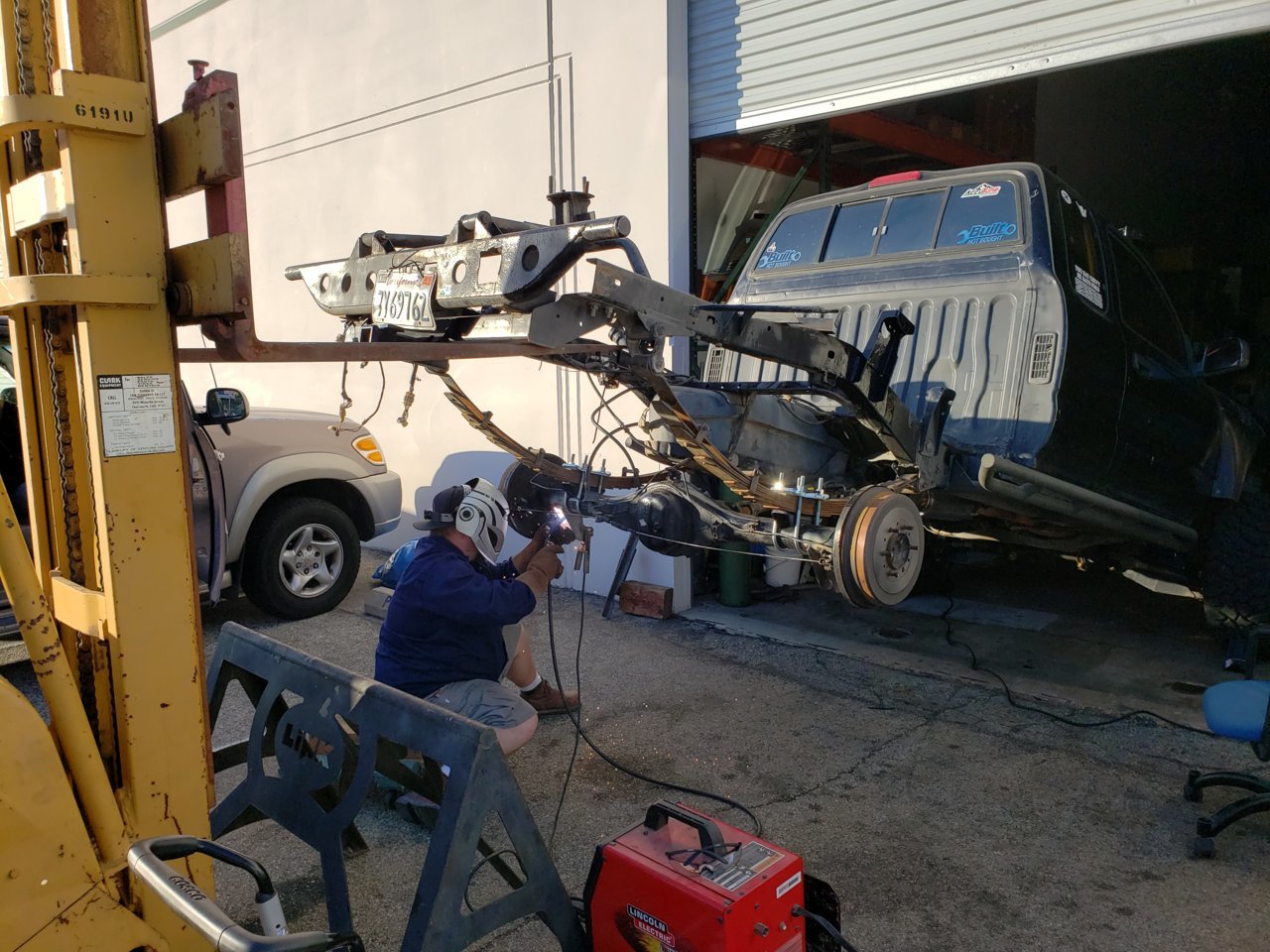

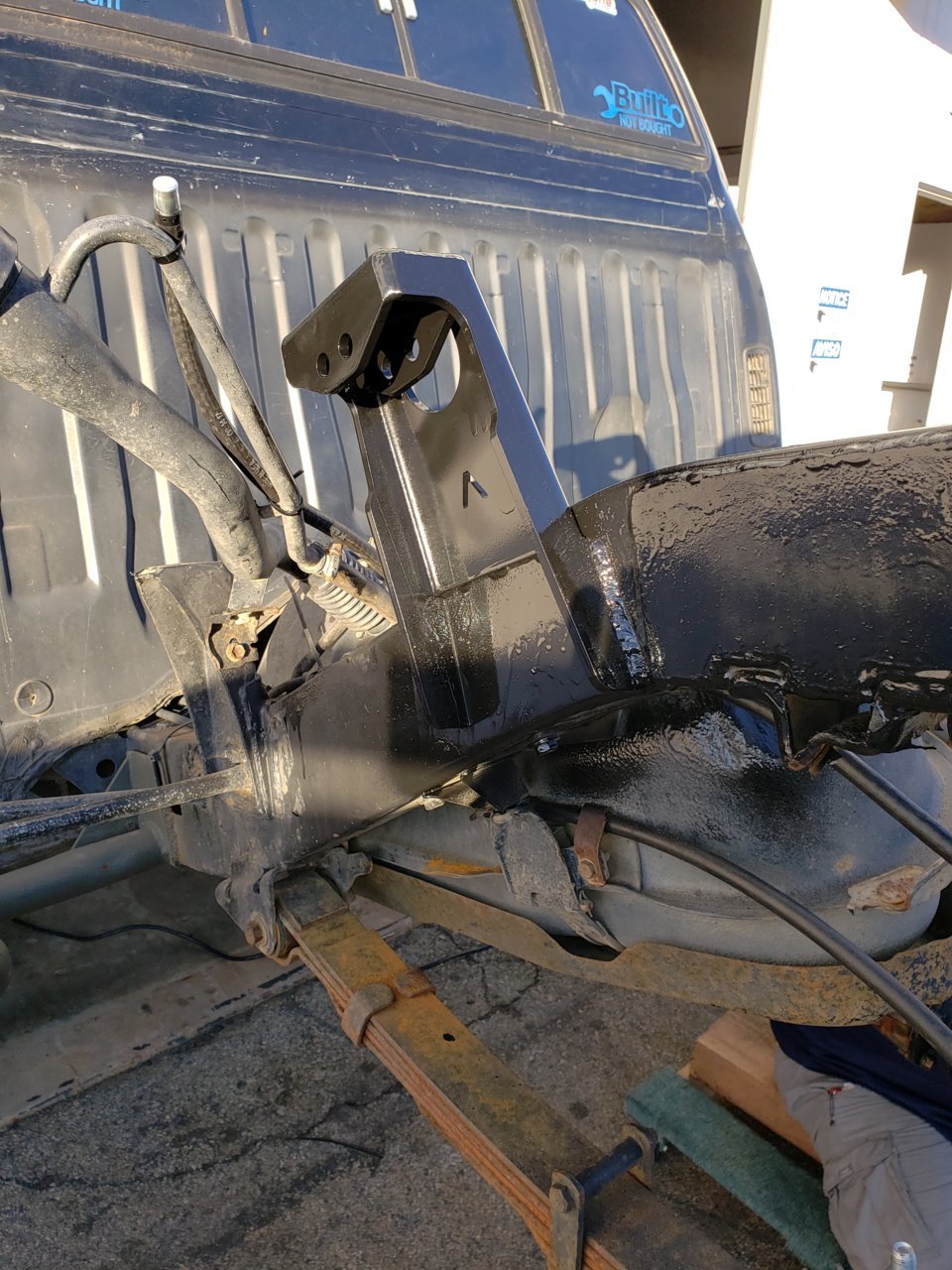

    After running into a financial problem I had my manager weld on the kit so far the upper is in the lower shock mounts should get welded on this week. More pictures to come soon.

    Also noticed that the prototype kit with two holes is a smiley face thanks again @AR20190324_191838.jpg CHIVE Eric this kit is solid

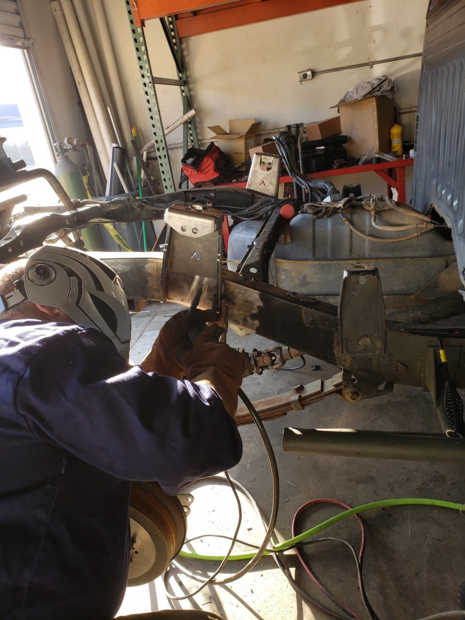

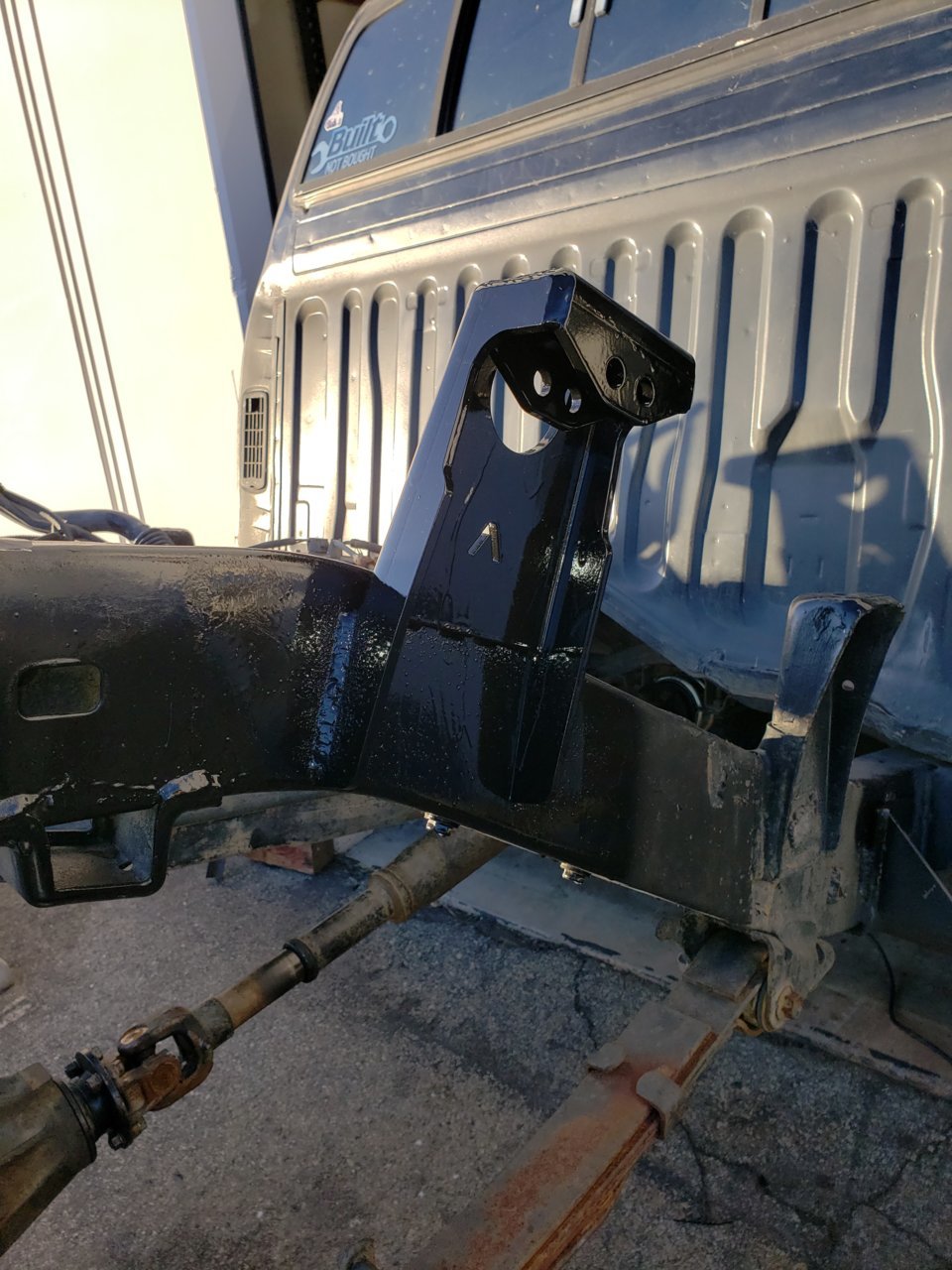

    Little delay but the lowers are getting welded on. And a better shot of the uppers20190328_181336.jpg 1553822456421599213641655341067.jpg 15538229969502218597672791865198.jpg

    @1st4x4 man you spray paint as well as i do. My fender look like you shock towers do.

    Ya I can plumb pool equipment no problem but dont ask for my painting to be pretty because I'm not a painter lol. I either stay the right direction away and get tons of overspray or stay to close and get what you see lol
