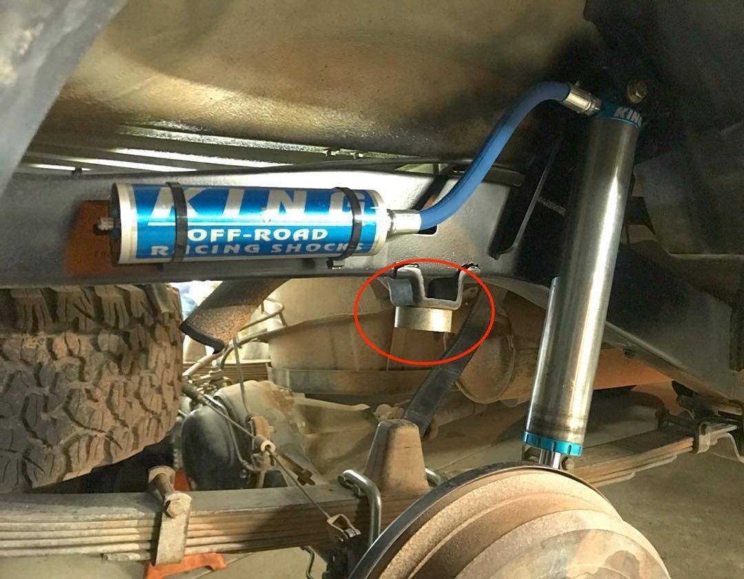

    Does anybody have any information on these "pucks"? They effectively extend the factory bump stop but I am curious what the puck actually is and how it's mounted to the frame. Also in this picture it looks like still stock bump stops? I messaged the owner but I dont think he is active on the forum anymore. Thanks in advance for the help!

    It's just an aluminum spacer, I believe he says it's 3/4" or 1" thick. Not a bad idea to slightly limit negative arch, but also a great benefit is it enlarges area for bump to strike.
    2nd/3rd gen Tacomas have a much wider area for bump to strike.
    It think it's ridiculous that many 1st genners are spacing their bumps 3"
