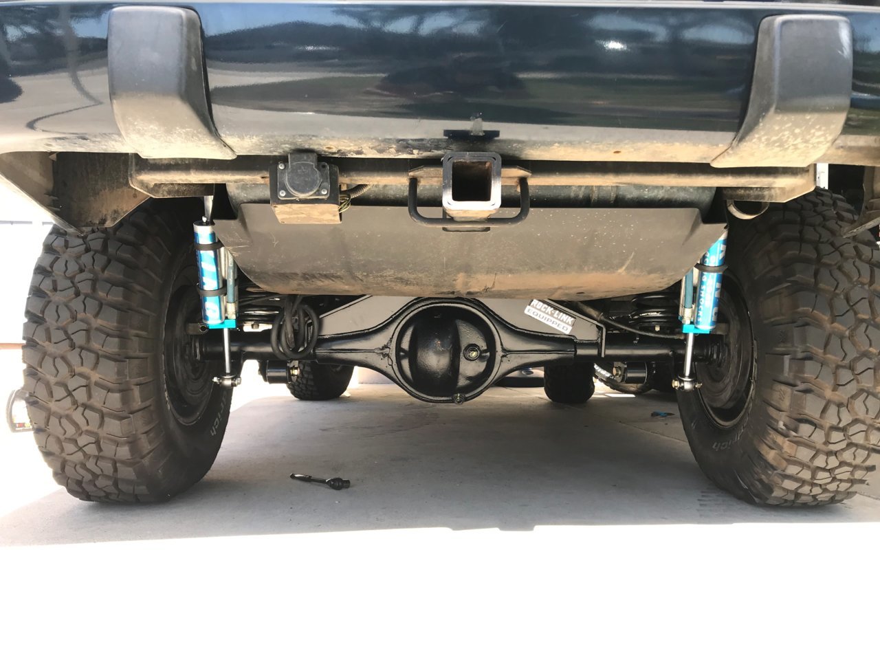

    desertjunkie760
    desertjunkie760 @DesertJunkie760 (IG)
    Apr 11, 2016
    #183963
    9,158
    Shane
    2011 MGM DCSB TRD Sport 4x4
    Check My Sig.
    Are you’re rear fenders cut? I have a feeling the answer to your question is that you have a shackle flip, therefore you loose bump travel which prevents the tire from rubbing your 2.0 body?

  10. Oct 23, 2018 at 1:07 PM
    #50
    ARCHIVE
    ARCHIVE [OP] Well-Known Member Vendor
    Oct 29, 2015
    #168099
    2,263
    Eric
    Orchard Park, NY (Buffalo)
    '05 Taco, '22 Tundra, '91 Cummins
    2.5" Fox relocation * Hammer hanger * Archive MD springs
    Looks like you have negative offset wheels, you have a Bilstein smaller diameter shock without a reservoir, which allows the bolt to be parallel to the bed, which all help you get away without a spacer.
    I like the way shocks look with top bolt pointing towards the bed, and 2.5 shocks, and remote reservoir.
    Willbeck and Trident904[QUOTED] like this.
