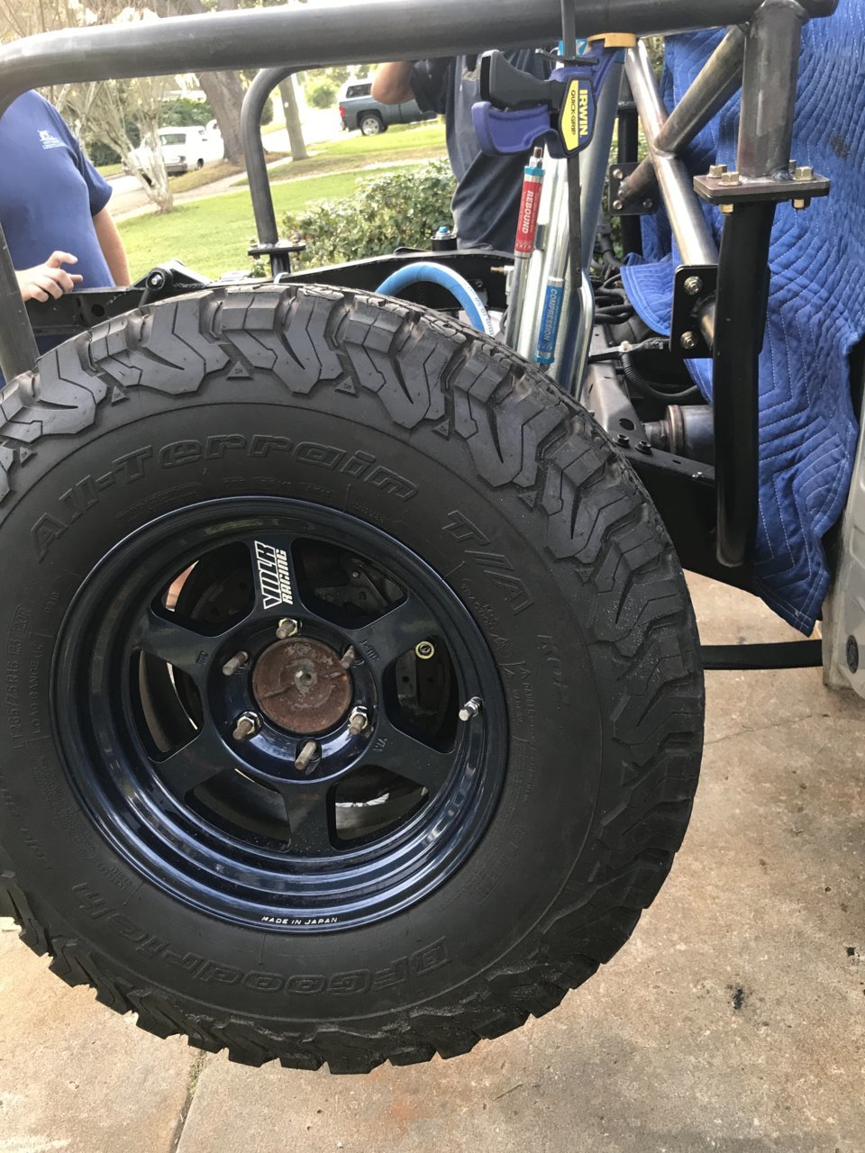

  2. Nov 30, 2018 at 4:56 PM
    #142
    94jdmeg6civic
    94jdmeg6civic Well-Known Member
    Jun 1, 2014
    #131029
    143
    David
    Orlando,Florida
    2001 Tacoma dbl cab long travel
    Sua deaver f67
    Bed cage 2.5 x16 kings triple bypass
    With tundra axle swap
    Wheels 16x8 0 offset
    And it’s still going to rub at full articulation

  5. Dec 1, 2018 at 4:25 AM
    #145
    94jdmeg6civic
    Jun 1, 2014
    #131029
    143
    David
    Orlando,Florida
    The top picture is at articulation with 31s I’m going 33s
    On the other side the shock is 1/8” from hitting the frame and the shock is 12”s of shaft showing

  10. Dec 12, 2018 at 1:03 PM
    #150
    ARCHIVE
    ARCHIVE [OP] Well-Known Member Vendor
    Oct 29, 2015
    #168099
    2,261
    Eric
    Orchard Park, NY (Buffalo)
    '05 Taco, '22 Tundra, '91 Cummins
    2.5" Fox relocation * Hammer hanger * Archive MD springs
    Couple things about your setup to note that don't directly correlate to the Archive kit: your top shock eye looks about 18" above the frame, necessary for what you're doing, but makes clearance difficult. Then you have bypass tubes towards the tire. The Archive kit has the top shock eye only about 5" above the rails, which allows the shock to be closer to rail while allowing shock to angle inboard during articulation. I've made it clear from the beginning that everyone will need spacers and negative offset wheels.

  13. Dec 18, 2018 at 9:24 AM
    #153
    Blackdawg
    Blackdawg Dr. Frankenstein
    Dec 31, 2010
    #48500
    81,652
    Monte
    Wyoming/St. Louis
    The Trifecta of Taco's
    Man im still waiting on my set. Looks great though!
    actually looks like theres more room to go up maybe?
  14. Dec 18, 2018 at 9:37 AM
    #154
    desertjunkie760
    desertjunkie760 @DesertJunkie760 (IG)
    Apr 11, 2016
    #183963
    9,158
    Shane
    2011 MGM DCSB TRD Sport 4x4
    Check My Sig.
    The bracket is built in a way that allows the freedom for you to put it where you feel best. With the 12-14* shock angle we used , there is no issue with a bottom out and he bought 12" shocks so we are not limited on droop. I decided to keep the bracket at this height in order to have a 3rd weld point in the center bridge of the bracket.
