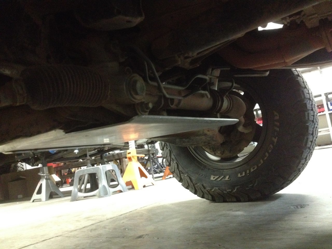

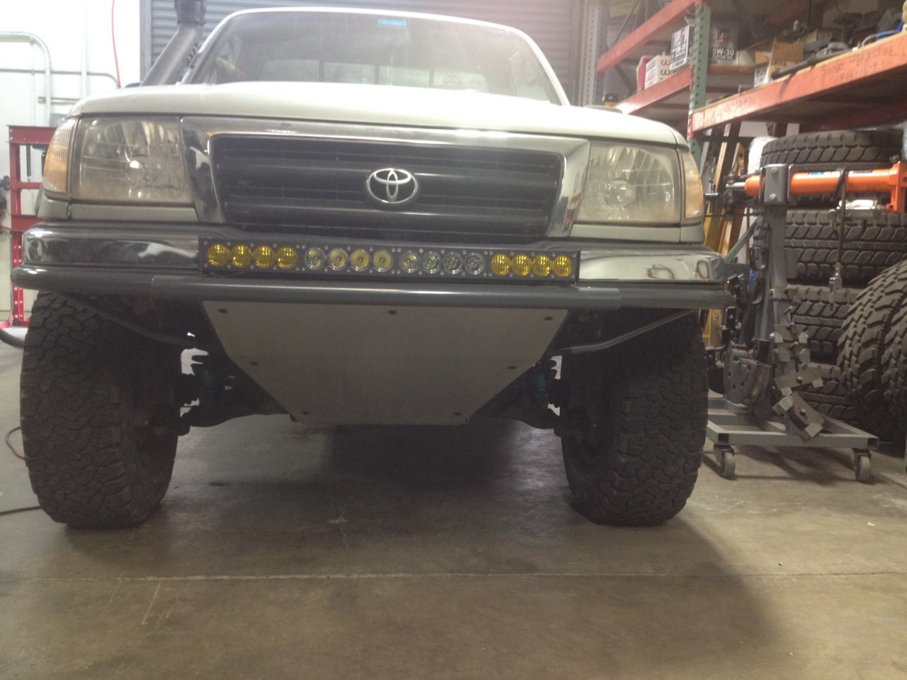

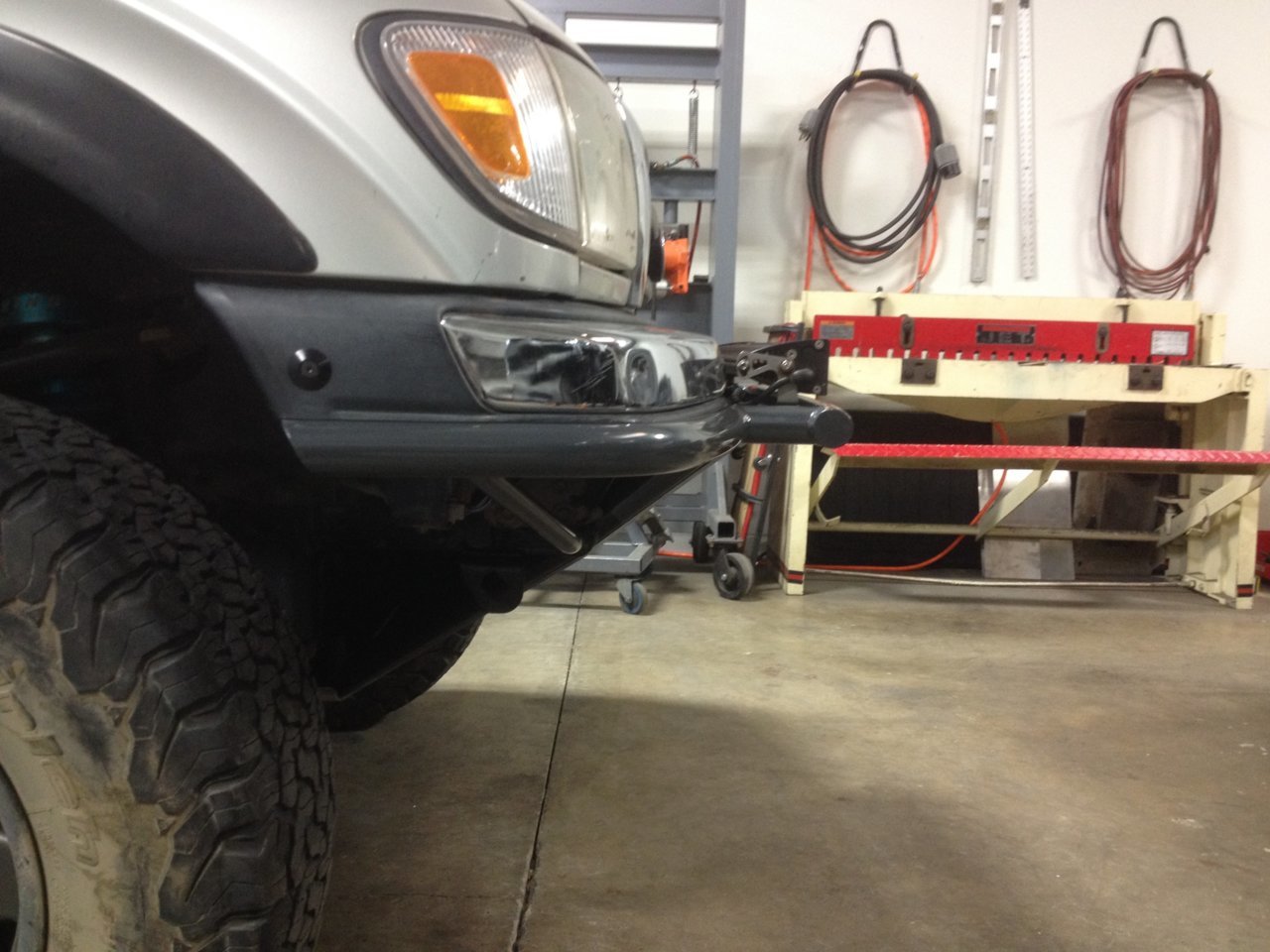

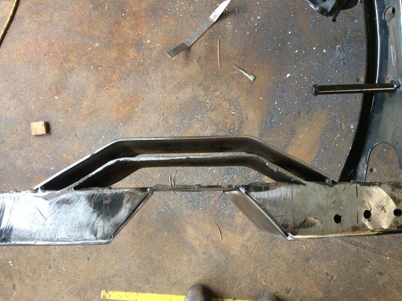

    Not mounted yet, we cut my old mounts off, cleaned the frame up, and now it's just down to me finding time to get over to King and pick up the parts i need to convert from piggyback to remote res. In the meantime we've mostly wrapped up my bumper build.
    Excuse the awful pictures, my fabricator is an artist in metal, but doesn't care much about photography haha

    sweet skid!
    I still want the LED bare recessed in the bumper..haha
