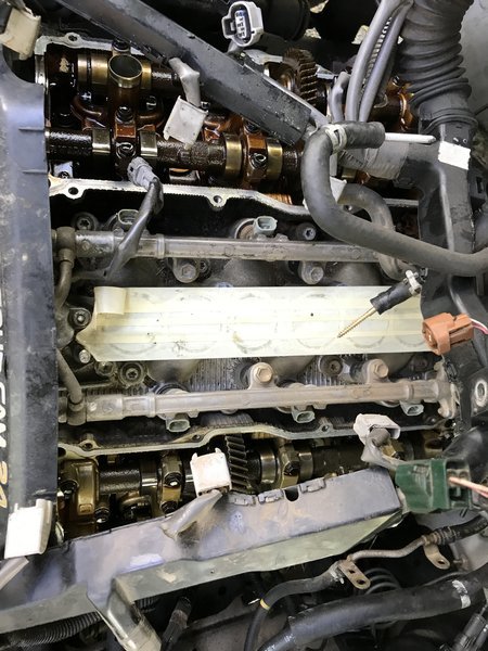

    I'm in the middle of his project right now. Doesn't seem too hard, a bit tedious getting everything disconnected and opened up, but pretty straight forward.
    My buddy and I are taking our time, are done for the day and planning to wrap everything up tomorrow.
    We have the valve covers off, all the gaskets removed, and are cleaning up the covers. The gunk is pretty caked on. the engine cleaner took some off, but it needs some work to look clean.
    I'm not quite sure what to do to get the edges of the head cleaned. Granted I've been working w just a razor blade to scrap it. I may pick up a scraper in the morning and see if that takes care of it.
    Can I put some engine cleaner on a rag to clean the surface of the head?

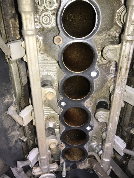

    You can see here the passenger side is much dirtier than the drivers side. I'm due for an oil change, but there is a big difference in the color between the two sides. I hope nothing too nasty snuck in there and I'm glad I'm getting this project done.
    Another question. Should my intake look this caked? I've never opened an engine before so I'm not sure.

    I got mine buttoned up today.
    Went pretty painlessly. I missed one connector and one hose, but it ran fine before I found them.
    Burnt off some excess oil residue left on the exhaust, but it looks too be running clean. I let the FIPG cure for a few hours before turning it on and then a few more before going on a test drive.
    Thank you for the write up @ramonortiz55
