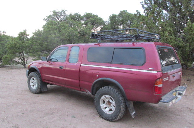

    I had just had mine replaced along w/new plugs & wires.Plenum too since truck has 328k on it.
    I just can't work on these trucks much over the basics anymore myself.
