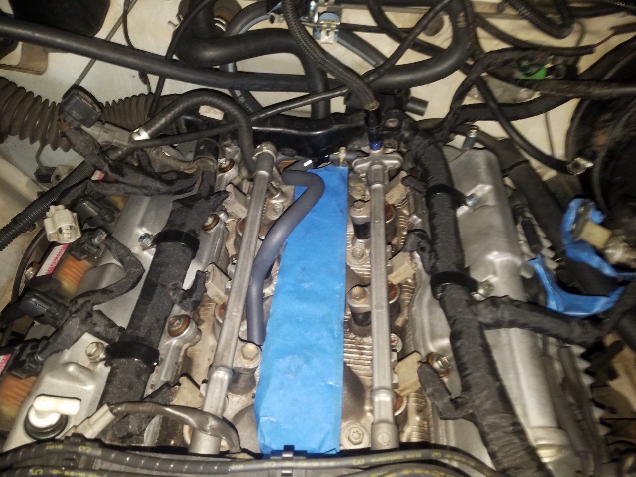

    Did this back in June, was seeping a bunch of oil and @235k it was time. Got the kit off Amazon here: https://smile.amazon.com/gp/product/B001G6GY8Y/ref=oh_aui_detailpage_o07_s00?ie=UTF8&psc=1
    Amazon says it doesn't fit my Taco, but from the questions and reviews I figured it did (it fits the 5vz just fine). Comes with the cam plugs, washers, spark gaskets and pcv grommet. Used gray RTV from autozone, and took the opportunity to replace the spark cables and re-gap the plugs (new-ish, but a few were off a bit) and swap sides. Reused the half-moons and intake gaskets (though the gaskets are showing some wear, rubber flaking in places and even separating). Everything came out fine, even took a wire brush to what I could to shine it up a bit. Think I missed a cable somewhere though, the temp gauge on the cluster is stuck below C even after driving a bit. My ODB reader sees the correct temp. so I'm not too worried, and it looks to be one thats under and behind everything (of course). Pic Dirty vs clean covers:

    Looking good. I just did the same, took the engine degreaser and wire brush to the covers as well. I got all oem stuff, job wasn’t too bad. Did have a high idle issue but turned out to be a dirty IAC. Guess I washed some extra carbon down in there. Cleaned it out and it purrs like a kitten.

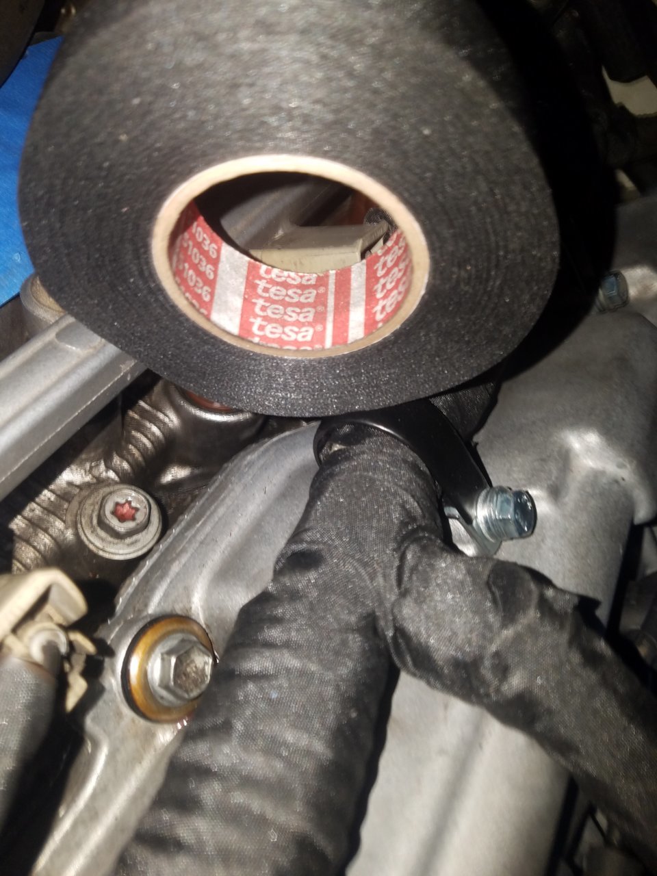

    If your doing the valve cover gaskets you have a good chance of breaking the wire harness plastic heat shield. The plastic is 20 years old and brittle and a good chance
    that it will need to be repaired. You can not buy just the heat shield from Toyota,
    you have to buy the complete wire harness for 2000.00 plus dollars. Haha right.
    1) Tesa harness tape for the wiring harness is
    what I recommend as it’s rated at 300 degrees!
    2) Napa wire loom metal and rubber brackets can be used for those with the broken heat shield tabs to secure the harness in place to the engine.
    3) 6 feet or so of heat resistant wire loom tubing
