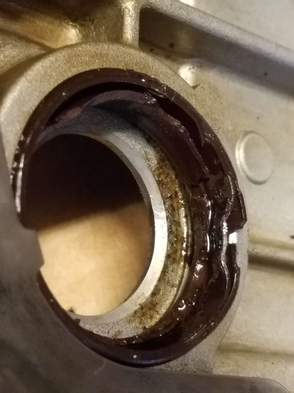

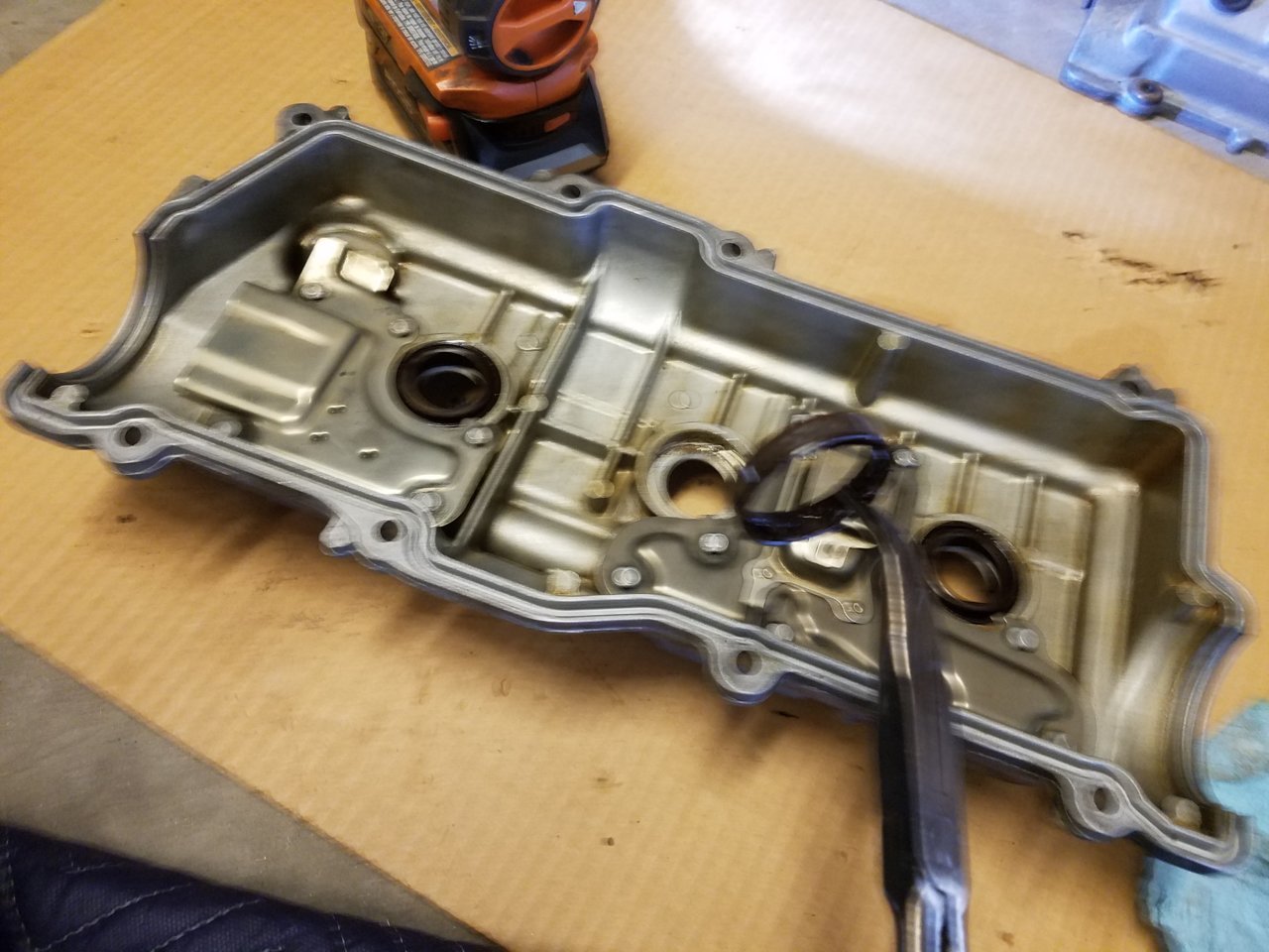

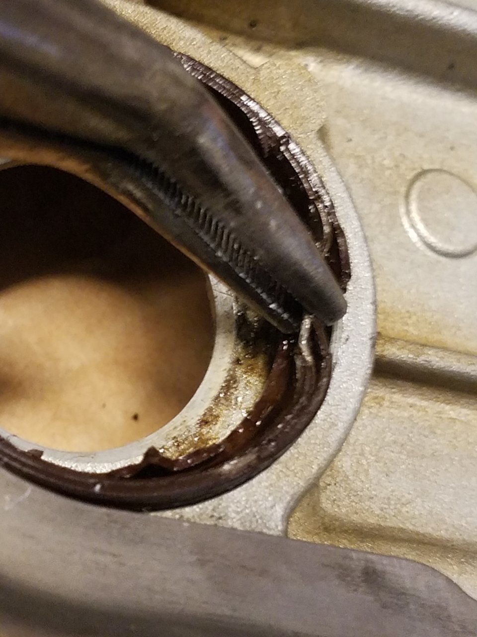

    Do these spark plug seals have an outer metal rim?
    I see there is a metal rim and was pulling on it then though maybe thats part of the valve cover and just screwed up that metal rim.
    The old seal is just falling apart as I pull on it

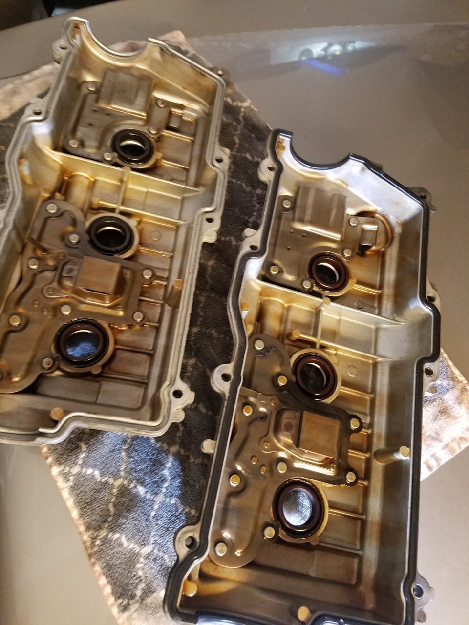

    Got them :),
    Getting them painted RED Monday and then finish the valve cover gasket process later in the week

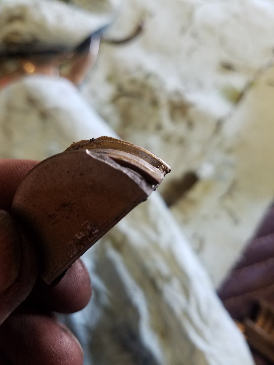

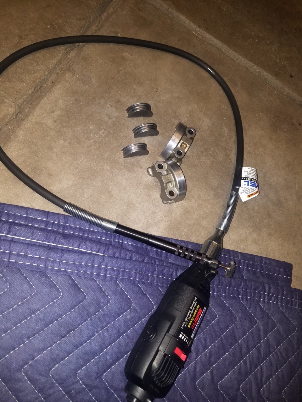

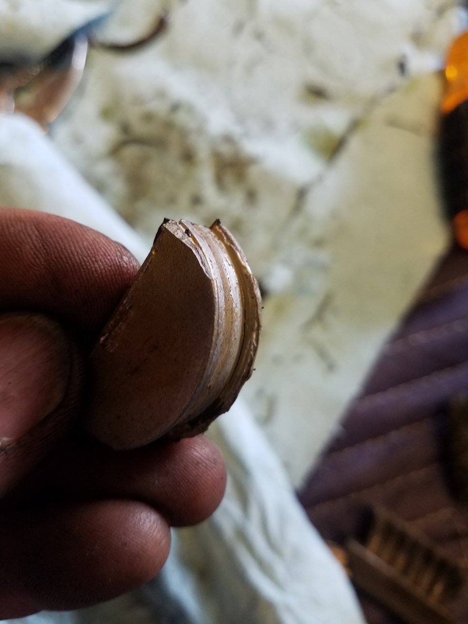

    So everything went well until I couldn't get the last half moon loose.
    So I wiggled it side to side,
    Yup the lip edge of the half moon broke.
    Good news is I used a dremel with an extension and a wire wheel and it made short work of cleaning the cam plug and half moon
    old gasket on the motor and the parts
