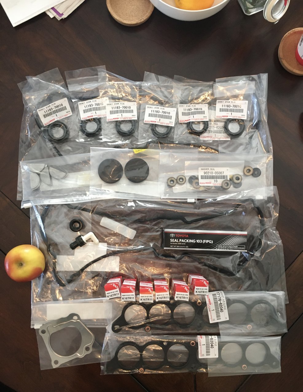

    @ramonortiz55 Thanks for the write-up! With it and @Timmah! video, this gal here is feeling confident to tackle this engine tune-up :fingerscrossed:. I have all next week off, so gonna start it Monday.
    Parts arrived today! And I even got my local dealer to price match Boch Toyota (MA), which had excellent online prices!
    Wish me luck! I’ll be sure to chime in for advice/help if I hit any snags.
    Happy Friday everybody!:D
