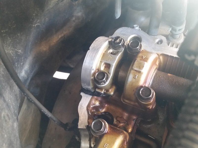

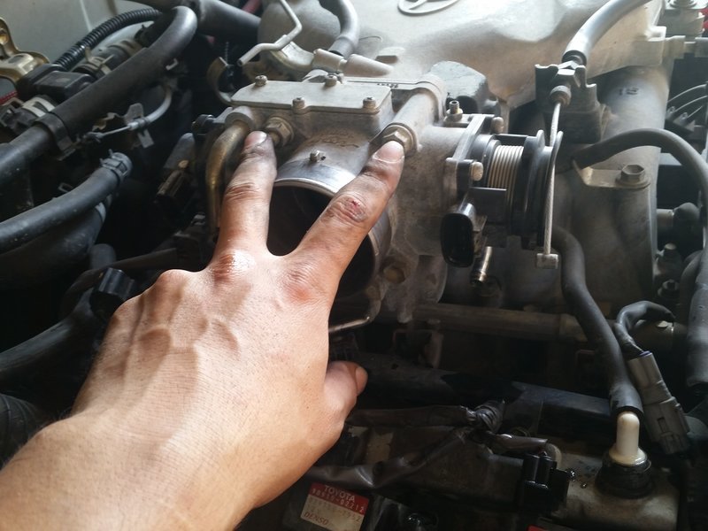

    So I was wondering this too as I do not have the FSM and have been using this thread and Tim's video ^ as guidance. Based on his video it is 12 ft lbs for anyone who plans on doing this job in the future. I know you are long since done with this job but if it helps someone else, I figure I would call it out.
    The job is slow going for me, but I work on it in chunks since it's not my DD. I am willing to bet grit seeping in towards my plugs in the rear is at least part of the cause of my leaks.
    [​IMG]Untitled by Michael Halat, on Flickr
    What is everyone using to get rid of the FIPG in the curved spots where the half moons go? A nylon trim removal tool seems to work the best for me, followed by brake cleaner on a paper towel.
    This side is done and ready, need to still do the other side and deep clean the covers/ replace the parts there.

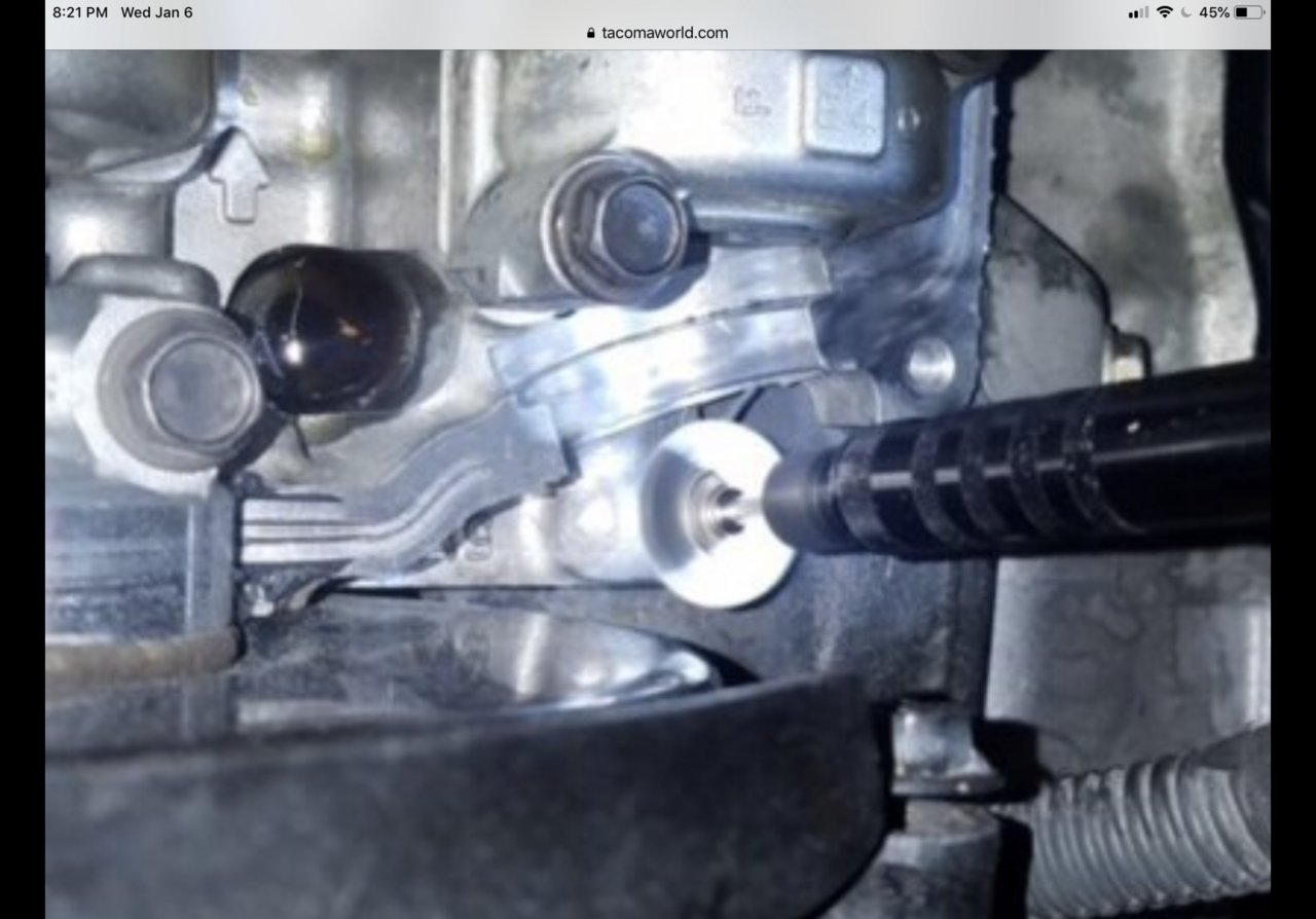

    I used a Dremel with the hand extension and a soft wire wheel,, it cleaned all the old FIPG off in just minutes

    the hand extension is really nice. We’re you concerned about fipg bits being flung into the motor?
    1997tacomav6[QUOTED] likes this.

    No, I ran the brush spinning away from the inside of the valves,
    You can put damp paper towels down if needed to cover any areas on the inside if needed.
    It took me no time to clean all the old gasket material off and no need to use a razor

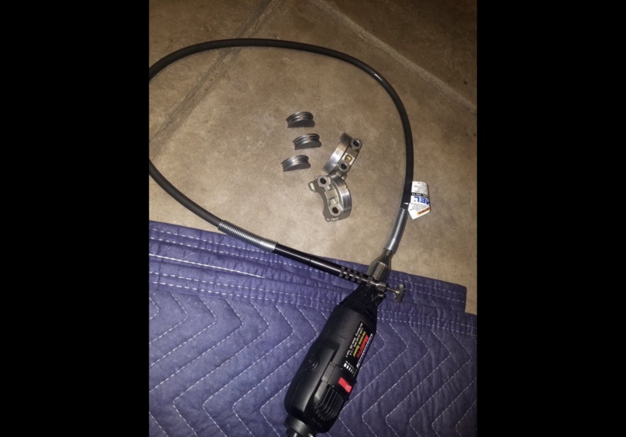

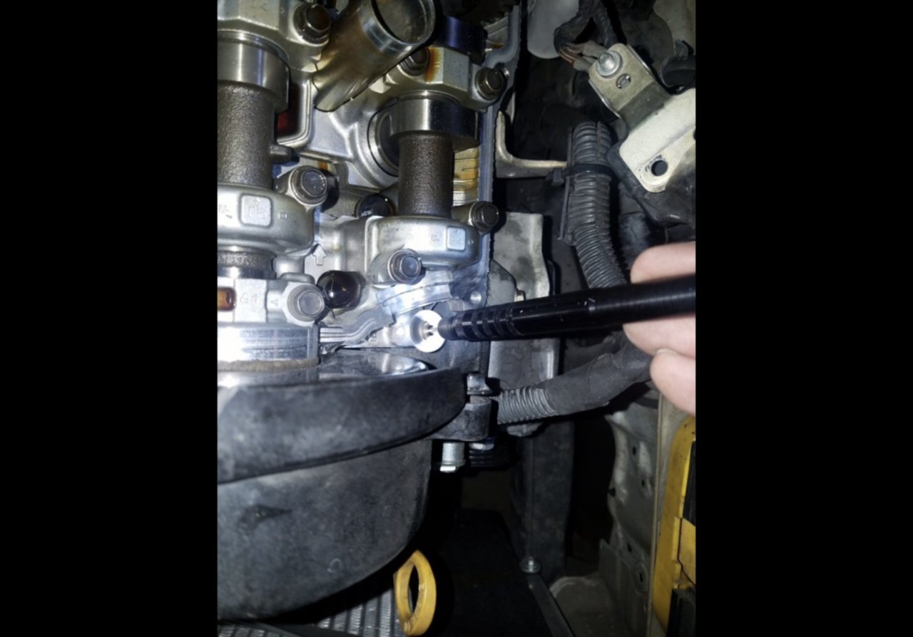

    Here my photos,
    Made short work of this project cleaning the half moons and cam plug holders too

    I used the regular dremel with the soft wire brush a little bit tonight on whatever tiny remnants were left. Was going to pick up that extension but got by without it so no need now :thumbsup:
    Don't worry I saw your original pics, because unlike some people who pop into these threads I read the whole thing :rofl:
