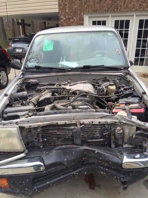

    A few months ago I purchased this truck as a Not running/driving truck, hoping to get the engine and transmission out to put into a 4Runner, but changed my mind when I realized a pickup Yota would be more practical, so I started pulling her apart and putting her back together!
    4 months later, and $4500 now into the project(still not done), I start to wonder if it's worth it!!
    This is a 2000, 4x4 manual 3.4V6 with manual Aisin locking hubs(which im excited about!)
    It has 130K actual miles on it and had a recent timing belt change @ 100K.
    I will post more photos as I see interest in the community. If not, ill just leave it at this.

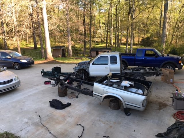

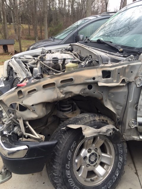

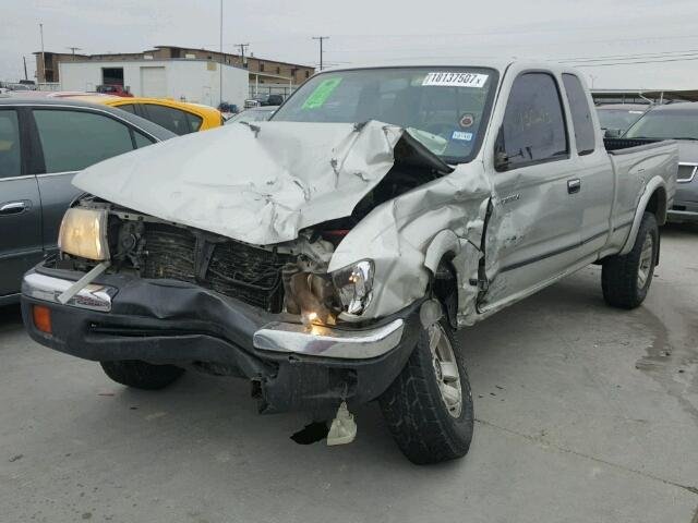

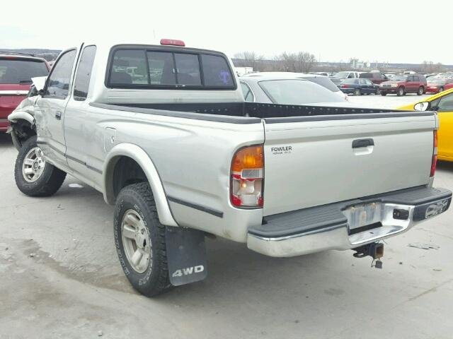

    This is how I got her to the house from Texas.

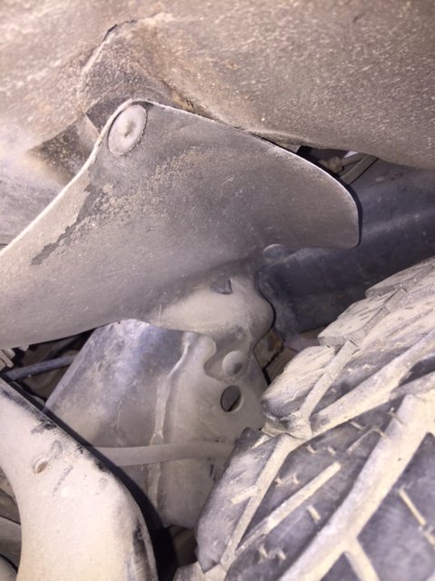

    you cannot tell here that the frame is actually bent in a couple spots!! seriously!
    the frame on these trucks is very weak actually! If you start jacking up the front of the frame, you can see it start bending before it actually gets the wheels off the ground. That is, if the cab, and engine are still intact.

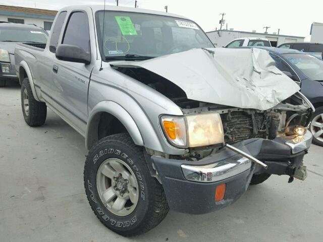

    This apron here..is just way to wrinkled to repair!! Gonna have to pull and then drill out the spot welds later and weld in another from a doner truck.
    Where the frame was bent! Right behind the upper control arm. I was upset because, now i had to do 10X more work!! Later i will post a photo of this frame. Do not have one right at the moment.
    Will show a comparison later of how bad this spindle was bent!

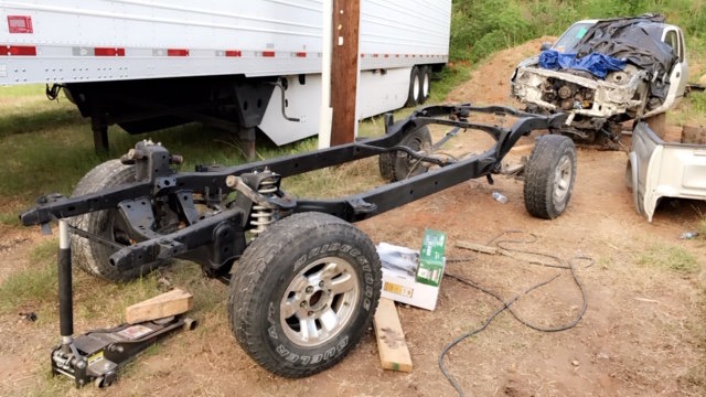

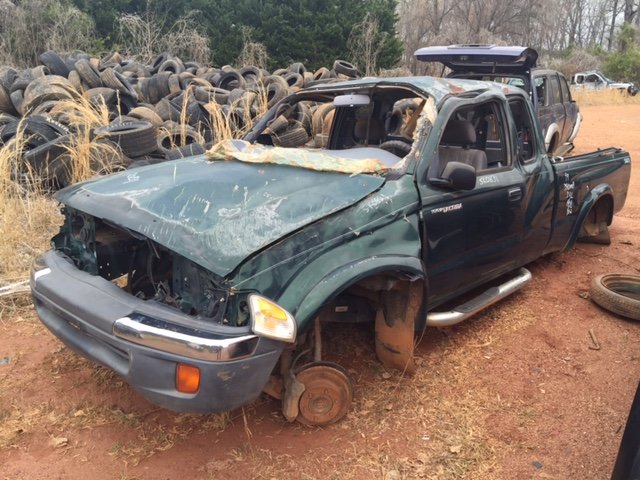

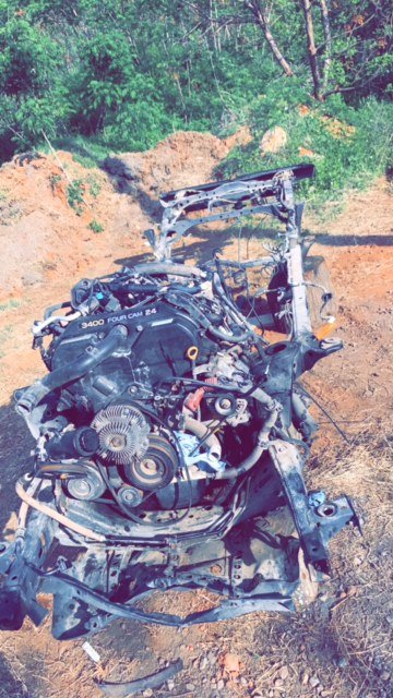

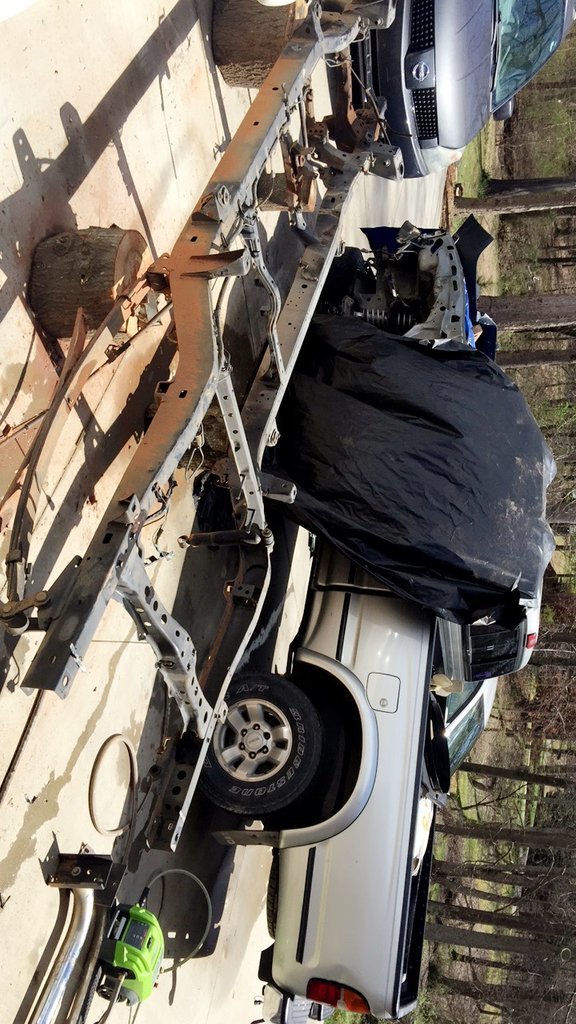

    Donor truck i found at a junk yard!! only good part was the frame!! exactly what i needed!!
    had 0 rust and was not bent anywhere. Luckily this place pulled everything off for me and got the frame ready for me to pick up. Also purchased the step rails and stabilizer bar.
    $500.00 in total!!
    Got the frame home and pressure washed her down. Grinded down some surface rust and sprayed the whole thing with bedliner and undercoating spray.

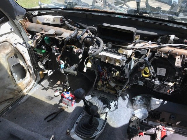

    took the whole dash apart to get things out of the way for working under where the pedals were. the accident had crunched the cab a little and would need to be hammer and pushed back out. Also, we later welded on the inside as well when we installed a new apron.
    Please comment if you need more photos! I have a bunch of photos of connectors!

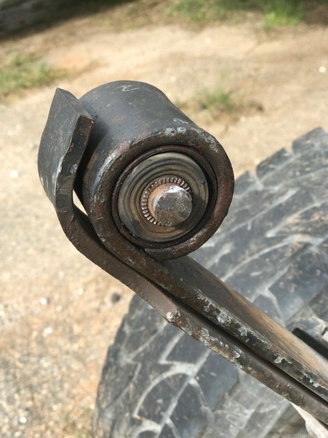

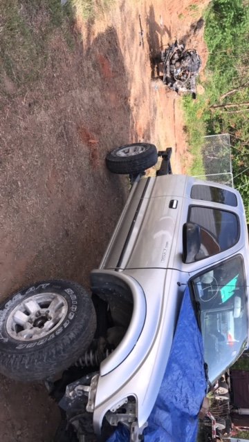

    These leafspring bushings were the biggest PITA!! I swear. I bought new poly bushings and when I had the truck already rolled into the shop, I used a drill to tear the crap out of them and then sawsall to cut the rest away. Then, the thin metal casing around needed to be cut in 2 spots to break it loose, and sledge/chisel it out! It needed to be beat out!! heat it up and spray with WD40 to break it loose!
    I got the suspension on so that i could have a rolling frame to get it onto the pulling frame in the shop. This took all day because the control arm bolts are not coming off easy!! and when you still have the motor in.. every little space is tight!! the leaf springs aren't even barely attached here.. It was not easy to push the back diff/ axles into the spots to secure them! the thing is heavy!!

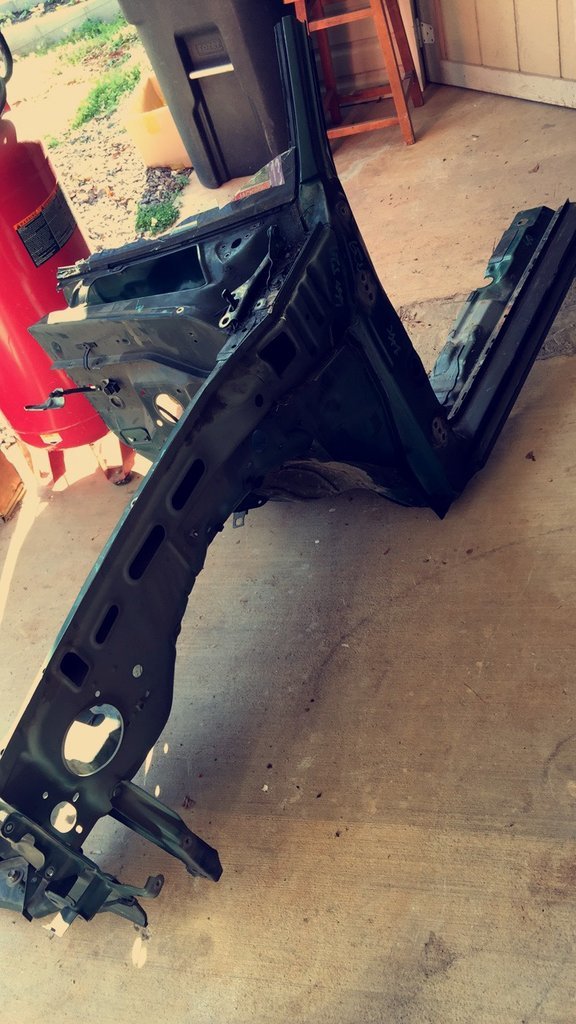

    I cut this out of another LKQ pickup. had to do way to much work to get this out!! but took me 3-4 hours and was really cheap!
    I needed the rocker panel and apron as you can see.
    $95

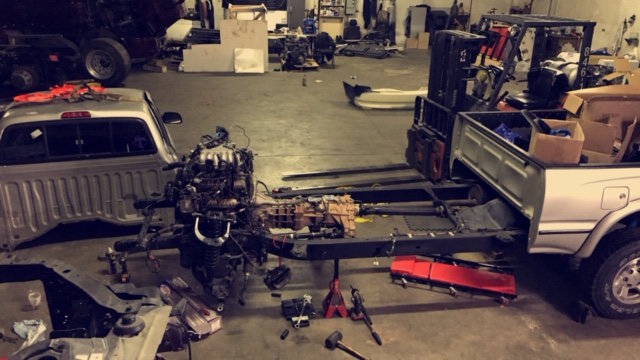

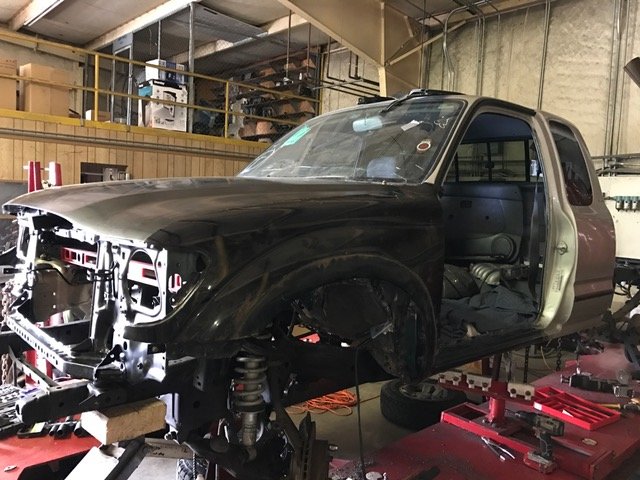

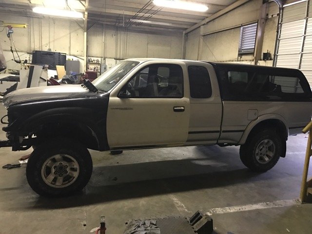

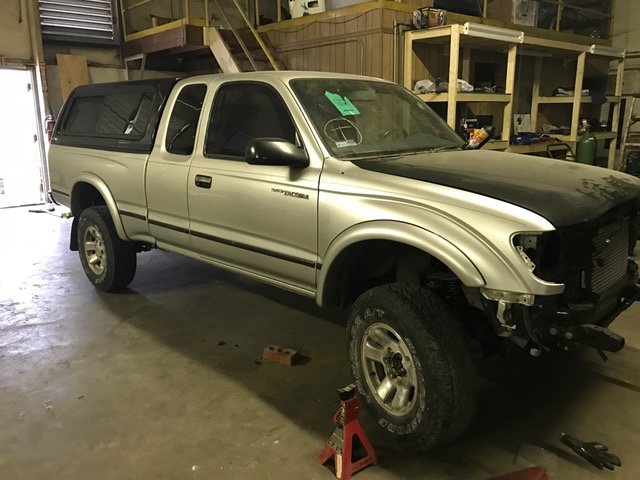

    Finally got it onto the frame. My buddy owns a shop, so all it costed me was an IOU. I wish I had some more photos of how we had the tower connected but this is how it looked when we had first pulled the apron with the frame machine, and also pulled the rocker panel and spot drilled everywhere and then slapped the doner parts, welded at the spot welds and put the hood, fenders and door on to make sure gaps and measurements were on the dot. A job like this would be way too costly for the average Joe. I made sure to do the welding myself to get a little connection with this baby.
    When i went to put the engine in, i pulled the cab off completely with a fork lift. It is only attached with 4 bolts. I hadn'd welded the radiator support yet just so that I could work easier when putting wiring back.
    The actual bracket that holds the engine mount to the engine was actually bent!! the mount was 3 inches off!! We went and bought a vise from Lowes, used the shop owners torch the heat it red hot and beat on it for a whole day just to get it perfectly lined up! Not something I could read about on the internet, but seriously..the accident didn't bust the rubber in the mount at all! but instead the bracket which as like half inch steel was bent to crap!! This part i couldn't find on Ebay or Amazon, so i decided to fix the original. I can post more photos of the bracket whoever wants to see.
    When i finally mounted the motor/transmission all together, i attached the drive shafts and made sure my bolts were tight.

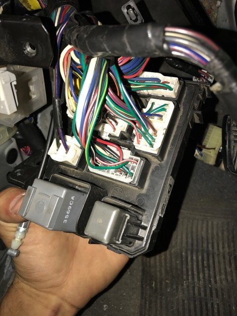

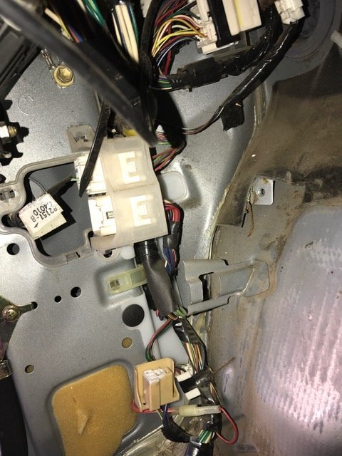

    This computer on the left side of your left foot on the driver side... was the problem when i went to start the truck! my starter would crank and try to turn the motor but it just wouldn't have spark! Plus wierd things were happening like, when i would press the emergency lights, my check engine light would come on. So, my friend told me it was a swapped connector somewhere for sure! I had all these connectors pulled out because I took the fuse box out so we could work on the apron easier.
    Luckily i had taken photos before taking it apart, so when i went to look at photos, i noticed the bottom right connectors were wrong!! how in the world do these connectors both fit in the plugs?? the bottom one is a grey tint and the top one is a white connector. i was so pist! As soon as i swapped these two connectors, all my problems went away and the truck started right up. Guys there is just too much info to type about all the problems i ran into. I want to make it as clear as possible but dont see a point in typing so much if nobody will be doing something like this. I will post a better photo of this computer box ASAP.
    Earlier i thought it was a fuel issue (for some stupid reason) spent a whole day troubleshooting my circuit opening relay and other relays. finally loosened up the bed to get to the tank, and see if my pump was working..and it was! WASTED a whole day! Good experience though.
    This is where that computer box was sitting. This was a photo i had taken after taking fuse box out.

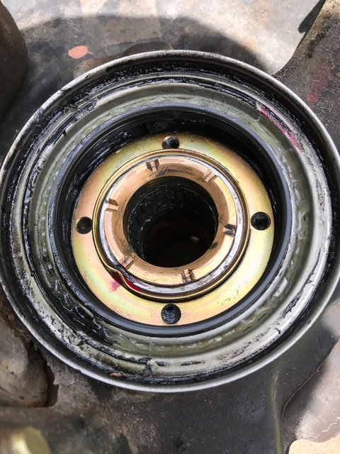

    I barely found info about this on TW!! so this manual locking hub has a locking nut on the back of it. You need a SST (specialty service tool) that the master tech at Toyota acutally tells me is garbage because it breaks easily! this nut has like 210 FT-lbs of torque on it.. so good luck.
    Master tech told me to use an air hammer with a pointed chisel to break it loose. Before you start that though, make sure you bend out that indented part, that is to make sure this nut does not come loose, otherwise, your hub bearing will be destroyed. Also, air hammer it back on. the only way to do it. I have more info about pressing these hubs out. This is the max number of photos i could post right now.

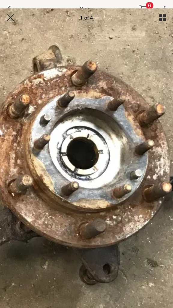

    drove her home today yall! Still not done putting front end together.

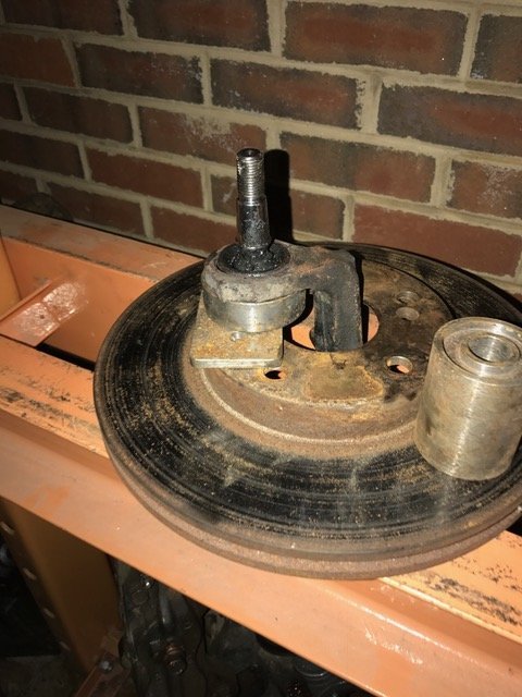

    I guess when I was pressing in my hub, I ruined my bearing because now its making a strange humming noise.
    What do y'all suggest?
    OEM toyota bearing
    OR
    I have another spindle with timkin bearings still inside, but unaware of how many miles that parts truck had. Maybe i could press those out and press them back into my spindle.
    Interested in your opinions.

    I drove her home today and noticed a sound coming from my wheel hub. I already knew i might have busted that bearing when pressing my hub in.
    should i get a Toyota OEM bearing, or use the bearings out of my parts spindle w unknown miles on it! Its a Timken bearing..which i know last a whole while!

    Only you know what the bearing feels like once you have it out.
    Timken once was a good bearing manufacture have they been forced to outsource to third world countries

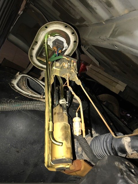

    This pic is what was swapped on that computer box. These 2 connectors were swapped.
    FYI for whoever might be doing some kind of frame swap soon

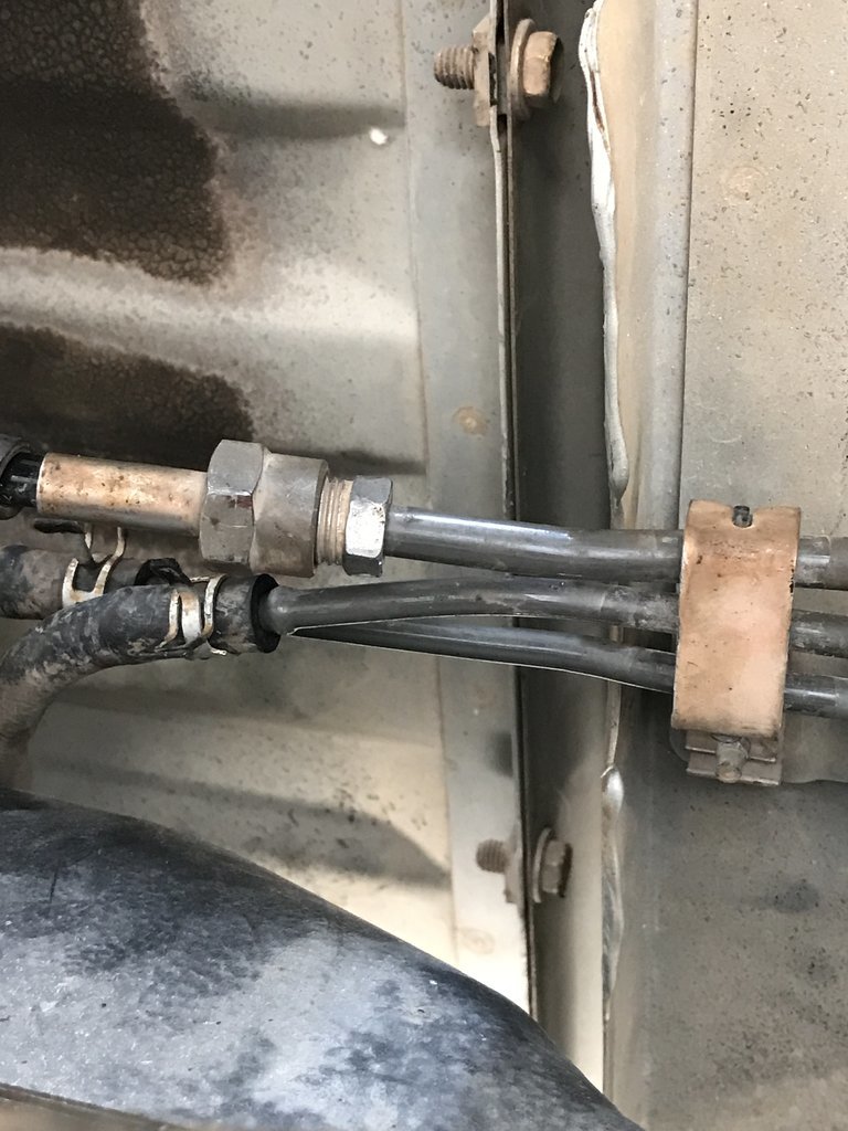

    2nd photo is the lines coming from the gas tank. The top line is your supply, middle is your return and bottom is evap line for charcoal canister.
    I had the 2 clamp on hoses swapped and this was putting fuel into my canister! Like a bunch of fuel! It'd leak nonstop out of the canister, which was obvious something was wrong.
    No clue how, why, but it did that.
    Maybe someone on here could explain.
