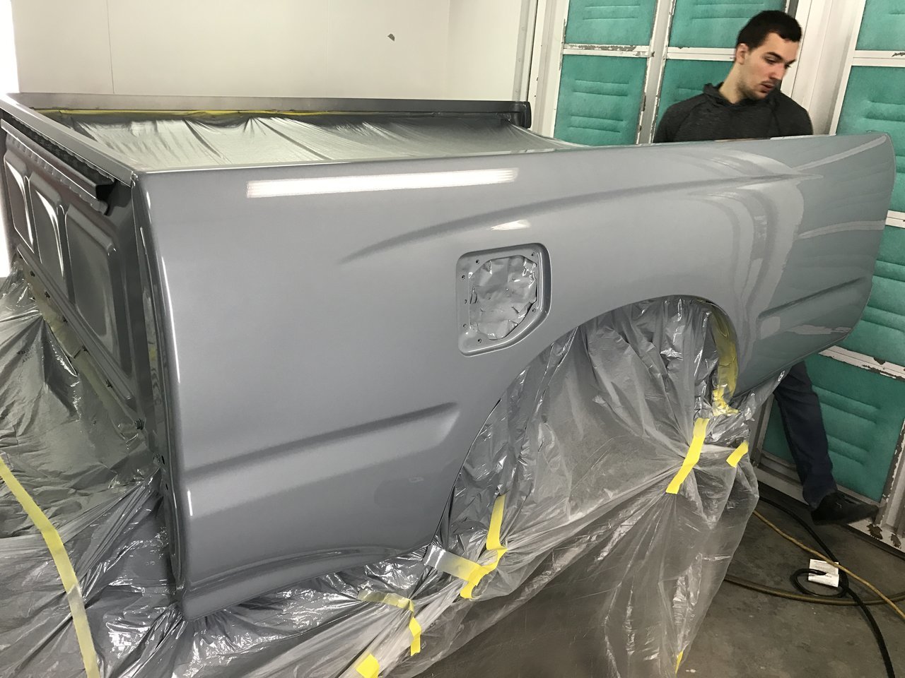

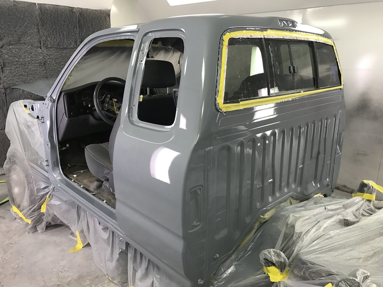

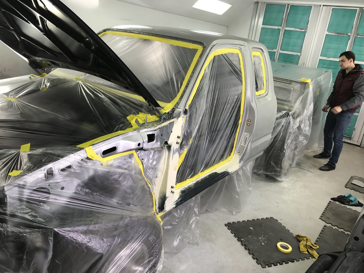

    Finally in the paint booth. Going to post some photos when it's done. November 25th has passed but it's okay, December 25 is next

    Hey y'all! I appreciate the posts and comments! I figured out the hub issue a while ago. Sorry didn't post anything about it because I thought taco world lost interest. I bought one used for $180 with shipping. The bearing was bad in that one so I got it pressed out and installed a new one!!
    Make sure to take the snap ring off before pressing! The fricken machine shop I took it to couldn't take it out with an 80 ton! Lol.
    This color is the 2016 tacoma grey. I'll post the color code later when my painter lets me know lol.

    Can't exactly tell the color, looks like wet primer.
    Cement?

    So far, material and booth renting about $500. The paint itself was like $250 for a gallon.
    Yes, at first I really was upset at how it looked bc it does look like wet primer but up close it has Metallics in it. Will post a photo of that up close.
