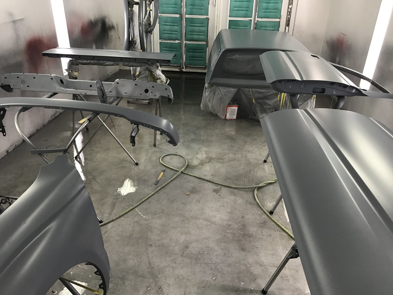

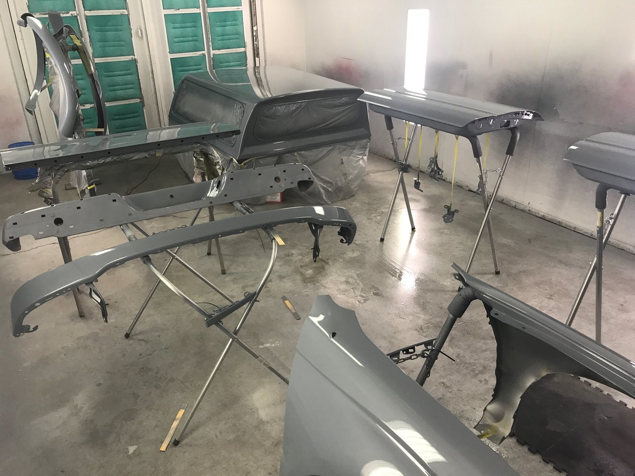

    Got all my parts painted and cleared last night. It was cold! Like 45 degrees out but my kerosene heater did a fine job of keeping the place warm enough. Had to buy more clearcoat+activator $150
    1. Prepping took 4-5 hours
    2. Painting 4 hours
    3. Clear about 1
    4. Bake for 2 hours at 90-100 degrees with heater

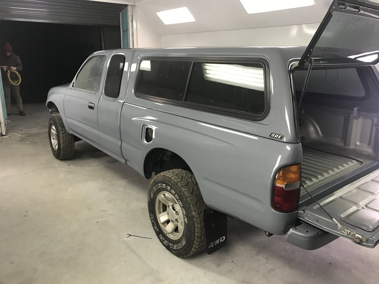

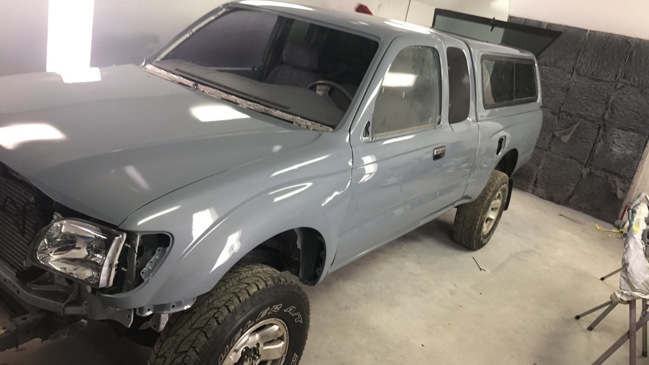

    Alright! My brother and I got the doors fenders, canopy, and tailgate on to drive her home. No windshield yet but getting that installed today. Thankfully I didn't have to drive far to get home.
    I still need to take the canopy off and install the plastic bed cover and tailgate cover so don't think we forgot to take the 3m tape off the bottom of the canopy. A seal goes there anyway. But, I do still have some work to get this thing on the road!
    BTW, this color is so strange! In the photos it looks like a nice grey color but in person it looks closer to a light bluish tint. I didn't expect that but hoping it will look more like what the photos show in the sun.

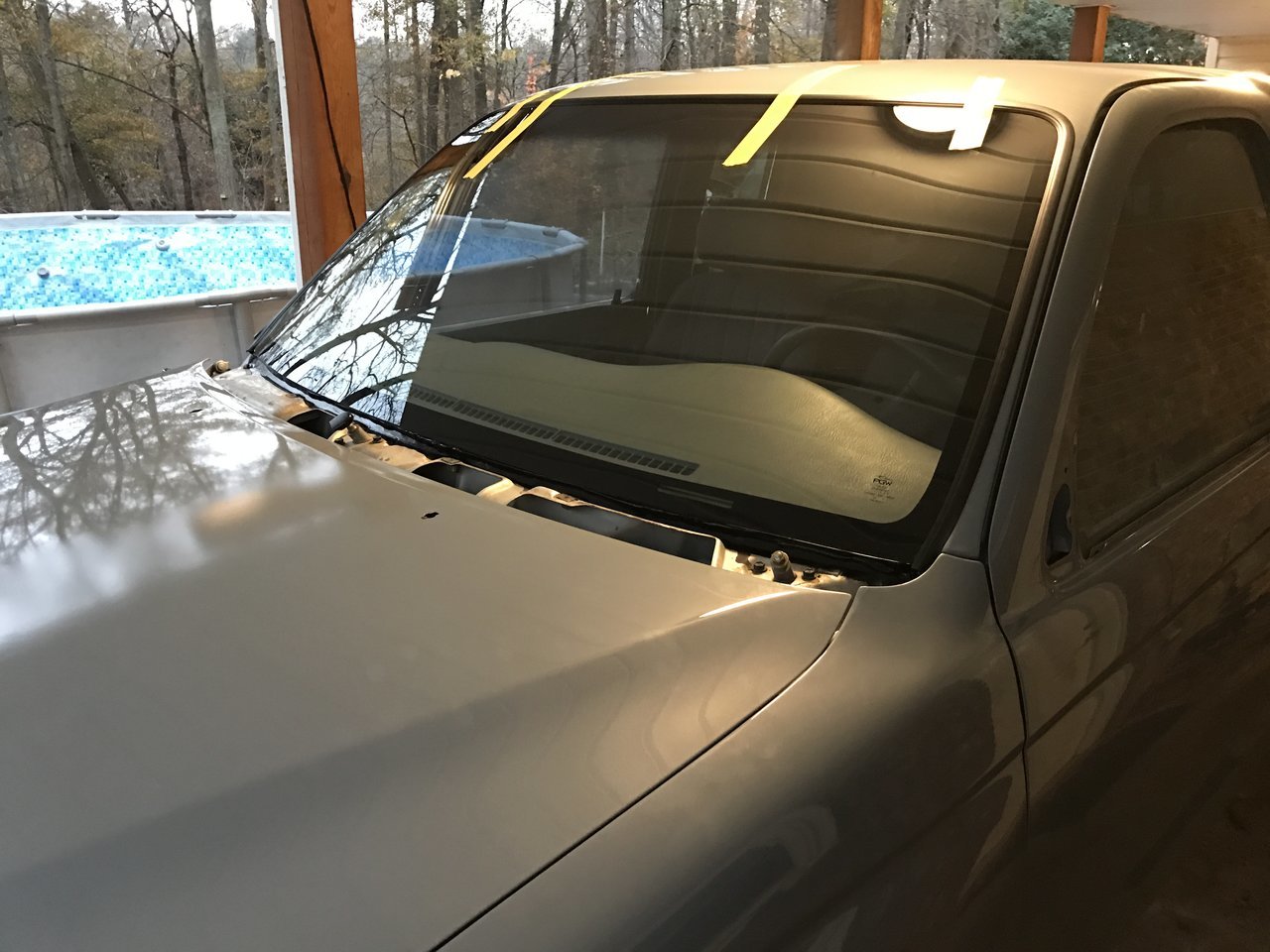

    Windshield is in! $170 for removal, install and new seal around it.
