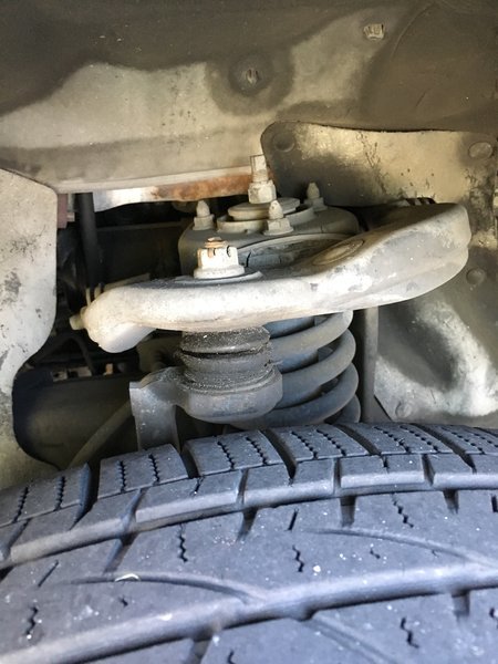

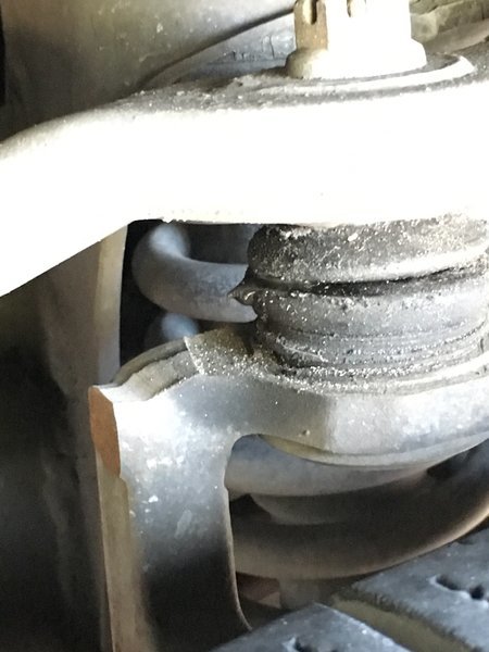

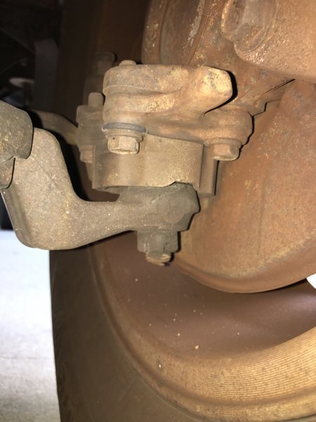

    Does anybody know about this lower ball joint on the drive side it has no nuts or bolt heads to undo it from the knuckle or lower control arm? Looks like its riveted in and also worried about the torn upper ball joint boot scared it will fail soon without notice

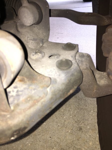

    You can see the ripped boot and the grease is getting out

    I could be wrong but pictures 1,2 are not the ball joint. Picture 3 is and it is bolted on.

    Those riveted parts are not part of the ball joint. They are permanently attached to the AArm. I've never seen them loosen up and I'm willing to bet no one else has either.

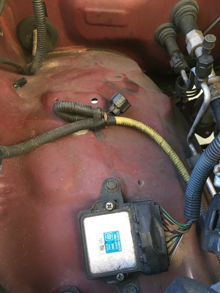

    Also does anyone know what this yellow wire is for? Mine is a base sr5 model so no cruise control or abs and the condition of the front belts

    What is a "AArm"? Sorry I'm a noob

    Crash sensor. Feeds data to the SRS ECU.
    Do you have an air bag light lot on the dash?

    Sorry.
    Lower control arm.

    Yes I do have the airbag light on all the time since I bought the truck Someone said it's a clock spring problem and also the low washer fluid light on all the time to even though long ago I took it out and cleaned the tank and sensor don't know what's wrong and yes the seatbelt plug under seat is connected

    In all cars, the only system that uses that color for wire covers, is the air bag system. The previous owner must have removed the sensor to compare it to a new one. You won't get rid of the air bag dash light until all the sensors are in place.
    You might have to hunt some junk yards or buy a new sensor.
