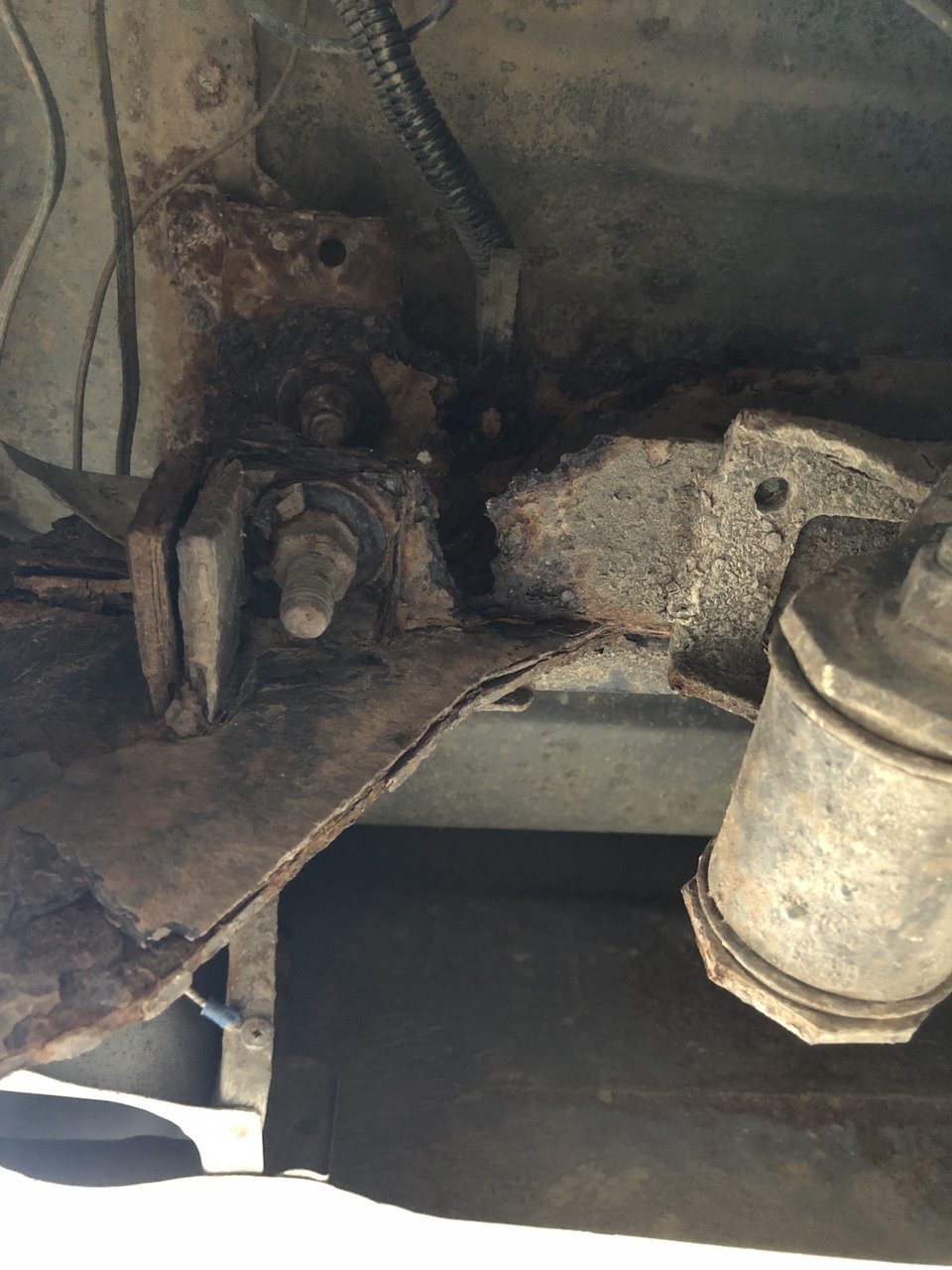

    My entire frame looked pretty good except right behind the leaf springs on the drivers side in the unboxed area where the bumper and hitch mount up. I will post a picture of the hole that failed my inspection. 6D832BF8-3B5D-4112-A00E-556ACD6F3378.jpg
