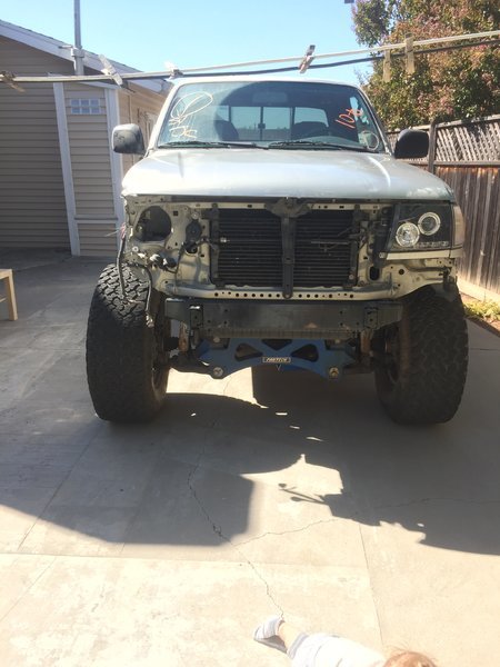

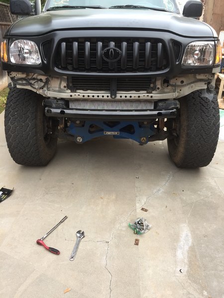

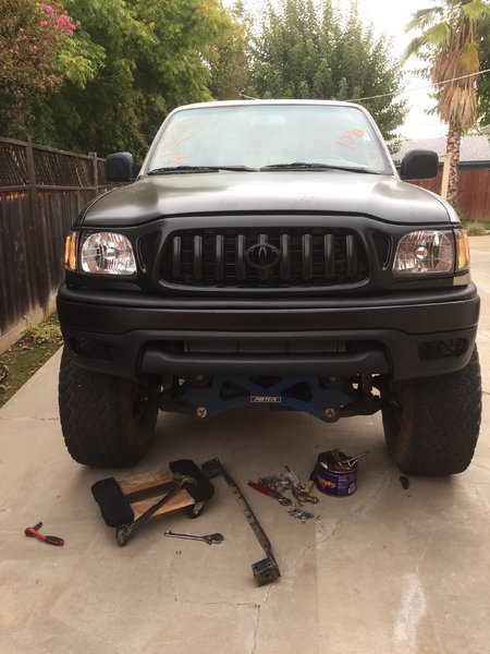

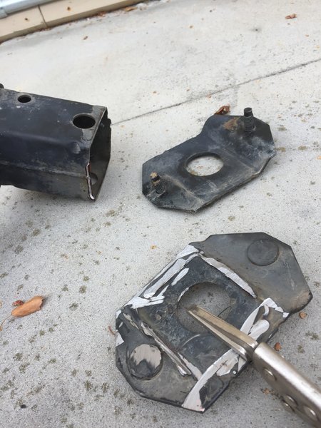

    IMG_6763.jpg IMG_6812.jpg Hey guys in new to this forum but I figured I'd share my new project . I picked up a 2000 Tacoma extended cab 4x4 with minor front end damage so I decided to go with the 01-04 front end .

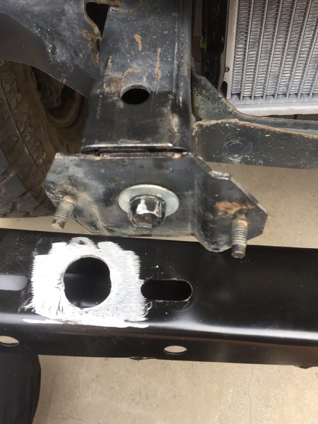

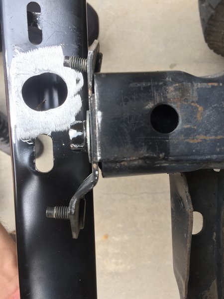

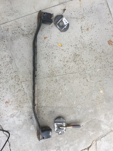

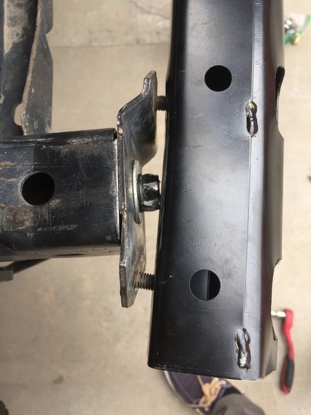

    The issue some have with this conversion is the front bumper placement . I'm sure there are some other ways to mount the 01-04 rebar to the frame but this is how I did mines .
    Take the 01-04 rebar bracket and cut off the mounts. And bolt them to the frame of your 95-00 tacomas . "See photos . Welding is not required.

    Yea I got a killer deal on this . It was just the fender and headlight damaged on this one and a small dent on the hood. The swap is easy . With all the parts it takes about 2-3 hours to put together
