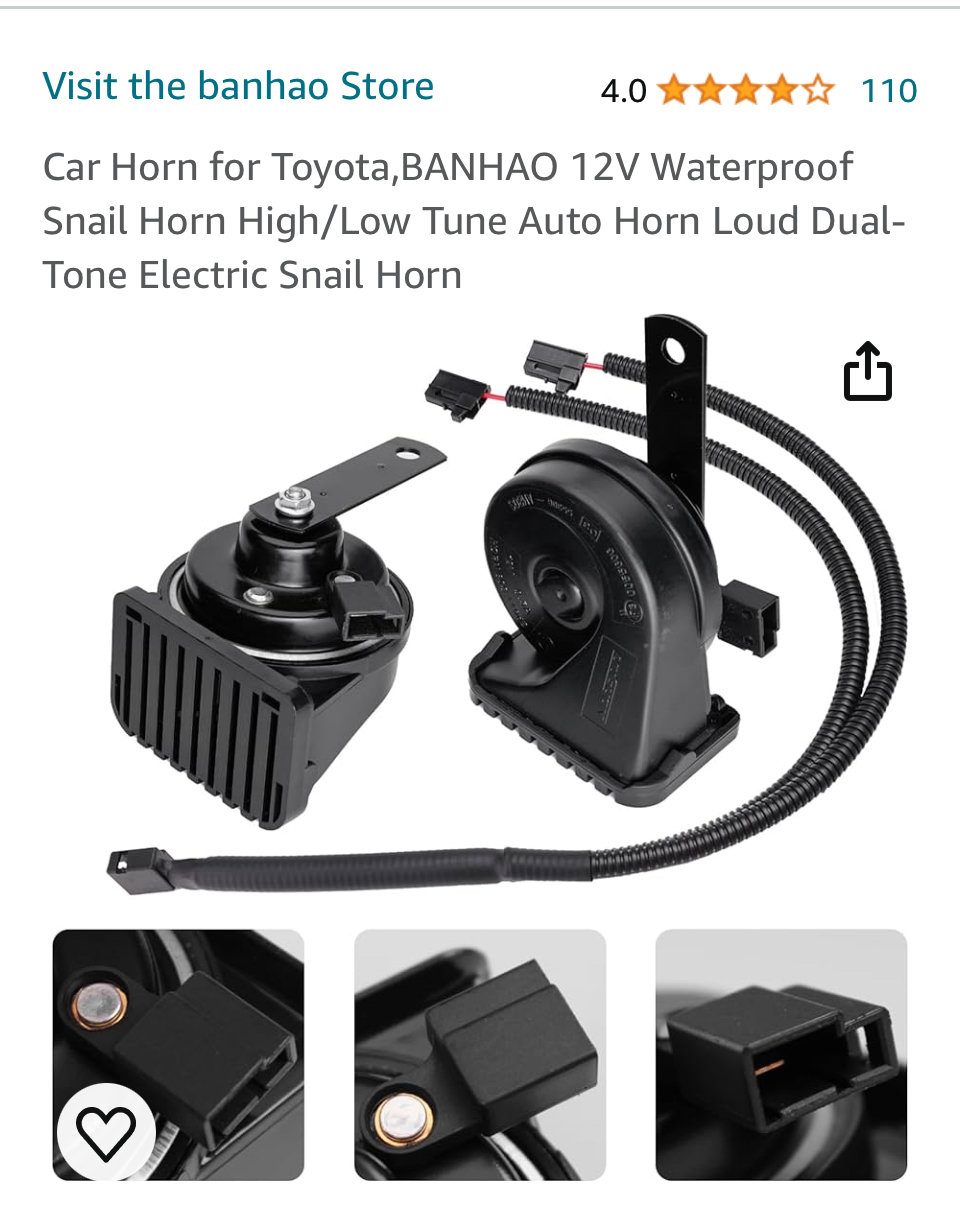

    Hey I’m having issues with power to my horn on my 1996 Tacoma. I checked the fuse it looked in good shape but replaced anyways as a just in case. I got a new horn but didn’t fix the issue. Any help would be greatly appreciated!

    This is a picture of the horn and cord that I am having issues with. Everything plugs in just fine without issue

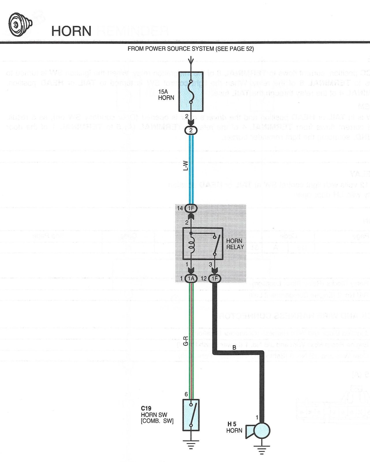

    Scan.jpg Use a VOM and check each wire for +12 volts while somebody operates the horn. I've included a diagram from the 1998 wiring manual.

    your new horns need a separate ground that is why they don`t work.
    The stock horns ground through the bolt .
    They have a two wire harness. nothing to lose give it a try.
    Either that your not getting a good ground through the hardware.
