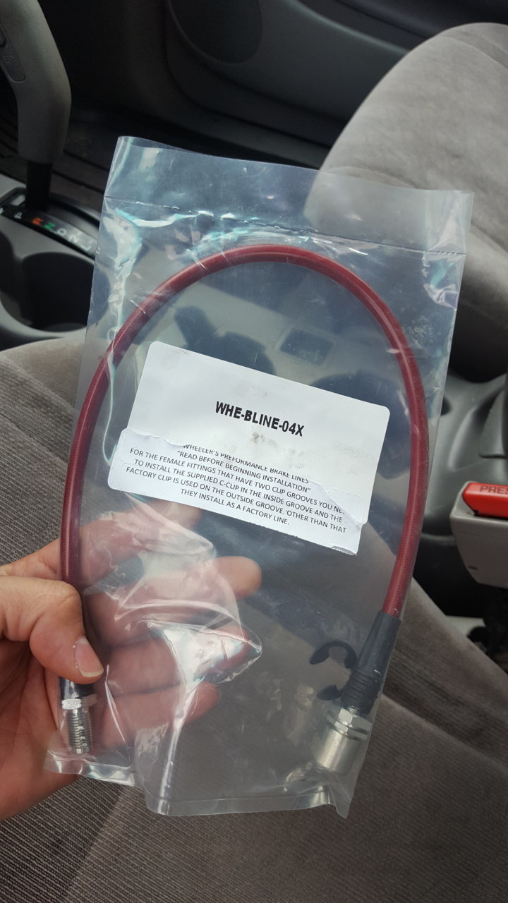

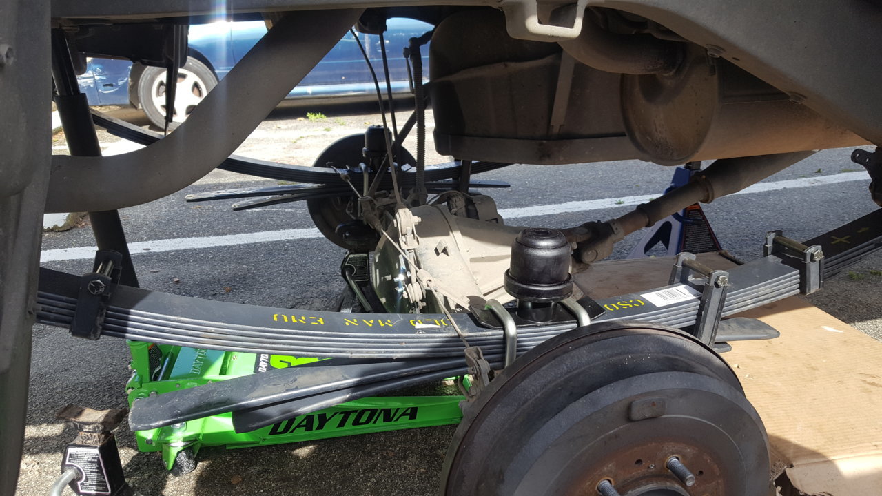

    Bringing this topic back to leaf springs;
    If you go with OME Dakar's, expect an initial 3" lift over stock. If your current springs are really bad, the lift may seem like 4" but don't worry, it'll settle within the next 1,500 miles give or take.
    Some people put weight in the back of their truck but I found this to be unnecessary.
    You also need to address the issue of the brake line, which, is too short if you plan to do any real flexing.
    One thing that I wish I had known about prior to installing my Dakar's is, you really need to replace the factory bushing that's pressed in on the front eyelet. This is the source of nearly all the squeaking that'll come from your leaf springs. Replace the set with these, get yourself a quality grease, and go to town on those bushings - I have a set but have yet to install them; one of these days once the weather dries up.
    Next you have to rectify the possible issue that you may bottom out or over extend your shocks. Extended bump stops will help to alleviate this -
    Last but not least, the last issue you'll run into is having your exhaust collide with your leaf springs. OME sells a kit that'll relocate it or just cut it off like some of us do. Here's the kit - And here's the alternative -
    I hope that answers any and all questions you may have had.

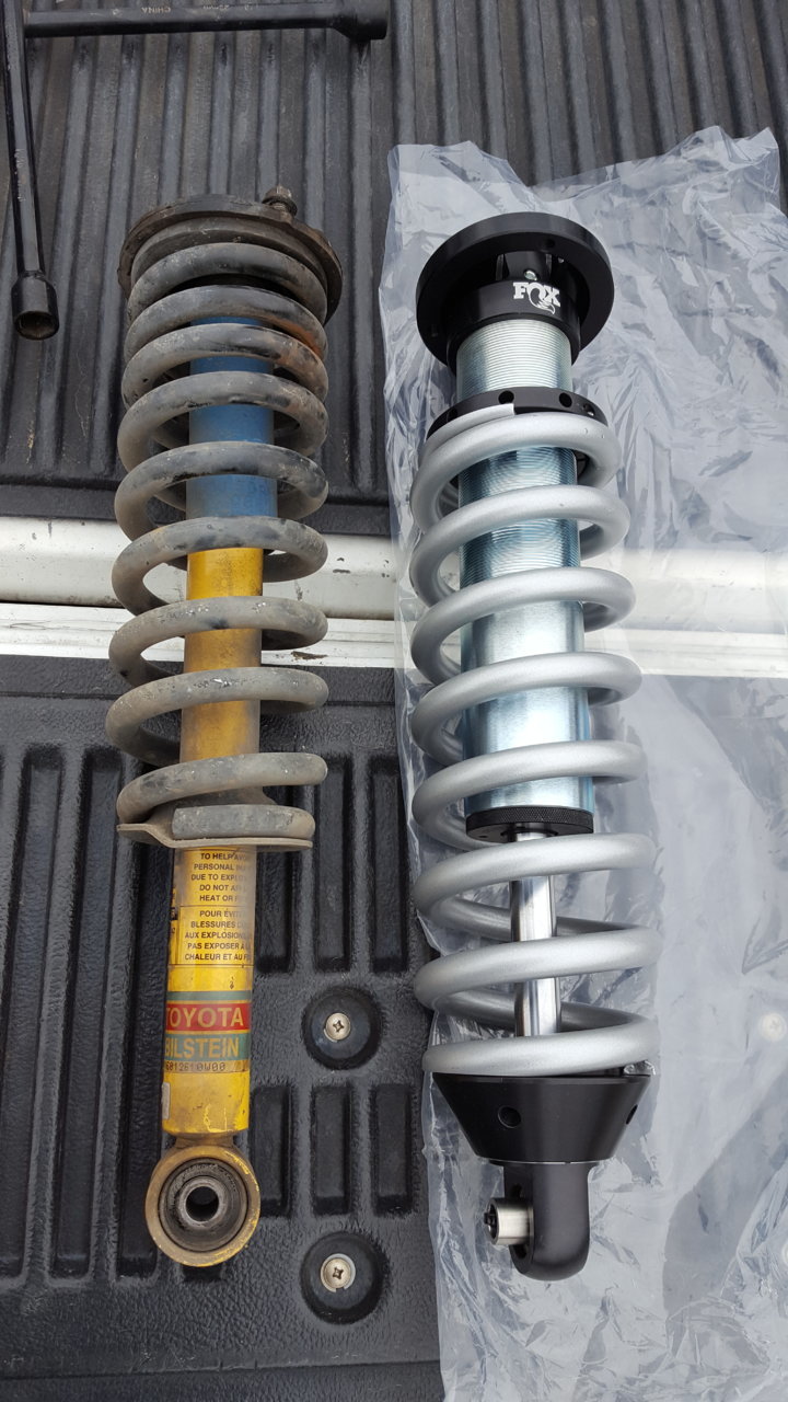

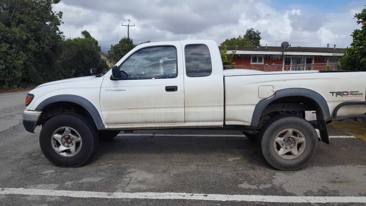

    What are you running up front? I am looking into the OME complete suspension lift kit. From the researching that I have done so far it sounds like I will be fine with the 881 springs which will give me a 2.5" lift up front and the Dakar leafs which should be 2-2.5" in the rear. The only thing that I am still confused on is how level the truck will actually be with this kit and anything else I might be missing?
  20. Apr 20, 2020 at 3:05 PM
    #20
    Kwikvette
    Feb 27, 2019
    #284735
    79,754
    Fresno County
    4 run, 2 don't
    In that picture (and now even) I run Fox 2.5 standard travel coilovers; they come with 600lb Eibach springs with factory preload set for 2" of lift.
    I had the necessary rake one would want (no stinkbug) once it was all said and done.
    Pretty sure I have an older picture showing the stance -
    I did add significant weight since then in the front, center, and back and have kept quite a bit of lift.
