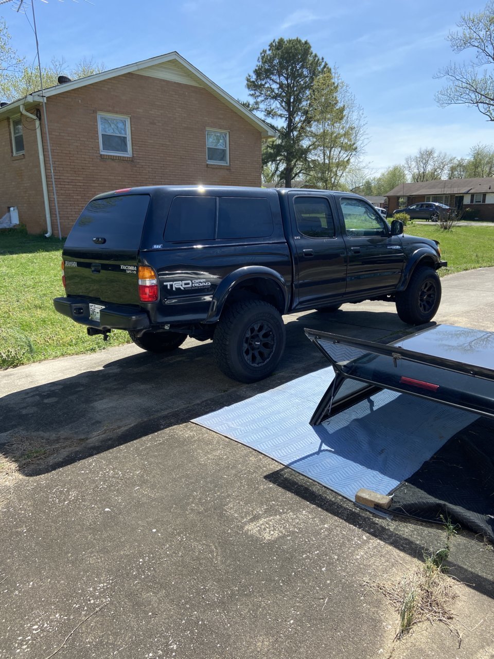

    +1 for OME here. Mines a double cab. I got 881 and OME leafs. I wanted rake and I’m happy with the stance. 508A28F5-04A0-4E14-8478-3D75FE85C32A.jpg1E548337-F9C9-468A-A987-C7A2388086DD.jpg
    2002Tacoma4x4, Hamer95USA and GregC like this.

    What size tires do you have? looks good.

    03 Tacoma (black)
    265 75 r16. Thank you, sir. This truck has been a lot of hard work since it had a drop bracket lift when I bought it( before I knew the first thing about trucks.) somewhere down the line I’d like to get steelies and 265 70 r16 but for now these tires are too new to replace considering the money I’ve sunk into this pit lol.
